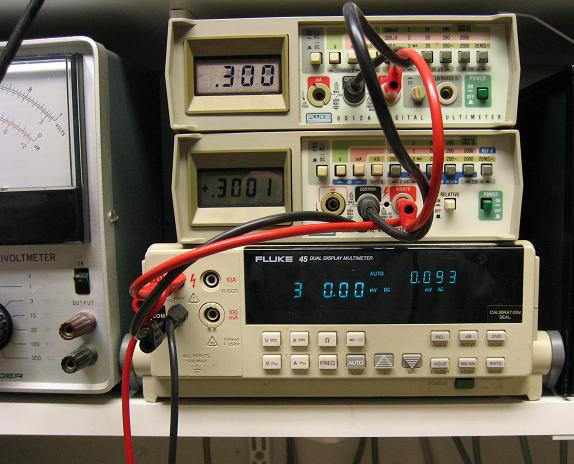

A Fluke thread :)
Here's my small collection of Fluke bench multimeters.
From the bottom and up: Fluke 45, 8050A, 8012A
I did hook them up to see how close they are, fairly good considering their age (~ 15-20 years).
No calibration has been done since new:rolleyes:
Note: In the picture one digit seems missing on the 45 due to display multiplexing.

Hi Nordic,
Nordic said:
Which Fluke models would you recommend for audio work... you know... voltages.. measuring currents, and resistors...?
I think possible fluke handheld models have been mentioned already in this thread.
A bench DMM has the benefit of taking little space once placed on a shelf and it stays put.
I like fluke 45 as it has TRMS, Dual Display, Frequency Counter and some math functions. The HP that Anatech suggested earlier seems fine to.

4fun said:
A Fluke thread :)
I'll take the bottom one please :)
