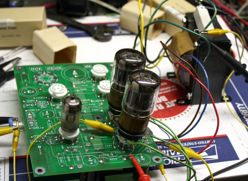

OK, I have been looking for an excuse to wire an octal socket into a Simple P-P, so I did it. I put in a pair of 26E6WG's and cranked them up. THe board was unchanged from EL84 use including 270 ohm cathode resistors for each channel. I used OPT's that are known to work well at 6.6K and 3.3K and are currently running in my red board at 125 WPC so they are not a limitation. I have a seperate power supply on the screen and the plate.
I set the dials for 300 volts plate and 150 volts screen and hit the switch. No smoke no fried parts just 18 watts at 3% distortion with a 6.6K load. Switching to 3.3K resulted in less power and more distortion. The cathode voltage was 14 volts which means 286 volts and 55 mA on the tubes. No glow no excitement, so.....
I cranked the plate up to 400 volts and left the screen at 150 volts. Power went up to 22 watts, again the 3.3K load did not work. The cathode voltage was just over 15 volts so the tube was eating 385 volts and 55 mA. no glow at full power, pale glow when drive is removed.
One more knob twist, this time a little nudge of the screen voltage, up to 170 volts. Power was 28 watts and the tube wasn't glowing at full power.
SO, don't sweat the plate voltage. I would experiment with bias VS screen voltage to find the most efficient operating point. I don't know where the screen voltage limit is, but I wouldn't push it too far with elevated plate voltage.

Fixed bias with the 26E6WG:
I dialed up 400 volts on the power supply which is 402 measured at the plate of the tube. I set the screen supply at 185, 186 measured at the tube. I set the bias for 50 mA per tube which is -22 volts on the grid. This is probably a little harder than you want to run these, but I just gotta crank em.
Distortion at 1 watt.........0.26%
Distortion at 10 watts......0.75%
Power at 5% ...............35 watts.
No glow at full power or at no power. Plate dissipation is 20 watts per tube againat a spec of 12.5 watts. There might be more in these tubes, but I am already way over plate voltage, screen voltage, and plate dissipation specs, so I think it's time to light up some 6BQ6's.
Why do I like sweep tubes? I removed the 26E6WG's, plugged in some 6BQ6's and turned the knobs. At 500 volts plate and 200 volts screen I was getting 75 watts at 5% in the same amp! I bought over 100 of these things for less than $1 each!!!!! What's not to like?
OH, if anyone is interested 12BQ6's and 25BQ6's are still on the dollar menu at ESRC in both GT and GA versions. The GA version takes far more abuse before melting.

After cranking on some 6BQ6GA's that I got for 76 cents each one developed the gassy blue glow followed by the red glow of death. I swapped it out and retested. Plate voltage 500 volts screen 175 volts tube current 50 mA grid voltage -28 volts.
Distortion at 1 watt.........0.24%
Distortion at 10 watts......0.785%
Distortion at 50 watts ......2.62%
Power at 5% ...............74 watts.
No glow at full power or at no power. Plate dissipation is 25 watts per tube againat a spec of 11 watts. Same plate structure as found in other GE 17.5 watt tubes. GA version only. The GT version has small plates.
