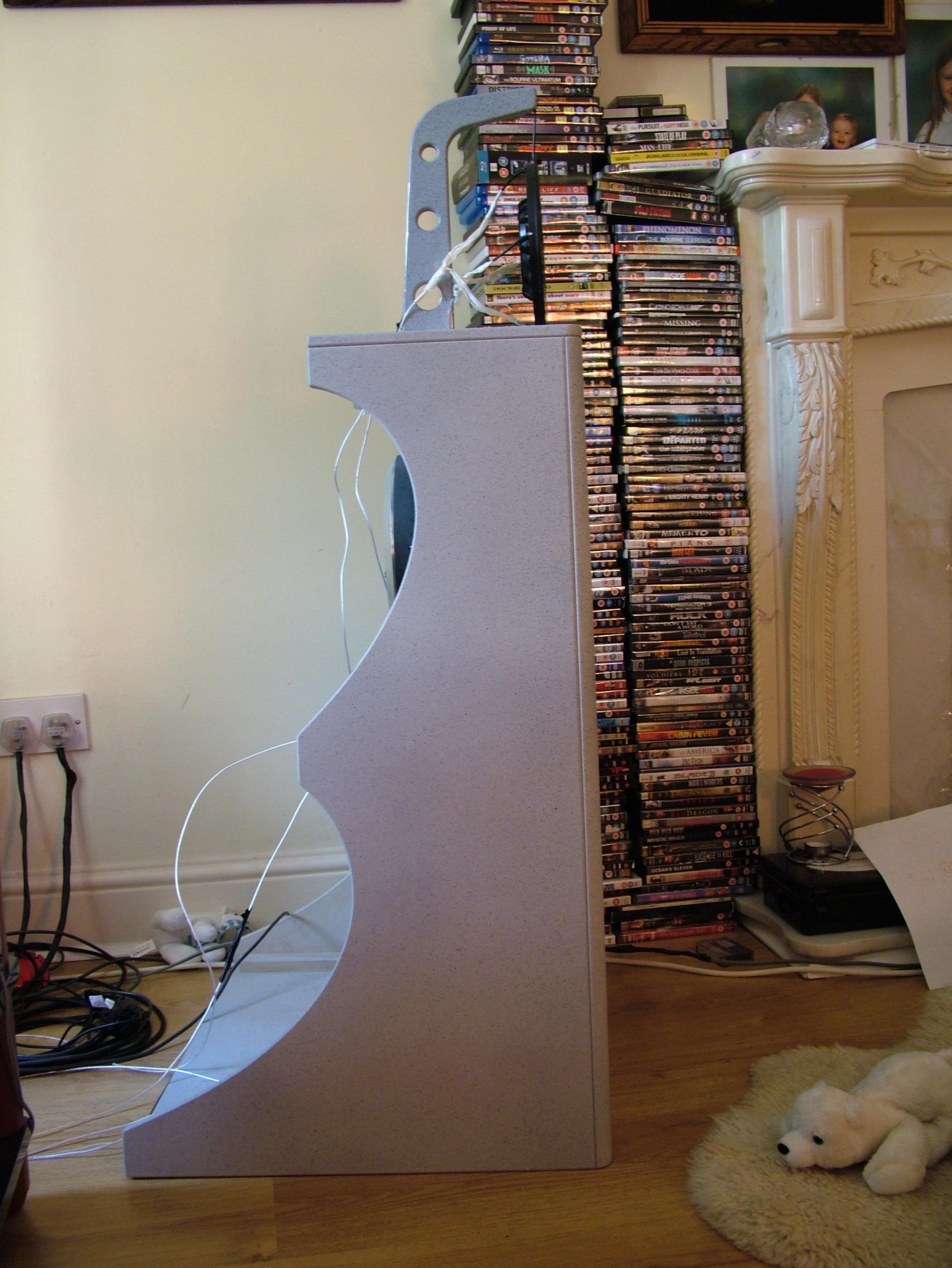

Coming back to the specific question of midrange drivers size / Mms / cut off frequency / dispersion....

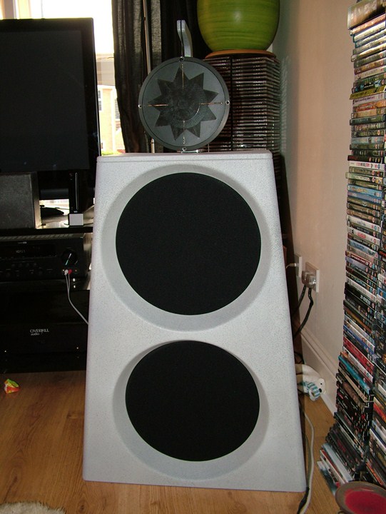

I have attached a couple of pics of an open baffle using a 15 inch Precision Devices midrange (100Hz up to 400Hz or 900Hz depending on model) with a heavier coned Beyma 15 inch covering the bass.
The Manger driver covers everything above 400Hz or any crossover point up to about 900Hz. The Manger could be easily swapped for a compression driver / horn or a full range driver.
I didn't use any horn or wave guide, just rounded baffle edges so there is no pattern control apart from the drivers natural dispersion, or in the Mangers case, lack of it!
In my experience here are a few key points relating to driver choice:
(1) Try to use the largest Sd and most efficient driver for any given bandwidth to minimise cone movement and minimise amplifier power input...I really believe this is important.
(2) Try to use the most efficient driver you can find / afford for any given bandwidth, again very important.
(3) Look at good Pro drivers which generally feature paper cones, cloth / fabric surround, lower moving mass and a higher Bl for a given Sd compared to HiFi / audiophile drivers.
(4) Rubber surround drivers are best below 150Hz (plus / minus 50 Hz depending on driver size) ...To be more specific here, even a good rubber surround driver like the Seas Excel range can be " bettered" by a good cloth surround range like PHL or Volt.
(5) Avoid driving any driver near its Fs if open baffle or Fb if in a box....Its ok to drive below Fb ( ELF principal) if the driver can handle the power and displacement required from the low end boost with Eq. Also watch the Q does not go too high...
(6) Only use passive crossovers as last resort....Active power amplification offers huge advantages over passive....99% of all high quality studio monitors and live sound loudspeakers are active...Passive crossovers are viewed as a joke...There are no successful commercial manufactures of high quality studio monitors....All our music is mixed / mastered on active monitors...Why would anyone choose passive???
(7) Take full advantage of modern DSP....DSP / crossovers / Eq offers huge advantages....Flexibility at both the design stage and the real world room / speaker interface, esp in the bass and with home cinema.

My comments on yours:
1) larger Sd is usually a good idea
2) Agreed
3) Agreed
4) Agreed, I would never use a rubber surround driver
5) this doesn't even make sense to me. Don't use near Fs? Why OK below Fs?
6) I agree that active can be made better, but that is not why everyone is doing it. they do it because it is cheaper. But the cheaper is a recent thing. Back in 2007 we built two sets of Summa one done actively and one done passively. They measured the same and sounded the same. But at that time an active box cost about $5000. Why would I or anyone else do something like that? Today with a miniDSP it costs about the same (excluding the cost of the extra amp) to do active versus passive. The actives that I do now measure just a bit better because of the high amount of flexibility that DSP offers. So while I can agree with you on this point, today, I would not have agreed just a few years back. I still sell about 50-50 active and passive. Many people don't like the extra wiring involved in active - you can't use a receiver anymore, which is why my personal speakers are still passive. Tom Danley still uses only passive crossovers in his stuff - it is not "a joke".
7) sure why not at todays low costs, unless you just don't want all those extra amps then passive is the only option.
