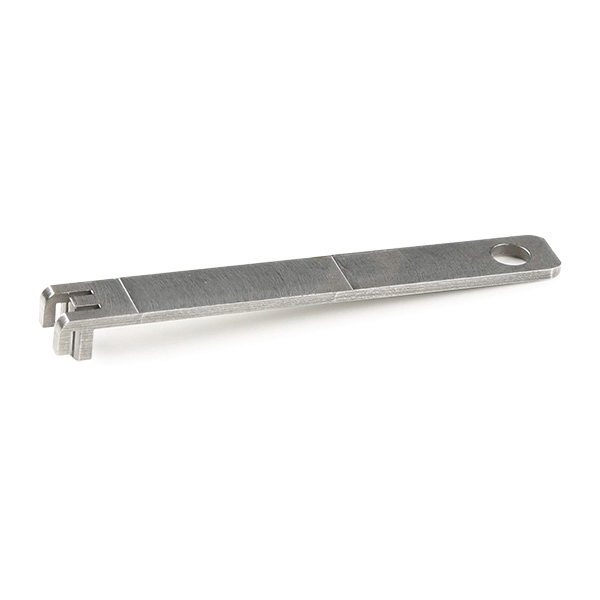

A couple of recommended tools for use with u.fl cables:
Puller tool helps extend connector life:

Sparkfun push/pull tool can help with installing connectors in tight spaces:
https://www.sparkfun.com/products/20687
