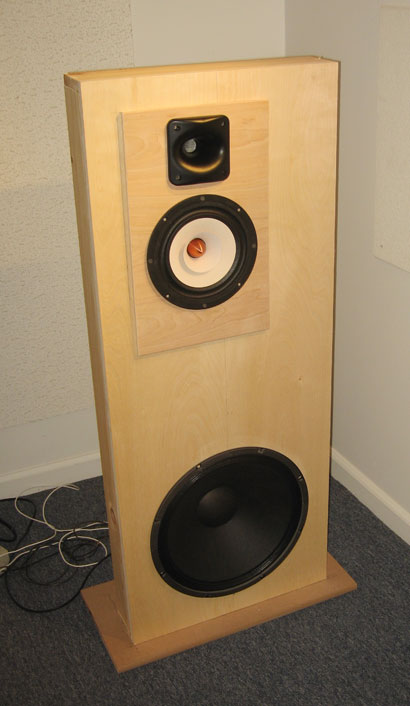

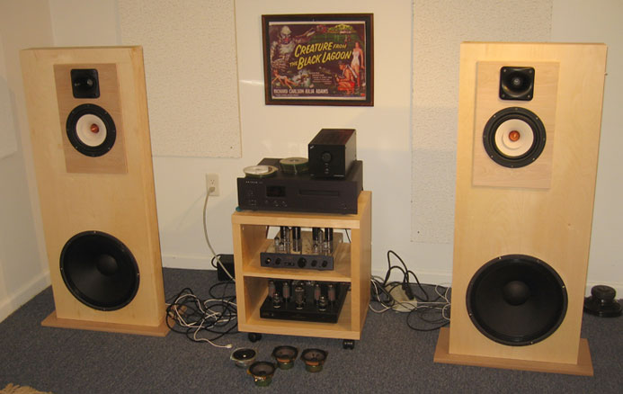

It's efficient, and excepting the cost of the mid-bass drivers, not terribly expensive. It is large though.. :eek:
I have fun listening to this system! Regardless of the drivers, as long as they satisfy you, the sound from OB makes you question the need for a cabinet. Adding additional amps offers flexibility. The Orion has some heavy electronics behind it's design along with some expensive drivers. The Dayton amp is cool bc it's built to be useful... but i would not want it powering my tweeters bc it has a grainy solid state sound that will reveal itself. For bass duty, it's good.

Boomer Open Baffle Speaker Kit
