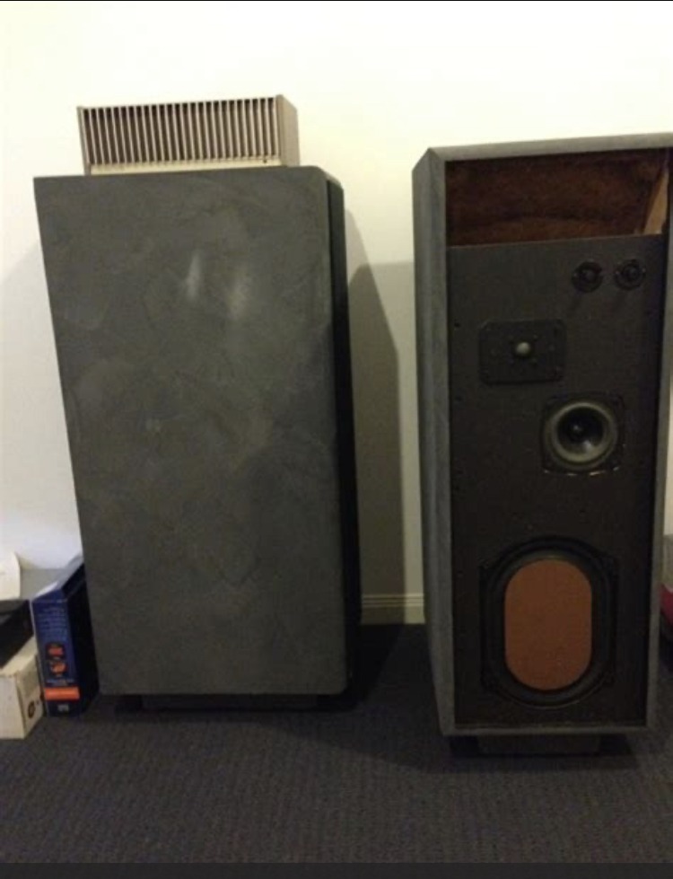

Not quite 50 years ago while a poor uni student I put together a kef concerto kit using the b139, b110 and t27 combo. My father helped me make sense of the crossover parts. A couple of years later after my cousin built a set, I bought the drivers and crossover for the Chris Roger’s pro9TL with the enclosure made from local chipboard etc. Only sold them a few years ago to pursue tube amps and smaller full range speakers, still TL.

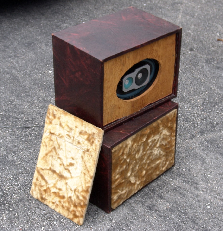

The picture on the front of the Weems book reminded me of some other "dawn of disco" era speakers that I made. What do you make when you have a bunch of plywood offcuts from a guy who re-roofed houses, some odd colored Naugahyde and Crushed Velvet from waterbed and bean-bag chair factory. You also work in an Olson Electronics store where you can get car stereo speakers cheap. I made several sets of these over a two year period from whatever material I could scrounge. They were scientifically designed to be the biggest box pair possible from a given pile of plywood. No other design criteria was used. The pair seen here were part of a set of 4 identical cabinets, but someone actually stole the pair that I would set on top of my 1965 Dodge Dart when we had parties at Dania Beach. These were found when I cleaned out my warehouse before moving north in 2014. Would they still play? I hooked them up to a guitar amp and they got to eat some of my lousy guitar playing for a few minutes at moderate volume. Failure of the blue foam surround was obvious, so I plugged in a bass guitar, dimed the volume knob and covered my driveway in blue confetti, then threw them in the trash.

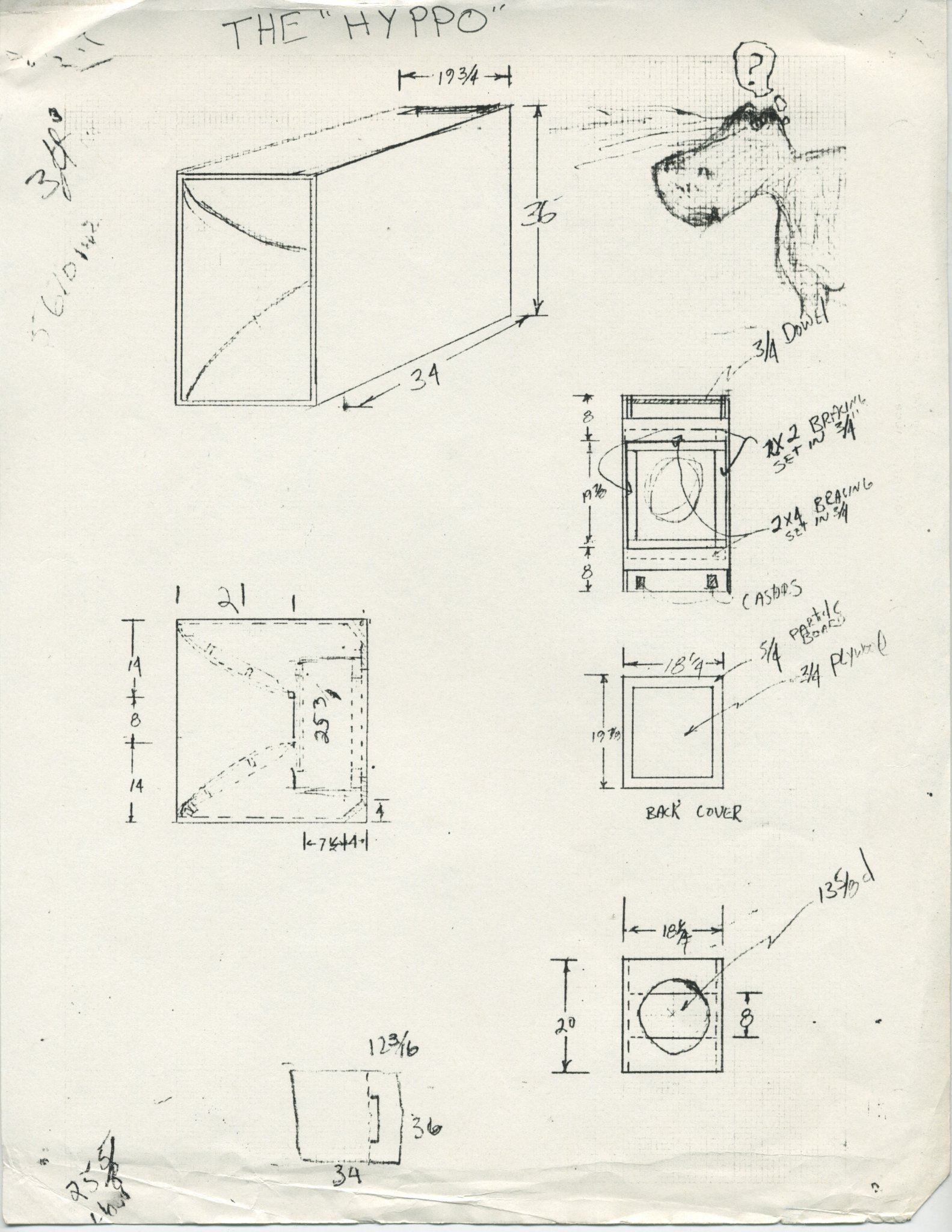

Built a lot of horn PA cabinets in high school shop 1973 and 1974.
Used Steve Hall's "Hyppo" design for many of them:
I didn't know "Hyppo" was a play on the hyperbolic/ exponential horn flare until later ;)

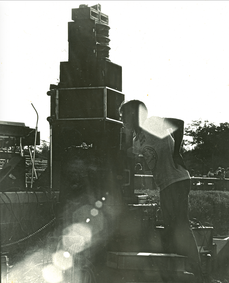

Here is a two way 1975 "line array" assembled using 18", 15" and 12" Hyppo cabinets, topped off by Recchi and EV 8HD horns, and a University H-600 with an RCA driver scavenged from under the Met Sports center bleachers (before it was replaced by the Mall of America):
