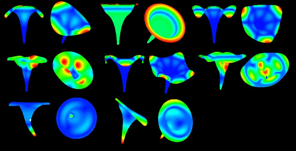

here is a FEM simulation of how strains a flimsy theorical Le Cléac'h horn:
http://www.musique-concrete.com/matP/mat15.jpg
from such studies we can obtain information on the right places along the horn's wall where we have to increase the thickness.

The picture seems to be the lower frequency modes.

Attached picture will show you more modes.
Best regards from Paris, France
Jean-Michel Le Cléac'h

Hello Soongsc,
There is probably very few or no relation between the different vibration modes of the horn walll as illustrated in the FEM simulations I show, and the way the wave propagate in the air inside the horn .
The vibration modes as illustrated are more related to solid(ian) propagation. That's means that if the coil reproduces a pulse, a part of the energy will be transmitted through the body of the compression driver then through the material constituting the horn's wall. If the horn vibrate and specially near the mouth, then there will be some intermodulation between the waves emitted by the wall and the waves propagating through the air inside the horn.
Also in the worst case, we can see on the pulse response of a driver monted on a horn a small pulse arriving before the main pulse. This is because speed of sound through most solids is something around 10 times the speed of sound.
Most often people gives a small tapp with their finger to the mouth of a given horn and say "oh! it rrings like a bell". This is faintly useful. It is far more realistic to tapp the horn near the throat.
Now imagine you vibrate the horn near its throat, the vibration will strain (= induce deformation in) the wall of the horn. This is a very small deformation. The graphs I gave show that deformation multiplied by a large factor in order to see clearly how the wall of the horn vibrate for a given mode. A horn having a very thin wall will lead to larger modal vibrations than a horn having a thick wall but the shape of the deformation will be the same.

soongsc said:
Note the location of the strong modes are probbably related with Dr. Geddes describes as sources of HOM. Is this device axisymmetric?
If the horn is vibrating at the lip, then it's acting like a direct radiator with a cone breakup mode to some degree. This I beleive is the HOM normally measured. I have not seen any data showing that HOM is created by air moving in the horn. Probably if there is data showing horn/guides of the same shape but very different structural modes that have the same HOMs, then I will be convinced.
I am fully aware how FEA software present deformation graphically. However, if the deformation is larger, it means louder ringing and longer duration. Smaller deformation due to material thickness means lower ringing and shorter duration.
Realistically, FEA search for structural modes should be done in multiple ways to gain better understanding of how the modes will change. One is having the body totally free, another is fixing it at the throat, yet another is adding the driver to the end of the throat with the whole assembly free.
Hello Soongsc,
IMHO you are mixing phenomenons which are very poorly correlated so I'll let Earl reply about the HOM relation with the vibrational modes of the horn...
Our FEM study followed the method you described but the example shown are only for a mouth which is not clamped.
