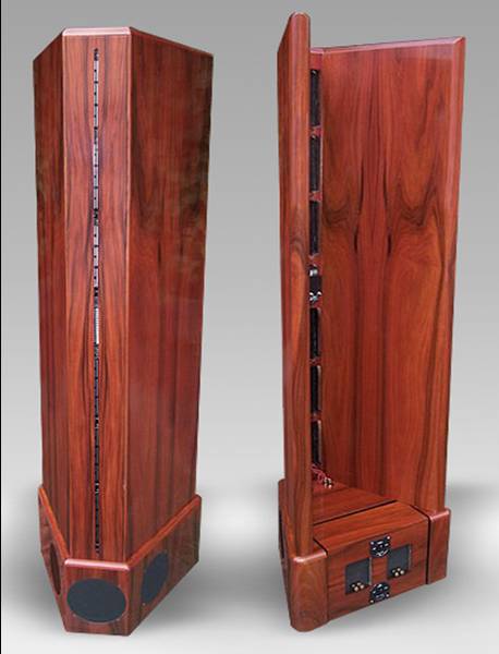

VMPS_RM_V60 information...for technical discussion purposes only
"Immediately apparent and most striking to anyone encountering the V60 for the first time, is its sculpture-like appearance, a 68” (173 cm) tall, open-baffle swept wing with an array of mid and treble planar panels standing on an integral triangular base housing its three 6.5” (16,5 cm) midbass woofers. With its slotted waveguide in place there is little to indicate this is a speaker system.
Speaking of our patent-pending waveguide, the mid/treble ribbon array is diffraction-slot loaded towards the front for 180 degree dispersion full-range, making the V60 a sit-and-enjoy anywhere reproducer.
Two distinct sounds are available: very broad dispersion with extraordinarily smooth mids and trebles (waveguide on), and a narrower, more concentrated soundfield with a very forward and tactile soundstage (waveguide off). Owners are encouraged to try it both ways and see which presentation suits them.
While the three woofers reside in a sealed enclosed (with a cutout nesting the easily-bypassed outboard passive crossover box, standard), the midrange rear wave fires into a reverse horn internally damped by a user-adjustable foam wedge, intended to kill reflections inside the horn from causing the horn-throat colorations collectively known as the Megaphone Effect. The wedge can be moved forward for quasi-sealed back operation, or rearwards away from the panels for partial or full dipole use depending on listening environment and personal preference. The rear wave path length is sufficiently long to eliminate cancellations from the Dipole Effect, a major source of nonlinearities in many open-baffle speakers. By folding its wings back the V60 achieves a front footprint of only 7” (17,5 cm) opening to a 22” (56 cm) rear.
Lowbass has been intentionally removed from the main column to cut down on surface-born modulation of the extremely low-mass (900 mg) planar mids exclusive to VMPS. Trebles are handled by the 20 mg moving-mass G3 ribbon tweeter. Sensitivity is high: 100 dB/1W/1m for the tweeter, 95 dB for the mids, and 94 dB for the woofers, allowing even small amplifiers to power the system to good levels. Output is very high (over 110 dB SPL at 3 m with a 100 W amplifier before clipping) and dynamics are explosive. The speaker fills the room with sound like few two-channel systems ever have, and is comfortable both in small or large listening rooms, close to side and back walls, or far away from them.
Accompanying the main columns is our new woofer, the Very Solid Sub (VSS) with a new high-acceleration 15” (38 cm) driver, 15” (38 cm) slot-loaded bottom passive radiator, and built-in 1000 W amp with electronic crossover and single-band parametric EQ which allows the user to notch out the floor-to-ceiling room mode (71 Hz with an 8ft ceiling). Indeed the system crossover is situated around 70 Hz to permit anyone with a good sub to eliminate this otherwise-intractable “room bloom” simply by moving the hinge frequency slightly lower. "
PICTURE OF RM_V60 WITH AND WITHOUT WAVEGUIDE

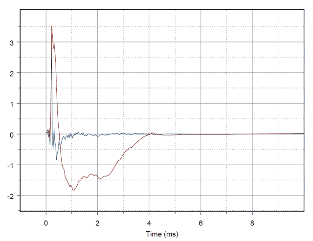

Now that I am in Bangkok, and have access to my data I will post here the actual measurements of the ESP15. These are unretouched 1/3 octave averaged responses with all the gremlins present (like the notch at about 700 Hz from the woofers rim resonance).
These are exceptional responses which have not been equaled in any of the competition that we have measured (and no I haven't measured eveything and don't intend to). The solid black line shows the ULF (Ultra Low Frequency) sub response for this system.

jzagaja said:Dear Earl,
Can you post Summa's CSD? (or provide wave/pcm file of the impulse response). Does below time domain data still valid for ESP15?
CSD is not something that I can readily do right now, its in the works.
The impulse that you show is for the Summas as taken back in the US some time ago. It is representative of current production but not exactly the same. You can see that the CSD would have a fairly steep drop since the impulse decays quite rapidly.
There is no real standard to CSD and different means yield different results. This is dangerous since it makes comparisons difficult to impossible.

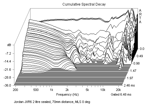

First of all I would like to compare briefly Summa with other horns. Off-axis impulses are obvious but ok. manufactures don't want or are too lazy publishing such data. With Manger it is easy because you can rent it for one month without extra cost and MSW was measured several times in many newspapers and AES papers (used in R&D). It would be fine if you can look on its CSD and tell me if you see a non terminated wave or reflections. It has beautiful brick wall even below 1kHz.
I know how microphone position affects CSD because I was practising it with my Jordan JXR6.
I don't follow your discussion here. What does "Off-axis impulses are obvious but ok." mean?

I will post a wav file of the ESP15 impulse response at 22.5 degrees as this is where it has its best response.
