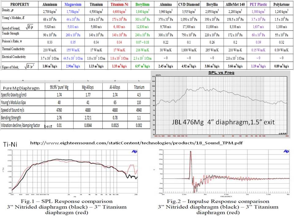

1) Beryllium
With its superior stiffness to weight ratio, unsurpassed acoustic properties, and enhanced thermal conductivity, make it the ideal material for driver diaphragms.
Hello whgeiger
Have you looked at Magnesium at all?? I have a pair of JBL 476Mg's and they measure very well. Much lower cost than the Be.

Yes!
The attached chart should answer you questions(s).
Magnesium has a slightly lower density; but it is weaker, so more of it is needed to make a stiff diaphragm.
It is not "say 10%", it is say 100%+. Typical designs using Swedish Iron deliver about 10,000 Gauss into the gap. For Permendur, 24,000 Gauss is typical.

Hello whgeiger
I love Magnesium and consume >10mg every day in my vitamins and vegetables. Beryllium.... not so much.
With modern equalization technology, high frequency diaphragm break-up seems like the main materials challenge. From materials data, Mg appears superior to Al and Ti for small domes/diaphragms.
Any other measurements of Mg compression drivers on-line?
