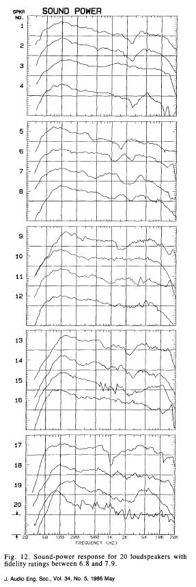

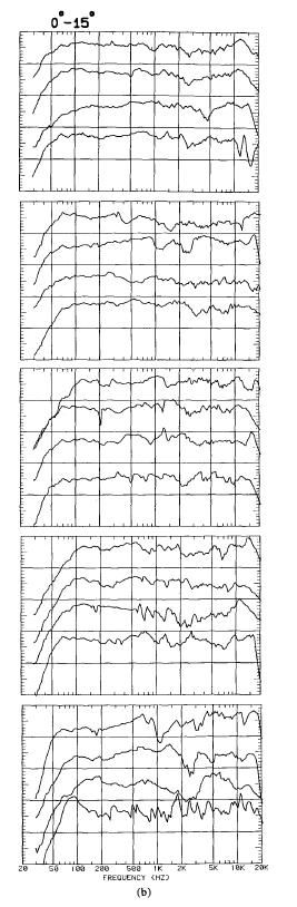

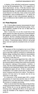

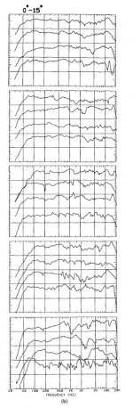

To make it easy I'll add scans of the good bits. 0-15 is the on axis listening window average. Clearly units with wide and smooth response are near the top of the list. "Power Response" is the same speakers in the same rank order but with power response shown. 1, 2, and 4 not so good (3 is nice). 10 is the nicest power response possible, but a so-so ranking. 12 is nice. 16 is very nice and 18, two from the bottom of the rankings, is also nice.

Dave - you are doing an eyeball "correlation" and I don't accept that. We already agree that the direct field is dominant, but we seem to disagree on the weight that should be put on the power response. You sometimes sound like you think that it should be zero, but that is just not supported by the data. I don't think that it is high, certainly not as high as the direct component, but it is certainly not zero.
I think that #3 contradicts your position because its direct response is not that great but its power response is and it ranks rather high. Clearly it is NOT all direct field!!
In Toole's own words: "In fact, if the fine structure were removed from these curves (power response averages) by one-third-octave or wider bandwidth filtering, it would be difficult to discern any trend whatsover in the data." That sounds to me like zero correlation.
Now you are doing eyeball correlation.
Lets agree that the link between axial response is stronger than in the power response and that there are strong counter-examples in the power response curves (well ranked speakers with poor power response and poorly ranked speakers with good power response).
