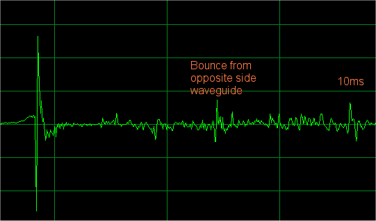

I have a curious reflection. Impulse response is not too bad for 10ms except for a reflection which I have tracked down to the opposite side waveguide. Quite ironic :(

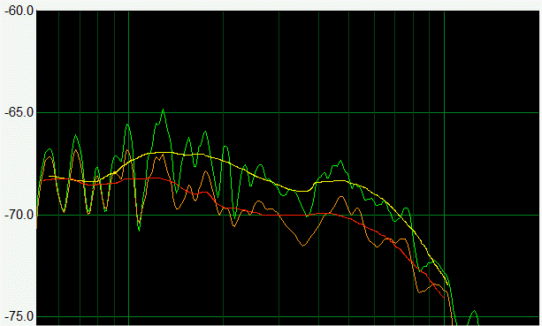

Hard to see
OS 12" with and without foam plug (Bulpren S28190). It seems foam attenuates uniformly.
While I have no reason to doubt you, it is hard to compare the differences in the figures without knowing the colour key. Could the ratio be plotted, or the figures normalised to the same peak value? (Or some other means to allow comparison of the change at >5kHz with the change at <1kHz, which you say is the same).
Ken
I should mention that one I sent wasn't perfect because I had to temporarily fix the foam in place so I used some material I had on hand. It may affect the result. When done a bit more carefully there is a very even 2 db loss up to 10k, and above that point it increases by an extra 1db, so a maximum attenuation of 3db above 10k. I found the same thing with a 6" oblate, the 12" and the 18 sound elliptical.

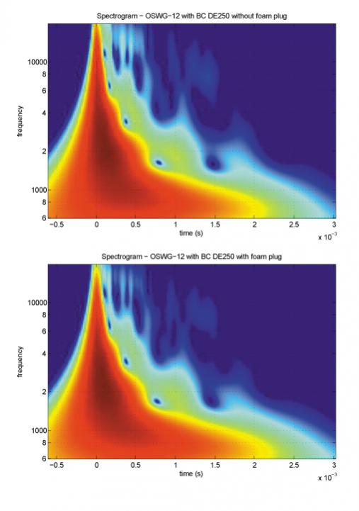

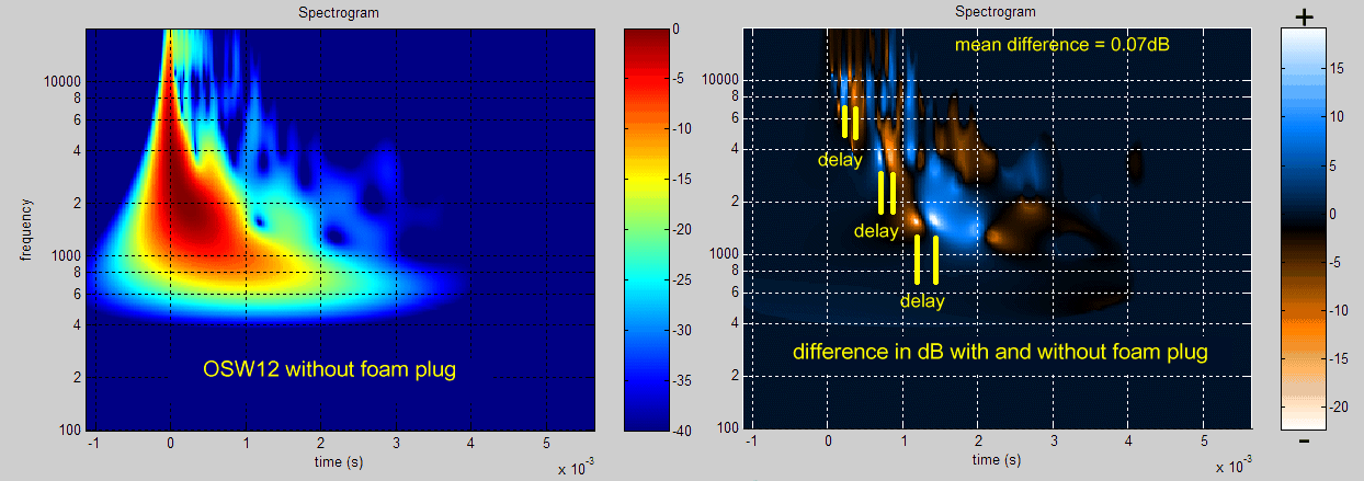

Hello,
I could derived a differential spectrogram from the impulse responses of the OSWG12 with and without foam.
(see attached)
(Note: the mean power of the response around t = 0 has been normalized to the same level for the waveguide without the foam plug and the waveguide with the foam plug.)
The blue color corresponds to the time/frequency domains for which the foam reduced some energy and the red color corresponds to the time/frequency domains for which the foam added some energy.
The white spots are the domains where the foam has the most effect.
The mean decrease of energy over all the time/frequency domain is less than 0.07dB.
Give a look to the white spots related respectively to a reduction and a rise in the level. They are grouped by 2 and inside each couple there is a delay between them.
A rapid conclusion to be improved by other analysis is that:
- the main effect of the foam plug is to delay some reflections, diffractions or HOMs inside the waveguide. Relative absorption of reflection, diffraction and HOMs versus the direct wave is negligeible.
Best regards from Paris, France
Jean-Michel Le Cléac'h

Hello,
The differences noted are due to the delay and they swamp out all else. You will see this efect in my analysis some years back. Basically this technique is incapable of detecting anything and drawing conclusions from it is rather ridiculous. .07 dB reduction!? Thats like having no foam at all. I typically see < 1 dB at 1 kHz and about 2-3 dB at 10 kHz. Thats quite a bit different. But this too could be a result of the inability of the technique to show anything related to diffraction, HOMs, or whatever.
