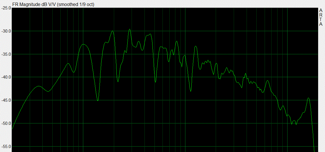

After voicing by ear, I took this from my listening position. Despite the looks, it doesn't sound bad.
Not sure if I should equalise. I dislike sibilance.

Um, I need to take that plot back and apologise. The kids were playing with the EQ before I started. Some exposure to solder fumes and a passworded screen saver later, and all's well. :(
For an "in-room" curve I found the "slope" completely reasonable. In any room, the HF response of the steady state will fall for several reasons. The power response almost invariably fall (my speakers being on the exceptional high-end of this), and the absorption always goes up at HFs. This yields an expected fall of at least 3 dB per octave for the steady state sound levels. However, my steady state measurements -spatially averaged, as they have to be - tend to be quite a bit smoother than whay you showed.
