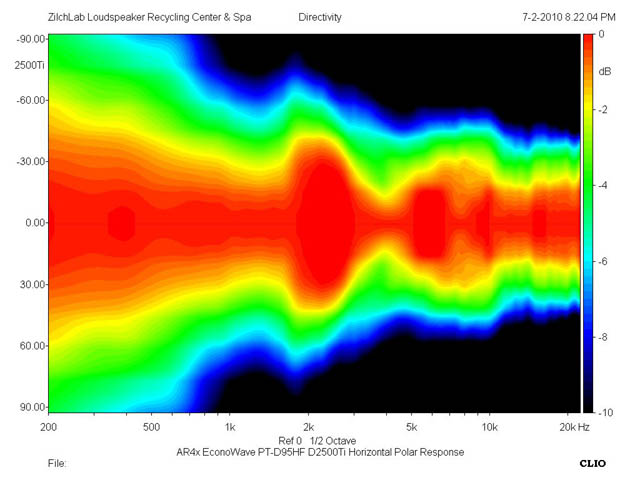

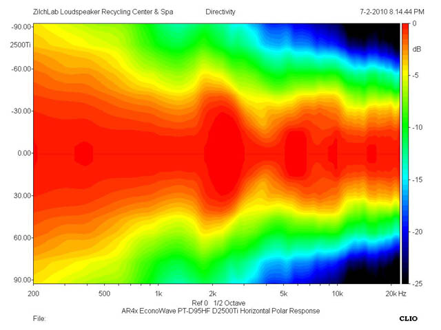

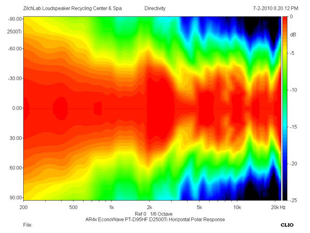

I will make one statement. The idea that normalizing a contour plot by the on axis response is a bad thing to do is nonsense. It is in fact the correct thing to do. Looking at the data for Earl's Abbey tells you why. It appears to have a very nice -6dB beam width from 2k and above. That is true if you don't care about what happens between +/- 40 degrees. On axis the response above 2K varies by as much as +/-4.75dB (3dB peak at 2.7k, 6.5dB dip at 5.8K). That's not me being critical of Earl's design. That is what he presented in his data. Earl says it's bad to normalize because the peaks and holes in the on axis response will distort the contours off axis. And let me add that the normalization by the on axis response in my case would have little effect because the on axis response is extremely flat.

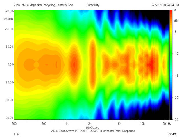

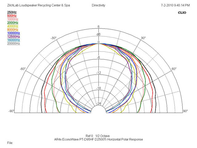

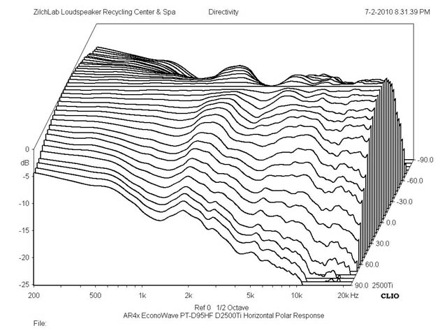

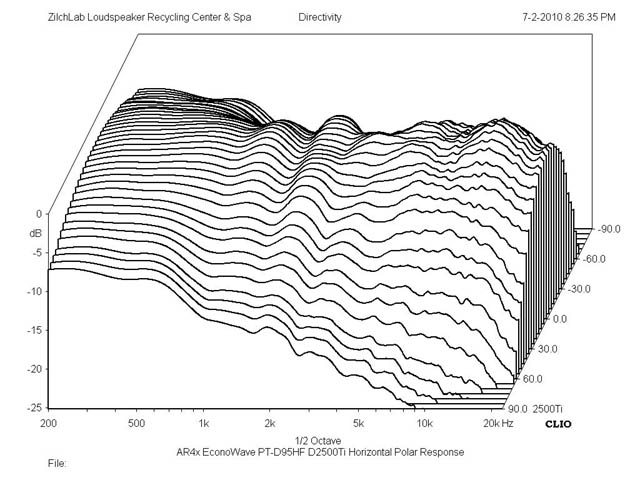

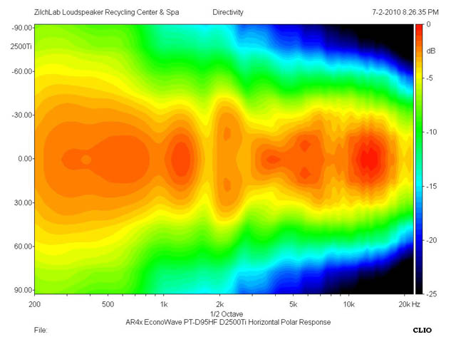

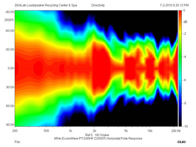

How much smoothing is actually occurring in the plots?
Here, 1/2 octave:

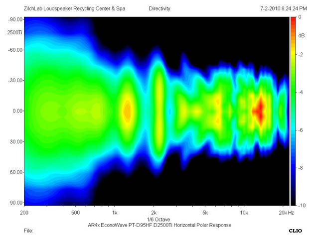

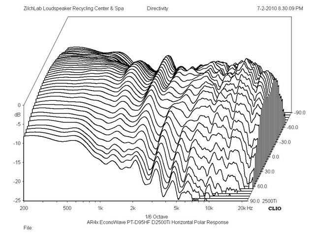

Here, same data at 1/6 octave:
Perhaps, so what if Dr Geddes was to normalise on listening axis rather than on speaker axis? Or what about normalising the power response?
At the frequency where there is a hole on axis due to the waveguide mouth termination, normalising on speaker axis only makes it look weird.
Earl chooses a protocol that shows his designs in the best light. His original directivity white paper displayed the on-axis notch in full relief. We all know it's there, we all know why it's there, and we are all well aware of his "I don't listen on axis and I don't EQ there" workaround.... :yes:
About color coding intensity in Earl's graph
Please have a look what other manufacturers are showing. In example Klein-Hummel has a very rough data by comparison. Every 3dB variation is blended in one color 'bin'.
In comparison Earl's data has 1/20oct freq. smoothing and infinitly variable color coding.
From Nathans data it is apparent that from 5000-10000Hz there is clearly visible 'depression' near 0 degree axis, judging from color appears same intensity as 40 degree data at that freq. region - how everyone misses it and accuses Geddes of 'hiding' data is beyon me.
On the other hand, making the color transitions faster in the frist couple dB would show a better picture of what happens to the sound field. As of now, ZilchLab's posted data is not comparable to Earl's posted data, because sound level intensity is represented differently - Zilch's graph has 10dB of range (red - black), while Earl's data has a whopping 35dB crammed to the red-black transition.
Asking Earl to color code his data differently is not fair either - every data point below a certain dB would be 'lost'
Maybe the most reasonable solution would be to use 20dB intensity range for color coding? ZilchLab-s data would show something beyond 50 degrees, Earls data would look more 'detailed' near the forward lobe. And most importantly, Klein-Hummel uses 20dB range for color coding polar maps :)

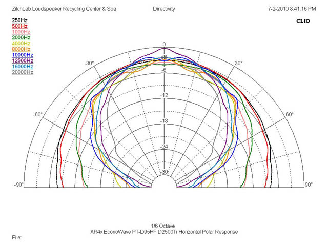

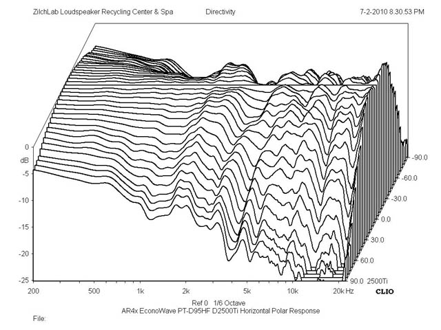

I chose that 10 dB full-scale resolution to clearly delineate the standard -6 dB partition. Here they are at 25 dB; 1, 5, 50 and 100 dB are also available in CLIO.
Smoothing options are unsmoothed, 1/12, 1/6, 1/3, and 1/2 octave. Normalization, axis, smoothing, and scaling each emphasize different features and flaws, but the bottom line is that the directivity itself as illustrated remains the same.... :)
