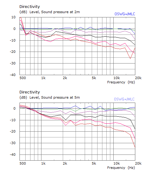

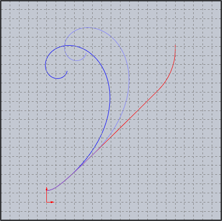

Shifting JMLC junction helps with CD above 45deg.

Nice comparisons so far !
Sure – but you immediately introduce on-axis sound field defects due to the quasi-straight contour part. It can even be seen at the relatively rough traces you show. Lowering the ratio of the quasi- conical part with respect to the whole contour, immediately improves this on-axis defect – and vice versa of course.
