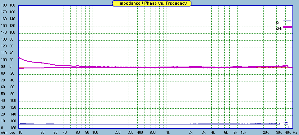

For which driver have you done that on? Something like these two?Thats not true. It may not be as easy, but its always doable. There are techniques (see my book) that can extract TS parameters without touching the device at all.

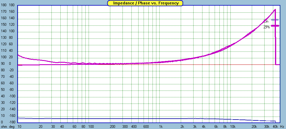

How do you get phase increaseing at high frequency while the impedance amlitude drops?????

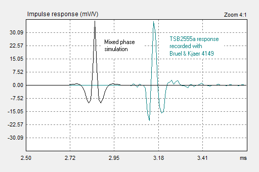

You know, those were tested on using sound cards that need pulse delay of -0.01041ms applied, and I forgot to do it. Thanks for catching that. I had proposed a long time ago to have the necessary delay applied in the "preferences" and compensated for when generating the impulse response so that the impulse files will read the same whenever you read back the saved files regadless which system the data was generated on, but that request was probably forgotten.How do you get phase increaseing at high frequency while the impedance amlitude drops?????
Here is the corrected ones.

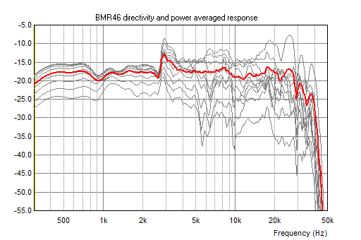

Quite interestingly, I ran across a coniguration that gave pretty good directivity probably slightly better than the last posted configuration I made, but with only a 3db slope. Same driver model I've been using....
So, if someone states that its not possible that we can have constant directivity (in the words technical meaning) *without* a 6dB slope – which is the case here – I hold against my measurements :

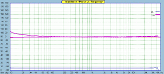

Well, that is impedance of a tweeter.
Anyway, It was quite interesting to find how much the throat design can effect acoustic impedance. I'm beginning to suspect there is an equation for fitting a shape to an acoustic impedance/frequency.
What you showed was the impedance?
There is a "relationship" even if there isn't a simple equation.
Yes, impedance.
The impedance alone is insufficient to tell much. You always need some measure of the transfer of the electrical domain to the mechanical/acoustical domain.
