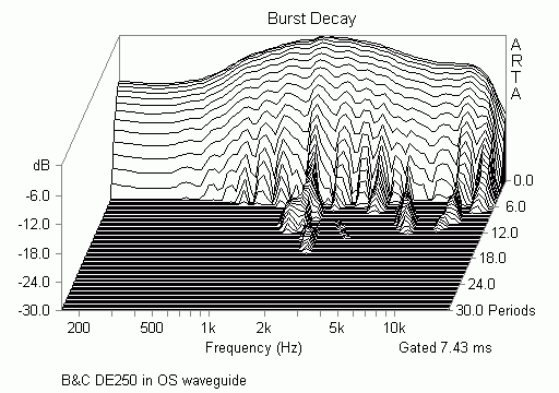

jzagaja said:Dear Earl,
You said HOMs can be seen through their group delay. In excess phase there is a peak at 2,8kHz (whole ESP15 unit) and now in DE250 itself we can see it in burst decay. Is it HOM?
Quite interesting. I am not sure what meaning a waterfall of group delay has, but it is interesting and it may be the HOM that are causing the "ringing" (if you can call it that). I'd have to think about this.
My thought was to substract out the minimum phase component and the time delay phase leaving only the non-minimum phase portion. Then through a Hilbert transform find the magnitude of this phase. Maybe thats not valid either. I have not looked into this too deeply.
