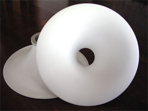

Well, I will begin with throwing in this waveguide

Jmmlc said:
Hello Soongsc,
The picture shown by Tinitus is not related to a waveguide
Jean-Michel Le Cléac'h
Its not a waveguide ?...well, what do I know :clown: but thanks fore correcting...its a true horn then, thats ok too
It just looks very nice and fits my plans fore using a 6" from 300-1200hz...and doing 100db...instead of the 12" I have had in mind 😎
