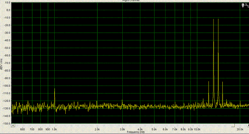

Can you show us a CCIF 19+20 kHz measurement of this?
Thanks,
Bob
Bob,
with pleasure (13+14kHz), it is about -2dB under limitation, into 8ohm:
/no averaging/

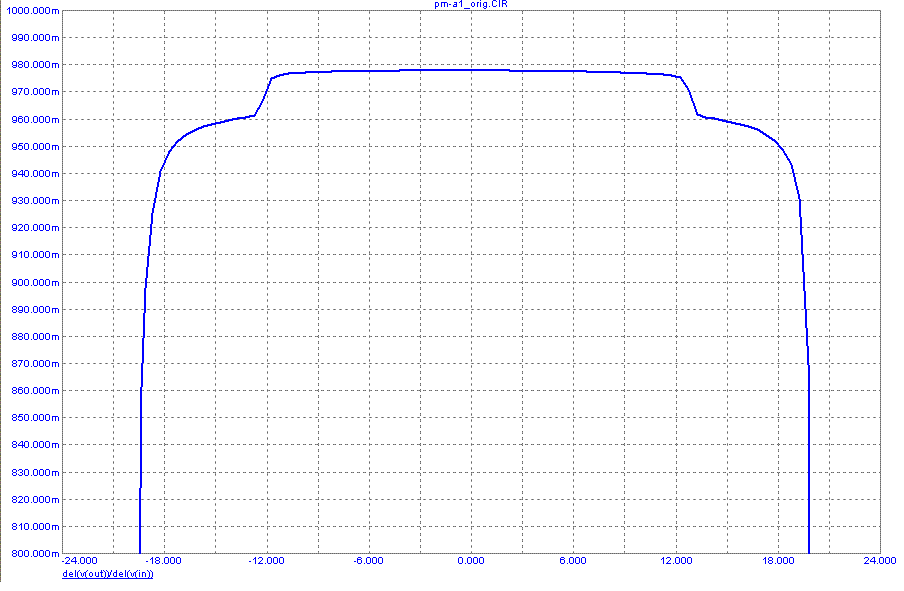

The previous image was for 8ohm load. But for 4ohm, we can see transition out of class A at some -12Vp and 12Vp. For the usual class AB low iddle current design, this would happen 1-2V from zero. Now we have inflexion points of transfer curve, source of higher harmonics. But still amp mostly works in linear portion of the transfer curve and does not annoy listeners as the low iddle current designs do.

BTW one of those amplifiers appears to also have some serious power supply problems (120Hz sidebands on the harmonics).
