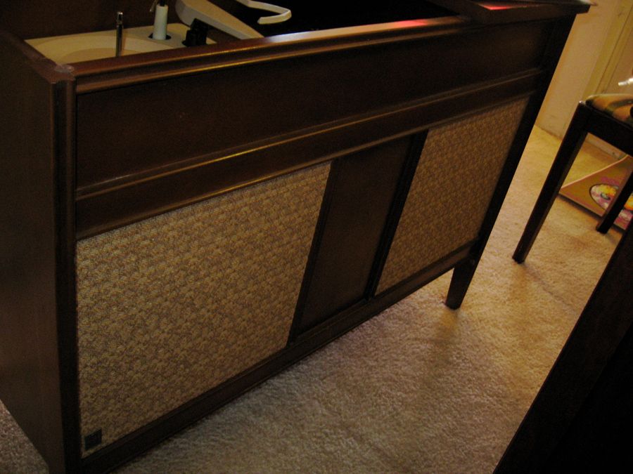

I picked up this console out of a house I was living in, figuring one day I would get to fix it up. Here we are! I can't find anything about this particular model.

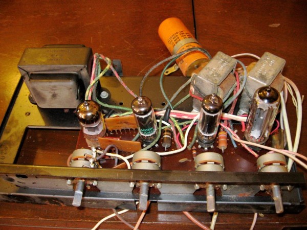

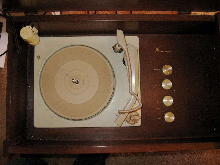

Sorry about the pics! I guess I have to attach them one at a time...the first one is the cabinet, then the record player, then the filter capacitor, and then the amp.
I ordered replacement caps the other day, so they should be in mid-week. I ordered a new needle as well, but you're saying that it's not worth it to keep it? I'm not a sooper audiophile guy...I just wanted to make it work.
That schematic looks very simliar to mine, but mine does not have a radio or a headphone jack. so here's another question: the switch on the record player turns the amp on. How do I need to wire it so the amp can be turned on with a switch? I am going to build a switchbox so I can use it for the record player and for an ipod or CD player. I've looked on the underside of the record player, but all I can see for a switch is a plate of metal that hits a little box that has wires coming out of it next to the motor. I have no idea what triggers it to switch off. Thanks for the help, and here's the pics.

Sorry, that TT is a POS. :xeye: It might be OK for 78s and 45 RPM "singles". No way should nice LPs go on that groove killer. Look carefully at the "business end" of the tone arm. Do you see the little lever sticking out sideways? That lever gets flipped to swap between the 3 mil 78 stylus and the microgroove stylus. You can bank on the tracking force being several grams. :(

So, since I'm changing the pots (and moving them, bc the new TT won't go inside the console...I'm going to set up the power and selector switches and the new pots somewhere on the outside of the console)...all of them are dual pots. Why is that, and do I have to get dual pots to replace them? Also, take a look at that first pot on the left in the amp picture. On the amp, that's the "loudness" control. I cannot find a dual pot anywhere that had 6 poles on the bottom and the 2 extra ones those white and black wires are attached to. Do you see what I'm talking about? Do you have any idea what that does? :confused:
Keep all control functions near the electronics. Mount the new I/P RCA females where it's convenient. Run shielded "twinax" wire between the new RCA jacks and the source selector switch. Connect the shields only near the selector switch, to the chassis. The shields do not carry signal. That's why you use "twinax" wire.
There are 4 ganged, stereo, pots. (volume, balance, bass, and treble) in the unit. Refer to the model RC4640 schematic. Notice that the "extra" wires go to taps on the ganged volume control. Those taps are associated with a Fletcher/Munson bass boost at low listening levels.
Simplify, simplify, simplify! Sweep all of the nasty signal shaping circuitry away. A pair of mono, L/R, volume control pots. are the least expensive way to have control over both listening level and channel balance. Connect the wipers of the source selector switch to the new volume controls. The wipers of the new pots. connect to the 'X7 grids. Mouser stock # 31VJ501-F is what you need.

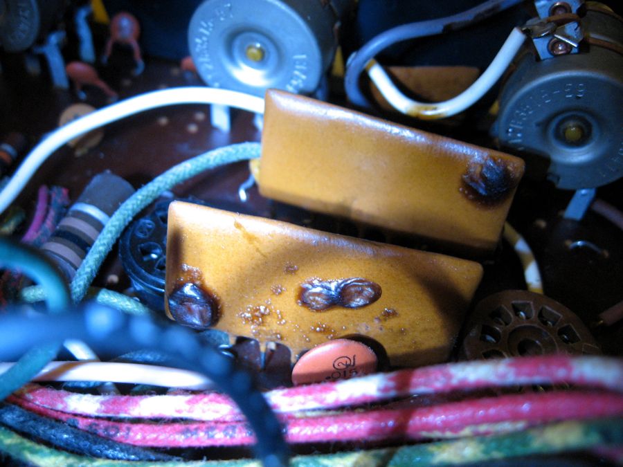

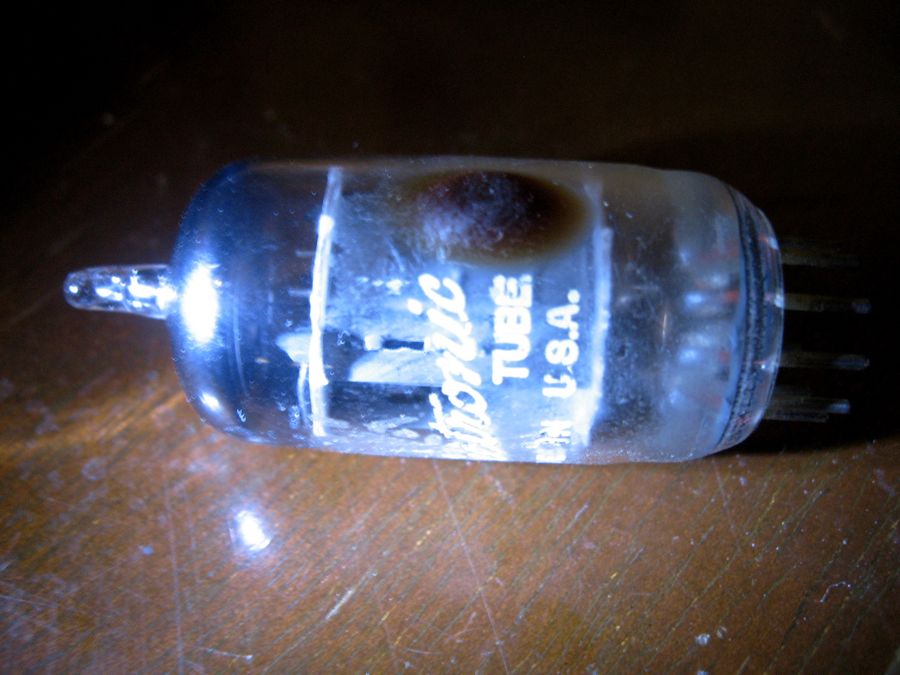

so i hooked up the new electrolytic capacitors, and nothing exploded! :clown: but then i noticed the 12ax7 wasn't lit. i'm going to attach some pics showing some damage (?) to the original 12ax7 and some damage (?) to the 2 big capacitors (?) that are next to it. does anyone know if that is a serious problem, and if so, what do i need to do? i've never seen these orange 7-pole things on any other amp, so i'm stumped. thanks in advance!

Those damaged parts, with multiple leads, are composites. :( Look at the schematic.
The circuit boards GE used appear to be low grade phenolic. Examine the Copper traces for damage.
JMO, you'll get the unit working faster if you get rid of all the signal shaping guano. The damaged composite parts are in the signal shaping stuff. :D Put the 100 KOhm pots. in and drive the unit with a CDP (perhaps a portable), during the shake down period.

Cr@p! :( I just double checked the RC4640A schematic and the composite parts that are damaged are in the "real" part of the circuit, not the tone shaping stuff. :xeye: Notice the dashed boxes around the parts intimately associated with the 12AX7 and 6AQ5s (1/channel). Those are the damaged composites. OUCH! Since you are probably forced into acquiring new, discrete, parts, make the topology change to RH84 style circuitry. The OEM PCB is of little use, unless a source for NOS composite parts exists. :att'n:
haha! yeah, someone on another site pointed that out to me...:smash:
and, they weren't damaged...it was just some wax that had built up on it...i felt like such a dumbace when i figured that out, believe me!
so, i've isolated the problem to the 12ax7 not lighting up. somehow, it's not getting power, so no sound. i need to get that working before i go and start taking the tone stuff out. any ideas on how to test that?
Examine the PCB for broken traces with a hand lens in strong light. Insert a new 'X7 to eliminate a dead tube. Jim McShane charges $10.75 for the very nice Sovtek 12AX7LPS.

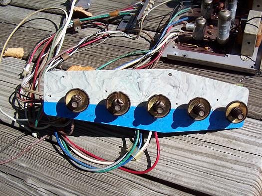

How's the project going. I just pulled the attached out of a GE Console left out for the trash man. It sounds pretty good with a cd source. I'm thinking about making a tube IPOD docking station.
The control panel includes a on\off selector switch, volume, bass, treble, and balance. I would like to replace all with a dual volume pot.
Any thoughts as to whether this amp is worth the effort?
