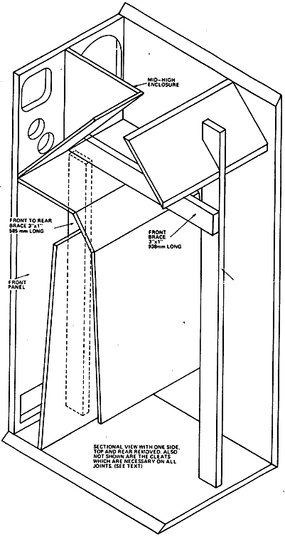

Hi Bob.
These TL's as others have mentioned were based on the original Bailey Design, which was published quite some time ago in wireless world.
The version that you see here, was developed by Mr Richard Timmins here in Australia.
I am usure of Dave Tilbrooks involvement. However he was heavily involved with ETI and all things audio, so involvement by this gentleman was possible.
Furthermore, they were used for quite some time by the ETI owned magazine Hi Fi review.
(just read the front page of the artricle!!!)
I still have the full article for these speakers, and actually own a pair, which I built many years ago.
They are BIG, heavy and sound gorgeous.

Hi All
Has been a while.
Well the speakers became plinths and used to keep vases and other household trimmings off the floor. Then I hooked them up again and figured they were worth another crack. And the drivers still need attention (Kef b110 sp1004, yes sp1004)
I was unable to locate any recone kits and replacements seem to all be odds and sods. There are some copies on the market but they get the thumbs down elswhere). So I'm faced with two options:
Option 1:
Wembley Speakers in the UK will recone them for not too much but it costs $100 to send them and probably much the same to get them home.
It seems Wembley need to make up cones and they'll use the originals to make up a jig.
Option 2:
I replace them with more contemporary units, such as the Vifa as suggested above.
Some questions:
If I get the speakers reconed is there anyone out there who wants some cones made up at the same time?
If I use the Vifa speakers I will need to modify the crossover. I'm handy with a soldering iron and can almost read a wiring diagram, what is the best way of finding out what mods I need to make?
Of course any other advise warmly welcomed
All the best
Peter
