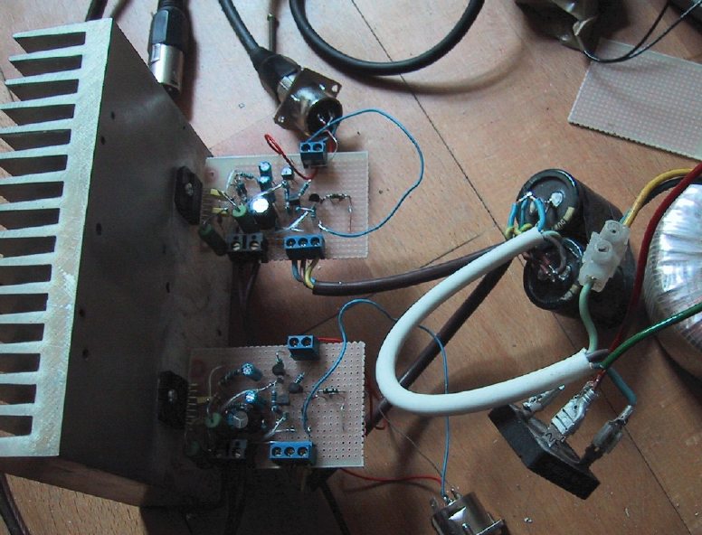

LM1876
I built one with two LM1876, one per channel.
The LM1876 is a stereo amp, 2x20W.
It has a maximum of 64V supply voltage so I use a 2x15V transformer to get about 2x20V. Probably a bit low?
The sound is not bad, bass is probably even better than my 30W-aleph-X, but it can't really compete in resolution.
Has anyone experience with this chip?
How much better are the 3876 or 3886 chips?
Is there probably an advantage in using a stereo chip because the two amps are "more equal"?

Re: LM1876
One nice thing about using a stereo amp is that you can run it in parallel. This will give you more current to run lower impedence loads. You can also run it bridged, giving you more power. Come to think of it, the LM4780 would be an excellnt cantidate for X'ing, as it has two comlete LM3886 chips in it. Add the surrounding circuitry and you have a nice, compact X'ed chip-amp. This really gives me something to think about. Any thoughts Mr. Pass?

dieringe,
Congratulations on achieving a working X'ed chip amp. I very much envy you, as I do not have (yet) an aleph or other comparable amp for comparison with my creation. But I am very much encouraged to see others trying out this approach. I believe that much can be accomplished with this approach but that it will require a group effort to sort out all the details.
My only suggestion at this time for an avenue for possible improvement lies with the power supply. The LM chips seem to interact actively with the power supply, and I believe that the key to getting the max performance will lie in optimizing that interface. Right now I am using an LM338 regulator based power supply. From your pictures it looks like you are using strictly capacitive PS filtering, could you provide some details on your power supply arrangement.
