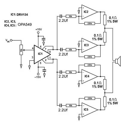

ok - this is probably the design i will use, i had added 2.2Uf caps on each chip to remove DC, also i belive the DRV134 inverts one side which is why all chips work in inverting?
if this is correct and the circuit looks ok then i wil start making it

I've never built an inverted type - it sounds like they're far more difficult to P2P. Thanks though! ;)
From my understanding, the gainclones produce VERY little DC. You are more likely to intruduce DC offset by not PERFECTLY matching those 0.1R resistors.
Someone correct me if I'm wrong! Looks like you've got a great little project there!
