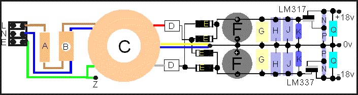

Also all the bits for my 'Nuuk' active stage and psu arrived today.
Good god those 4.7uf poly caps are huge!!!
How the hell am i going to fit some of them in my cd player?
Anyway christams came early.
fil

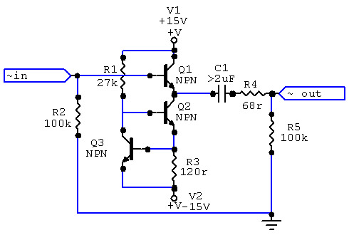

I would sujest using the buffering both sides of the pot. This would make it a universal preamp suitable for all situations. The single power supply should cope with both easily, and the circuit is so simple and small that finding room for it shouldn't be a real issue.
First off i would see how it sounds with the pot you have and without modification - you might find everything hunky dory with the buffer added.

filholder said:Good god those 4.7uf poly caps are huge!!!
By the way, the quality of this part is important. It is a good place for a boutique type cap.

So now I have an extra regulator. That's why I am happy to see Shoog's suggestion of putting extra buffers before the pot
What do you guys think, should there be a capacitor on the output of the buffer before the pot, too? Will the DC offsets add up and become too much (or whatever bad) otherwise?
I fitted a second discrete regulator so that the two buffers are fed separately, but did not notice any obvious differences between that and single supply.

I have nearly finished the PSU and am starting to think about the actual buffer circuit.
On Nuuks diagram for the buffer circuit you have a +15 and a -15v and a ground. The ground i presme is the 0v on the psu board. What i dont understand is the ground for the input and output. Are these also connected to the power ground or do just connect together as in only the input and output go to through the buffer and the grounds just connect together.

All grounds are to be wired together. The ground is always common. Sometimes ppl are talking about power ground and signal ground, but that is all just about which order to connect stuff to the common ground. The grounding order of this preamp does not seem to matter though.
So the signal ground wires of both input and output would be connected to the 0v line on this diagram. Actually they would be connected after the second stage of regulation but you see what i mean.
Thanks for your help by the way, i find grounding the hardest part of all this stuff, seem to get confusing very quickly.

I personally am not certain you will get much of a benefit from the buffer before the POT, I think there is a potential for it to sound just as good without it. I would incorperate some simple method of bypassing it to see which you prefer. I for one would be interested in the result as I was contemplating this myself but never got around to it.

No I mean bypass the first buffer before the pot. Adding in the buffer before the pot also adds in an extra cap in the signal path - you may just find that the improvement gained by having the first buffer is then waisted in going through the extra cap. Theres no easy way of knowing without actually trying it in both configeration, therfore I advocate a bypass for the first buffer so that you can make an empirical judgment for yourself.
Don't take anyones word for the benefits to be achieved from one implementation over another. Their experience and taste may be completely different from your own. I would value your own experience above all.
