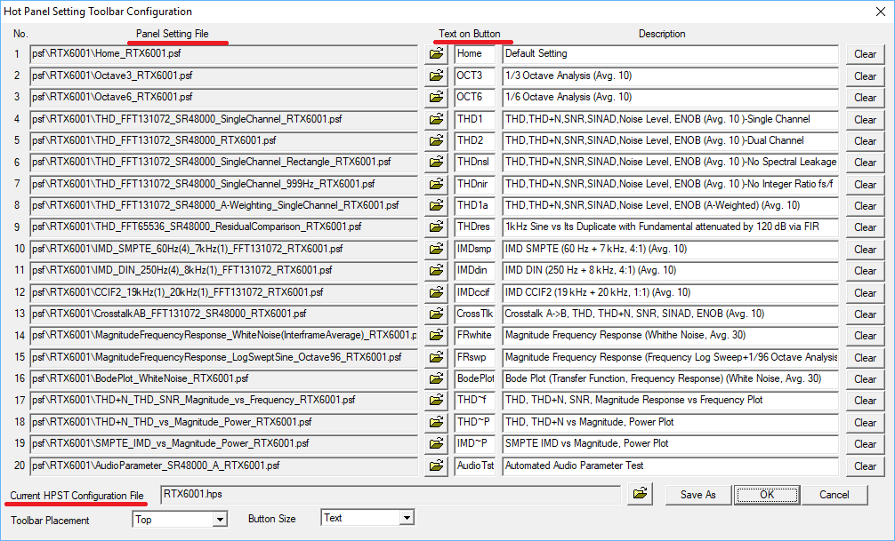

I was wondering, is there a way to setup a group of settings profile, including instrument layout, so that we can call up any specific profile for a test without doing setup from scratch?
Also, I would a predicate push update notifications to keep up to date on MI Pro software revisions, is this possible?
The third toolbar from the top is user configurable. It is called “Hot Panel Setting Toolbar” consisting of 20 user configurable buttons. You can configure this toolbar via [Setting]>[Configure Hot Panel Setting Toolbar]. Each button can be assigned a Panel Setting File and a label. When clicked, it will load that Panel Setting File. The entire toolbar configuration can be saved as a *.hps file. (See attached).
A Panel Setting File can be saved via [Setting]>[Save Current Panel Setting]. It contains sampling, processing and analysis settings as well as the layout information.
Software update notification will be included in the future. Thanks for the suggestion.

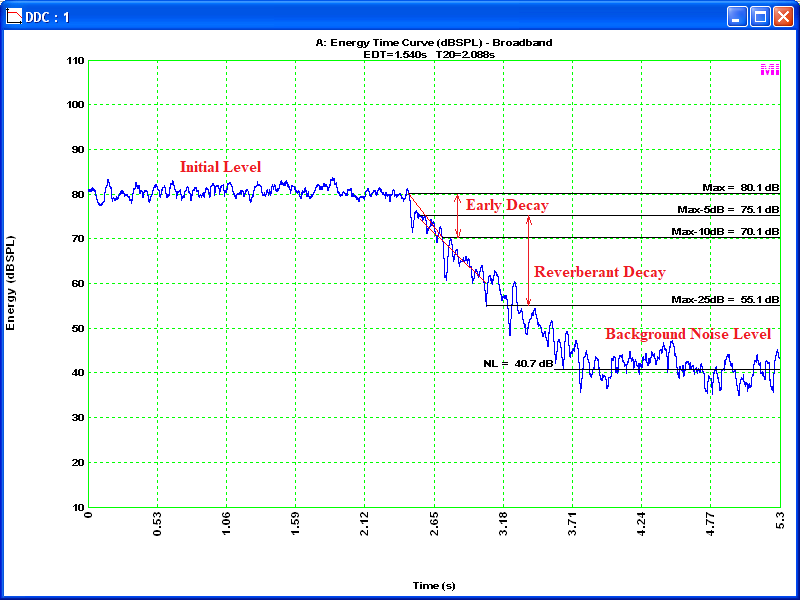

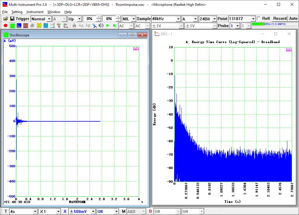

1.Reverberation Analysis via Interrupted Noise
2.Reverberation Analysis via Integrated Impulse Response
3.Reberberation & Speech Intelligibility Analysis Results

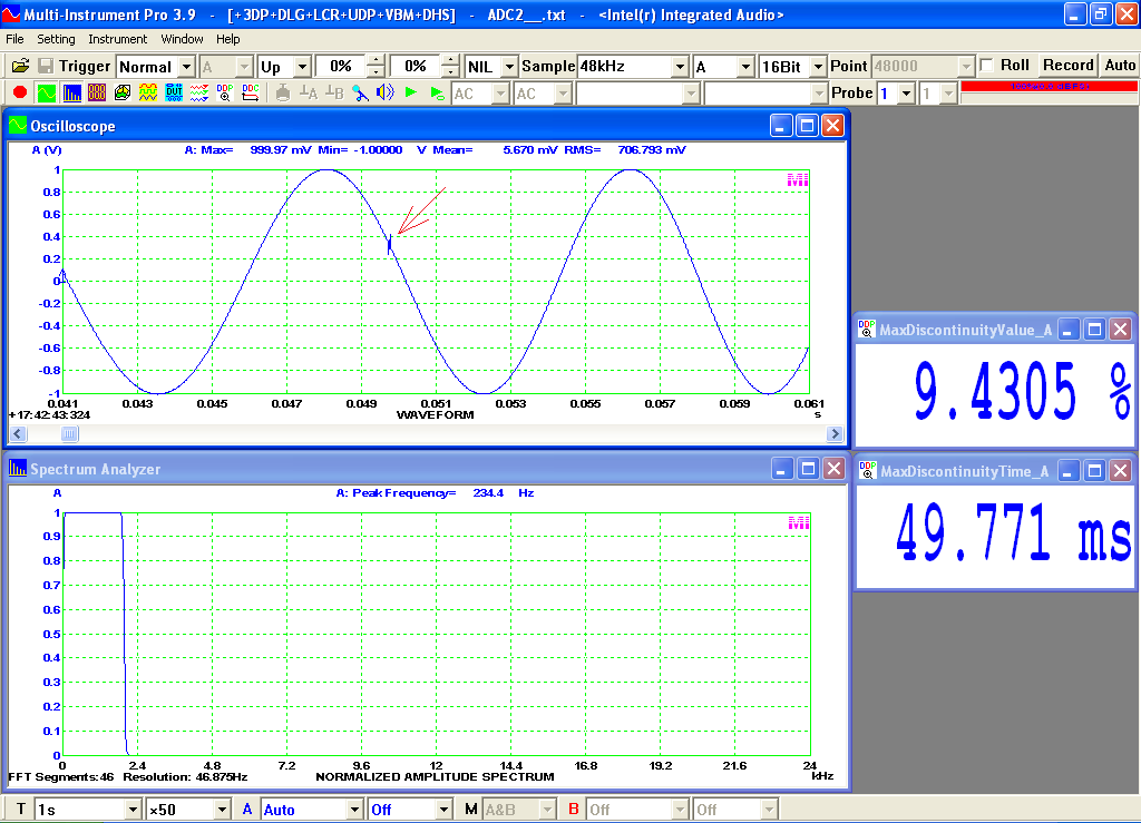

4.Discontinuity (Abruptness) Detection

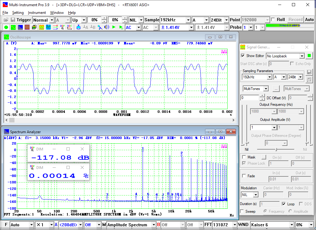

[+] Added DIM option in [Spectrum Analyzer Processing]>"Parameter Measurement">"IMD". The corresponding MultiTones configuration files for DIM30 and DIM100 test signal generation are also provided.

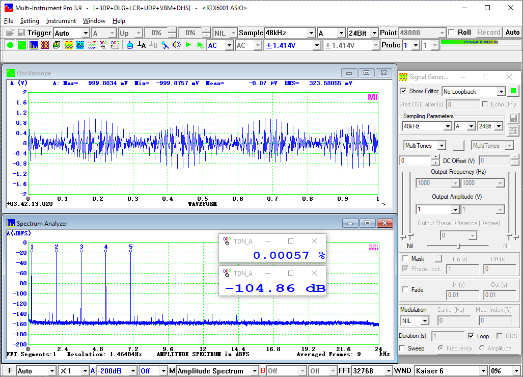

[+] Added Total Distortion and Noise (TD+N) option in [Spectrum Analyzer Processing]>"Parameter Measurement">"Peaks". If selected, the detected peaks will be considered as the multitone stimulus and the rest will be considered as the total distortion and noise. The corresponding DDPs are: TDN_A(%), TDN_A(dB), TDN_B(%), TDN_B(dB).

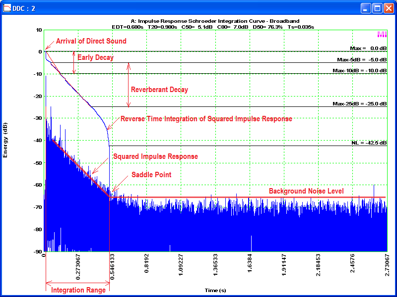

[+] Added Derived Data Curves (DDC) button in the Instrument & Miscellaneous Toolbar. Maximum 8 DDC windows can be opened concurrently. The following DDCs are available:
(1) Energy Time Curve (Log-Squared)
(2) Energy Time Curve (Envelop)
(3) Energy Time Curve (dBSPL)
(4) Impulse Response Schroeder Integration Curve
(5) Step Response From Impulse Response Integration

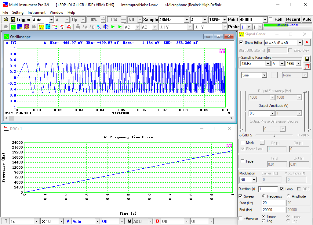

(6) Frequency Time Curve
It is possible to apply a 1/1 octave filter from 63Hz to 8kHz or 1/3 octave filter from 50Hz to 10kHz to the time-domain data non-destructively before deriving the above DDCs.
[+] Added [Oscilloscope Processing]>[Parameter Measurement]>"Reverberation / Speech Intelligibility" option. If ticked, reverberation analysis according to ISO3382 and speech intelligibility analysis according to IEC 60268-16 will be performed. The analyses can be based on either 1/1 or 1/3 octave bands. Parameters that can be measured include Early Decay
Time (EDT), Reverberation Time RT60 (through T20 or T30), Clarity C50 and C80, Definition D50, Center Time Ts, Modulation Transfer Function (MTF), Articulation Loss of Consonants %ALcons and Speech Transmission Index (STI). The results are stored in DDP arrays: AcousticParameter_A_Array and AcousticParameter_B_Array. They can be viewed as a report through DDP Array Viewer:

[+] Added [Oscilloscope Processing]>[Parameter Measurement]>[Discontinuity] option. If ticked, the maximum waveform discontinuity value and its time of occurrence will be stored in DDPs:MaxDiscontinuityValue_A(%), MaxDiscontinuityTime_A(ms), MaxDiscontinuityValue_B(%) and MaxDiscontinuityTime_B(ms).

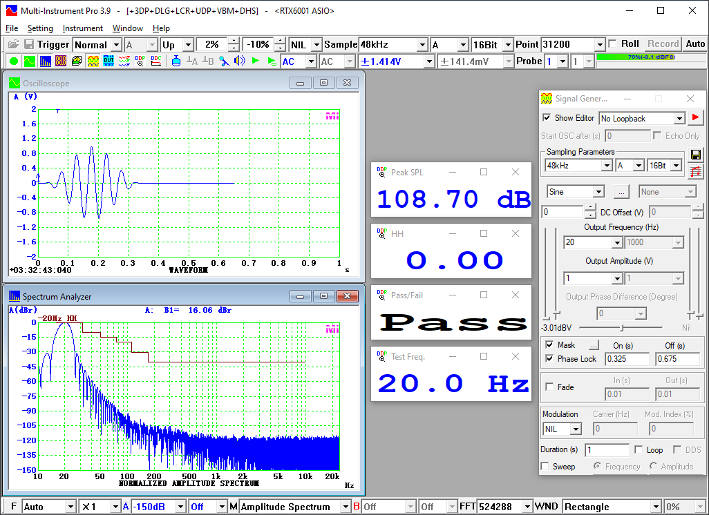

[+] Added Panel Setting Files for ANSI/CEA-2010 subwoofer max. SPL test.

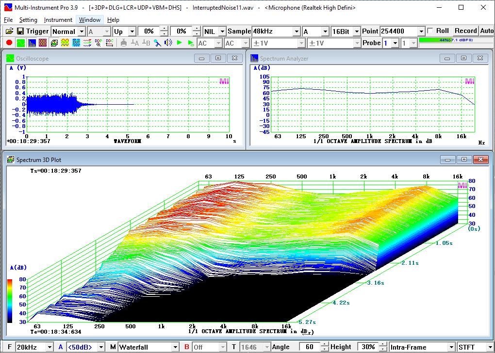

5. Reverberation analysis via Intra-frame waterfall plot.

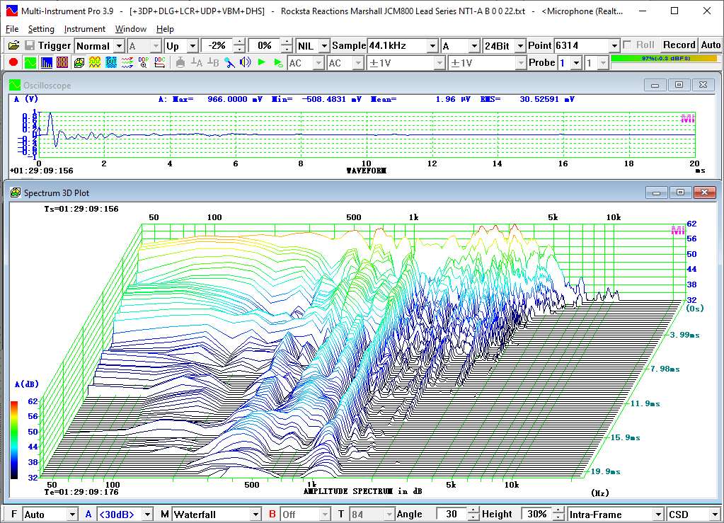

6. Cumulative Spectral Decay (CSD)
7. ANSI / CEA-2010 Subwoofer Peak SPL Test
8. DIM30, DIM100
9. Total Distortion + Noise (TD+N)

11. Frequency Time Curve
