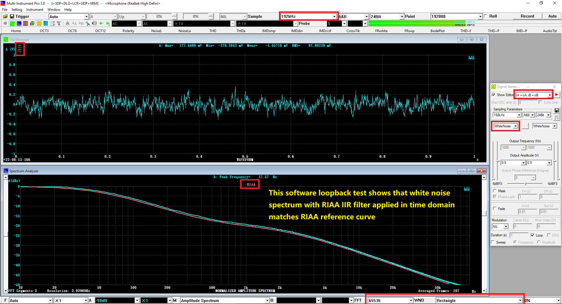

Method 1. Apply Recording RIAA IIR filter in time domain (Oscilloscope)
Right click anywhere within the oscilloscope window and select [Oscilloscope Processing]>”Digital Filtering”>”Arbitrary”>”IIR Coefficients” and then load a preconfigured Recording RIAA IIR coefficient file, e.g.:
(1) RecordingRIAA_SR44100Hz_IIR_Order2.iir
(2) RecordingRIAA_SR48000Hz_IIR_Order2.iir
(3) RecordingRIAA_SR88200Hz_IIR_Order2.iir
Note that the sampling rate of the IIR coefficient file must match the sampling rate of the oscilloscope.
In MI, generally the acquired signal will be processed in time domain (Oscilloscope) first and then flows to frequency domain (Spectrum Analyzer). Please refer to Section 1.6 Signal Flow Block Diagram of the software for details if you want to configure your own DSP processing and analysis algorithm.
After the above Recording RIAA filtering in time domain, if the frequency response of the DUT follows Reproducing RIAA exactly, then the measured magnitude frequency response in the Spectrum Analyzer should be a flat horizontal line.

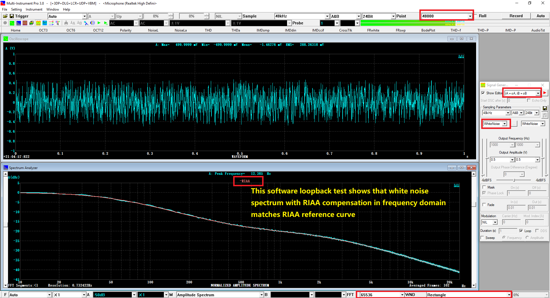

Method 2. Apply Recording RIAA frequency compensation in frequency domain (Spectrum Analyzer)
Right click anywhere within the spectrum analyzer window and select [Spectrum Analyzer Processing]>”Intra-Frame Processing” > ”Compensation1” and then load the frequency compensation file: RecordingRIAA.fcf.
If the frequency response of the DUT follows Reproducing RIAA exactly, then the measured magnitude frequency response in the Spectrum Analyzer should be a flat horizontal line.
Note that the time domain waveform will not be affected by this method, unlike the previous one.
Method 3. Check the measured magnitude frequency response directly against the Reproducing RIAA reference curve
To load the reference curve, right click anywhere within the spectrum analyzer window and select [Spectrum Analyzer Reference] and then load ReproducingRIAA.ref. It is advisable to load this reference curve in a channel different than the channel where the measured frequency response curve resides, so that you can adjust the vertical offset between the two curves for easier comparison. To hide the real-time spectrum in the reference channel, set its color to the background color.
The following are two examples using white noise as stimulus through software loopback (iA=oA, iB=oB). White noise spectrum is flat.
(1) A ReproducingRIAA IIR filter is applied in the oscilloscope. The measured spectrum matches the Reproducing RIAA reference curve.
(2) A ReproducingRIAA frequency compensation file is configured in the spectrum analyzer. The measured spectrum matches the Reproducing RIAA reference curve.
