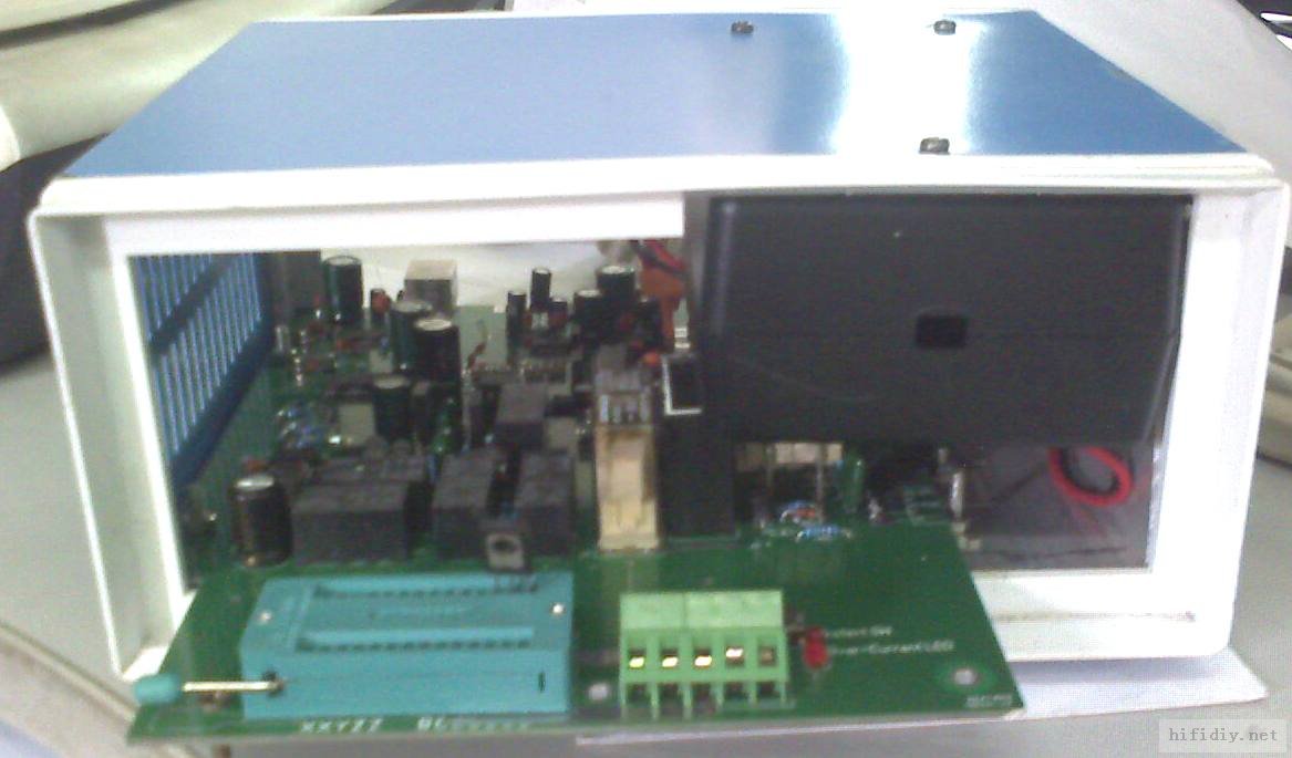

There are some 2500mA 32V power supplies for HP printers, but no higher current ratings than that (search eBay on 'HP 32V 2500').
Locky_Z: what is the power supply unit you used in your photos (brand) ?
I use HP print supply, and modify to 40V. And have tested under output 2500mA.
How did you modify the HP supply for 40V?I use HP print supply, and modify to 40V. And have tested under output 2500mA.

The HP supply is use a 8.x V zener as voltage reference, I series a TL431 to 11V,So output is 41V.How did you modify the HP supply for 40V?
And I use 15ohm resistor to test the output current. The supply not protect.
You can use this box. My PCB is designed according to this box.Heat sink use 5cmX5cm angle aluminum.P.S. What about a GB for a cheap case
