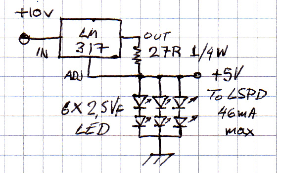

IIRC, that supply for the relays is pretty basic. If I were you I might tap into the higher voltage supply and use the little shunt circuit that Salas posted back up (the one with the 6LEDs). Thats what I'm going to use I think.

EDIT: heres the post in the lightspeed thread:
http://www.diyaudio.com/forums/showpost.php?p=1918670&postcount=2463
and the sch:
Fran
and the sch:

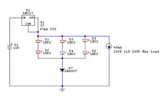

In practice, if the Leds you gonna use in the minishunt don't reach Vf when you have max consumption (100R LSPD at min vol or max vol) you can go with 22R instead of 27R for the 317 CCS. So there will be more current left for them to go strong enough. You will see. I remind you that if you can find easier 2.2V Vf LEDs for instance, you can lift the voltage with one diode between the LEDs and ground. With 2.5Vf Leds you don't need to add yet another component with its own little noise though. This minishunt is the simplest thing, and parallels Leds, cutting their noise further. Let us know if you can detect any differences VS battery PSU. Will be an interesting experiment. Here is an example schematic for 56mA CCS and 2.2Vf matched LEDs (possible to find a mean average like that). That will keep the shunt LEDs between 6-12mA for max-min 2 channel LSPD consumption scenarios. LM317 needs no sink.
