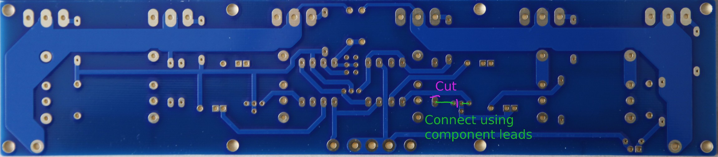

I have some bad news regarding the F4 boards you have ordered. I ran over them again today and to my horror I discovered an error in the layout. :(
Good news is that it is fixable.
R6 should be connected to the node between P2 and C4 instead of as it is now between P2 and R22. The mistake can be fixed relatively easily by cutting two traces and extending the leg of R22 to connect to the other end of P2 and bending one leg on P2. I have attached a drawing of what needs to be done to fix the problem.
I have already written to those who have ordered, so if you have ordered, but not received the mail, please write to me.
I still have more boards left and I'll cut the traces so that the boards can be used virtually without any extra effort. However since people might not like to have to stretch a leg on a resistor, I'll lower the price from $9 to $7.

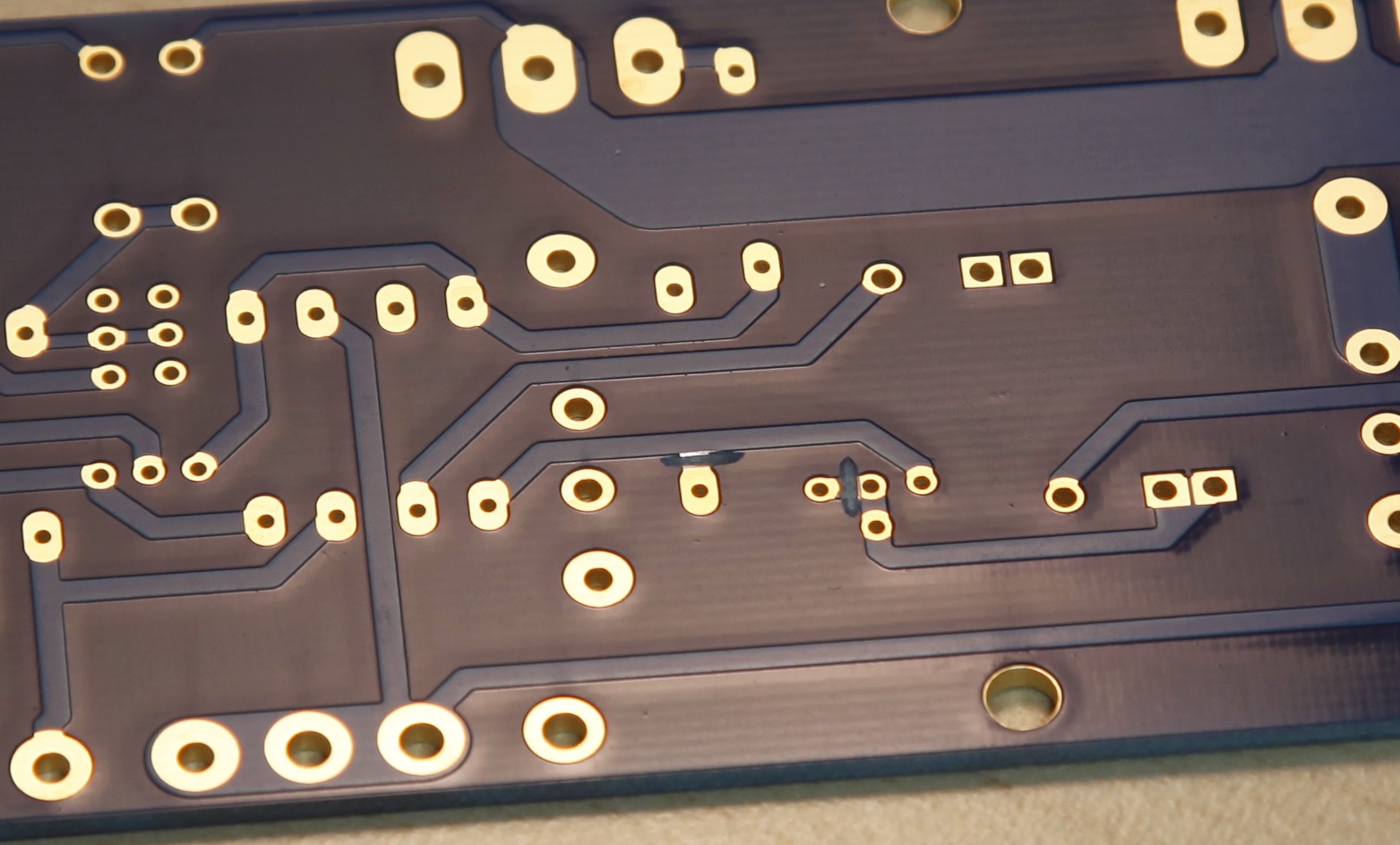

Before sending the boards I cut the traces so that all you need to do is to bend one leg on R22 and one on P2 to get the correct operation. Here is a picture of how the boards look after I have cut the two traces.
