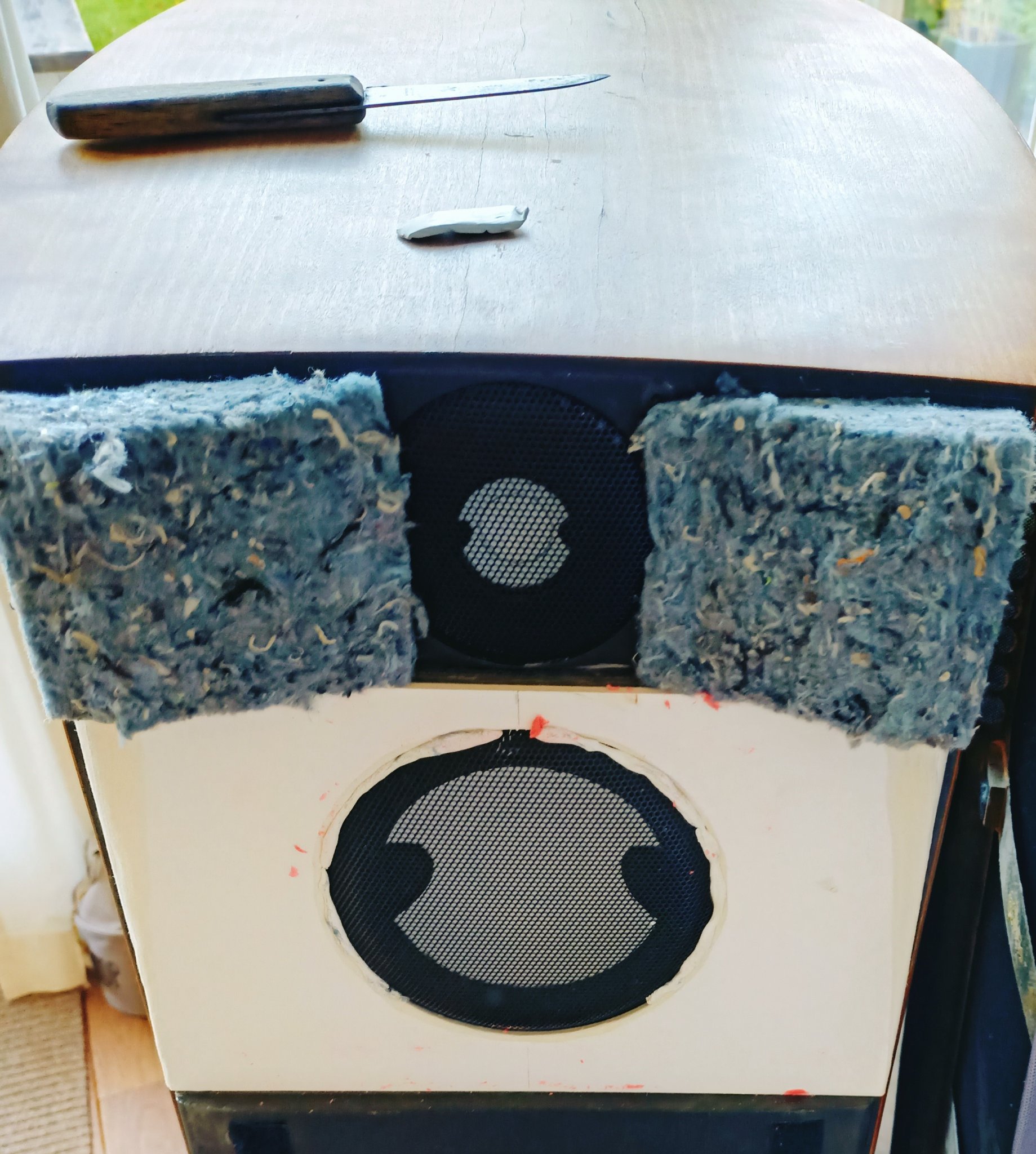

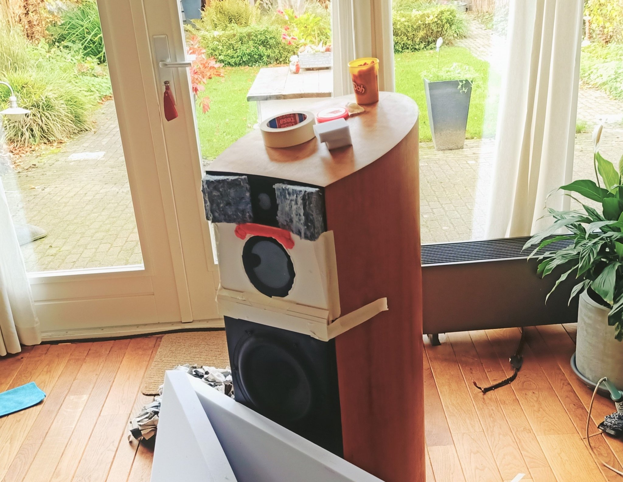

In order to understand the impact of the baffle on the midrange frequency response i did a quick test as shown in Tmuikku's thread (see above). I first focused on the on-axis response.
In 2 different sessions i made measurements, here combined in 1 graph:
Bottom 4 responses, measured on-axis at 1000mm from midrange baffle:
thick red dash C90-6-078-R--Bare01_deg0: the baffle without any mod's for midrange or tweeter, the "bare baffle".
thin violet dash C90-6-078-R--ECOabs-Wig01-V02_deg0: On both sides a wedge of the EcoAbs material (~ 10cm wide, 4 cm thick))
thin light green dash C90-6-078-R--ECOabs-JDI_deg0-TEST: The original JDI EcoAbs material
thin dark green dash C90-6-078-R--Flamex-Wig01_deg0-TEST: On both sids a wedge of Flamex (melamine foam) shape similar to the EcoAbs wedges.

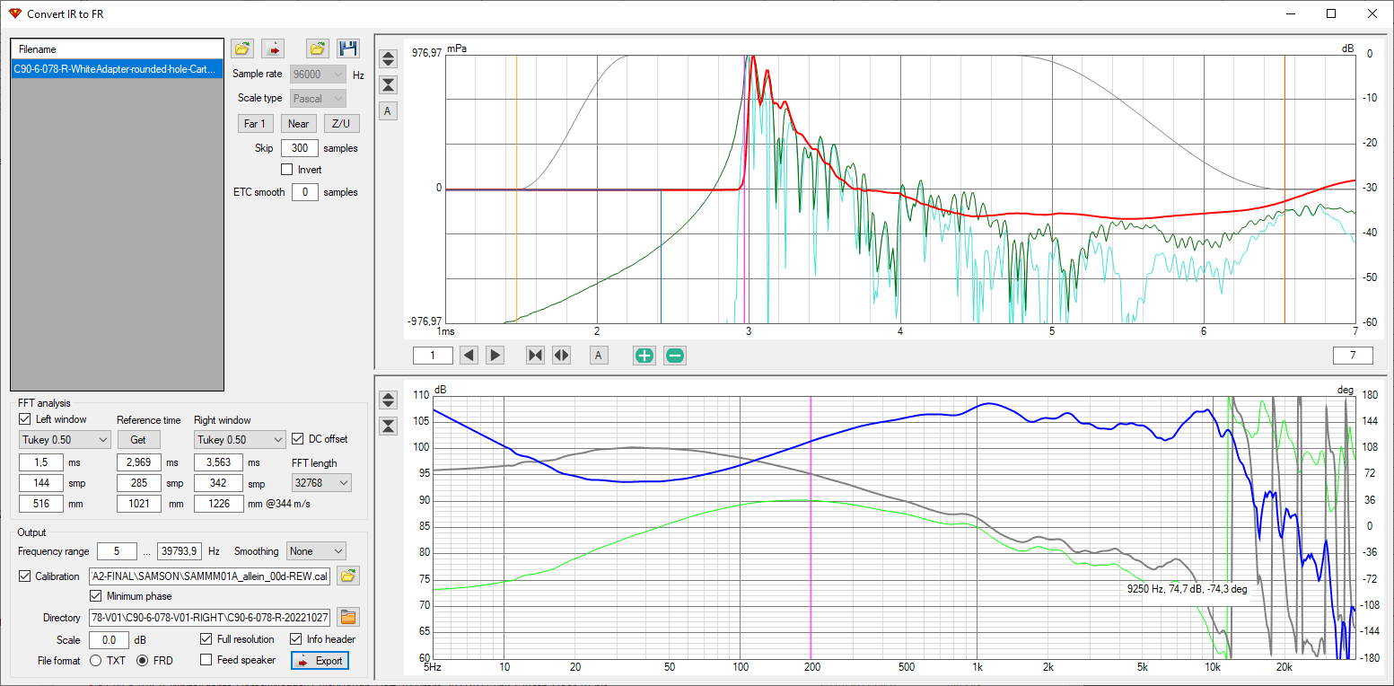

Used Vituixcad IR2FR to generate the frequency Response, with settings:
Note: The little hump at 7.5msec is the remainder of the floor reflection as i use absorbing plates to reduce that.
Top 4 responses, in this session i aimed at developing an understanding of which edges are responsible for what part of the diffraction effects:
thick red dash C90-6-078-R-Bare-Hart-1000mm-20221027-96k-F2Resp-Floor-02: again the response with the bare baffle but with the tweeter wedges.
thin violet dash C90-6-078-R-WhiteAdapter-Hart-1000mm-20221027-96k-F2Resp-Floor-01: with 3mm thick carton a smooth baffle
thick green dash C90-6-078-R-WhiteAdapter-rounded-hole-Carton-Ridge-putty-top-Hart-1000mm-20221027-96k-F2Resp-Floor-0: with make shift add-ons for the bottom and top ridge. See attached picture:
blue-red combo the D1 is actually C90-6-078-R-WhiteAdapter-rounded-hole-Carton-Ridge-putty-top-Hart-905mm-20221027-96k-F2Resp-Floor-01: like last one but measured at 905mm distance.
The Vituixcad IR2FR setting used:
C90-6-078-R-WhiteAdapter-rounded-hole-Carton-Ridge-putty-top-Hart-1000mm-20221027-96k-F2Resp-F...PNG
My take-away from this:
Smooth baffle, avoid sharp edges, the top edge had a strong impact on the dip around 1.8 kHz, absorbing material on baffle can help (but not so straightforward, the baffle behaviour remains present to an extent) , check on different measuring distances as i am dealing with interferences.
Question to address: how to take the tweeter part of the baffle into the equation.

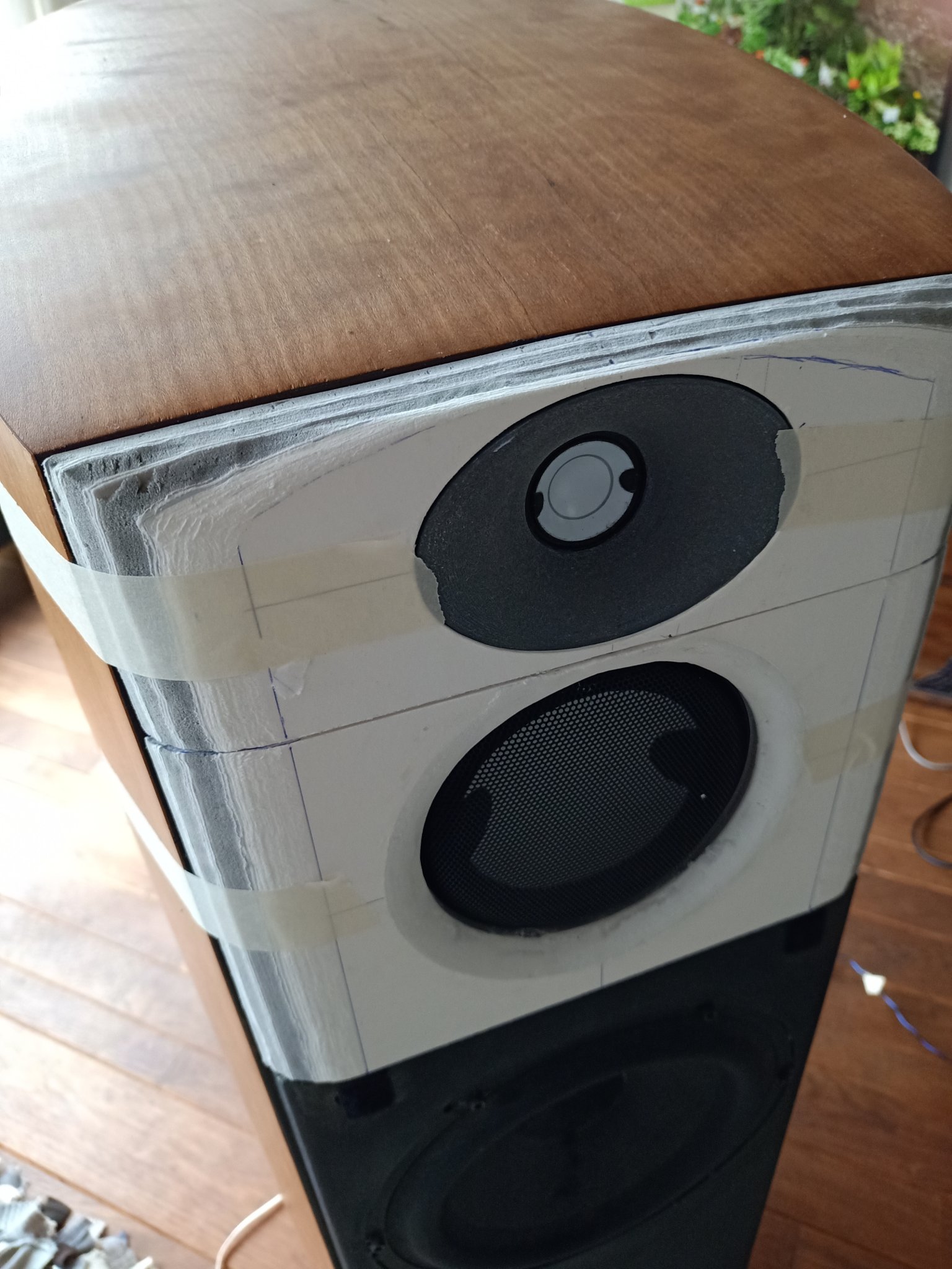

First looking back a bit. I tested with sound absorption material in order to get a smoother on and off-axis response. To cut a long story short: I stopped in that rabbit-hole (for now).
It showed both an behavior as if the baffle width was increased(longer path to diffraction edge) at frequencies between 500 – 2000 Hz approximately (increased output of 1-2dB), and some absorption from say 800Hz and up but diminishing above ~ 2kHz due to increase in beaming of driver. This apparent width increase did exaggerate the baffle behavior of initial bump and dip. It did smoothen the off-axis response though.
Note: for that purpose the ECO-Absorption material (shredded jeans etc) showed more absorption than flamex (melamine-foam).

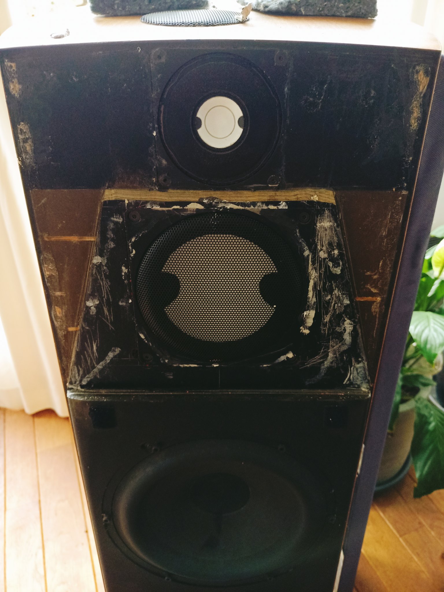

So decision taken to alter the baffle around midrange and tweeter, basically adding material in order to get a smooth and flush baffle (current situation has quite a few steps/ridges). Also in the mean time I asked @augerpro (Brandon) to help in developing a waveguide for the Accuton C30-6-024 tweeter , in photo already with grille removed):

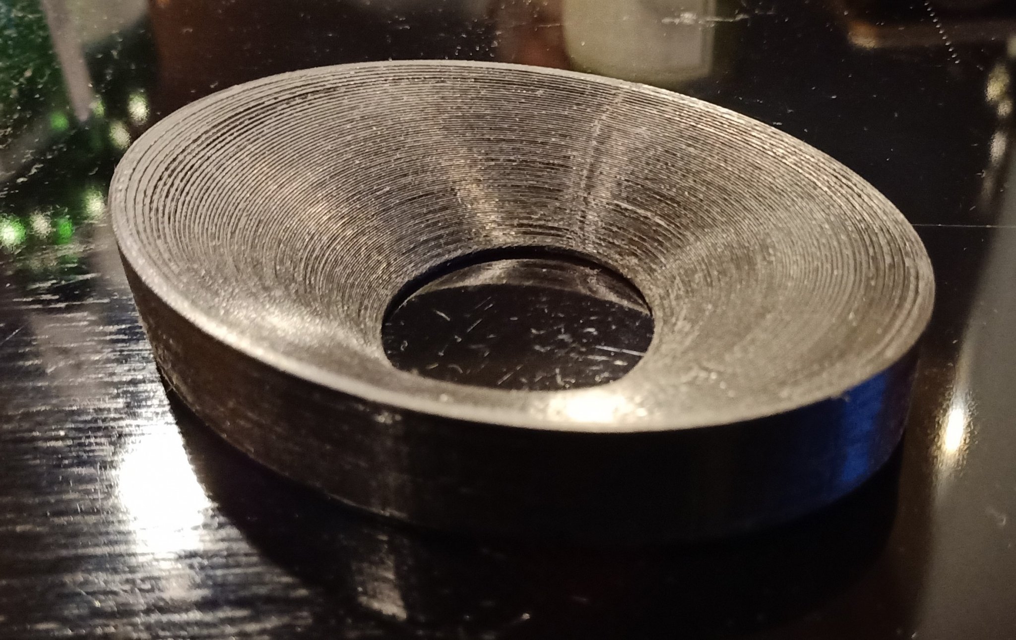

When that design arrived I already arranged a 3D filament printer, and in Draft mode created for initial testing a usable waveguide. ( i filled and sanded it a bit not shown )
Scanning through the posts on DIYAudio about waveguide mounting etc convinced me that the edge should be flush mounted.
So I made a baffle add-on in two pieces, one for midrange and one for tweeter part.
I cut and glued together some foamboard (a leftover form my Fine Art Printing shop), and then did cutout and for midrange some filler to provide a smooth edge.
The midrange is now recessed, thus need to figure out the shape of the edge around the midrange. I will remove the grille, if necessary, but for now I leave it as a protection).

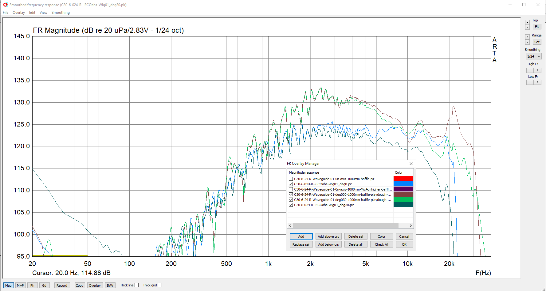

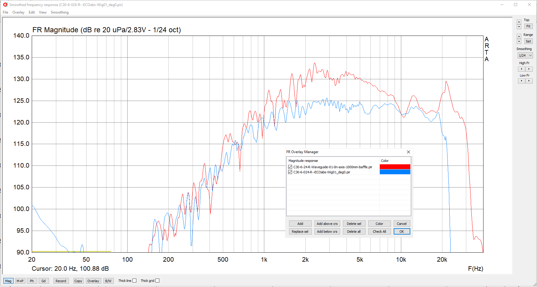

Enough for quite some posts, but first the first round of test results with the tweeter waveguide.
The Accuton C30-6-024 flush mounted and with ECOAbs wedges left and right, versus the waveguide as depicted above:
Note I did not apply a short gate, and the flush mounted was measured with 48kHz sampling versus 96kHz for the other measurements. Both with distance of 1000mm from the front. So with the waveguide the tweeter itself is actually some 18mm further away.
In vertical direction I did moved the tweeter some 10cm up (so at 3m listening distance that would be 30cm) , the response is virtually identical.
I did not have time enough to set up the turntable for horizontal off-axis measurements, so I did only test at 30 degrees of axis:
Pretty clear that the beaming of the tweeter at increasing frequencies is less and more even with waveguide. Also that there is some anomality from 10kHz upwards and some dip at 3.3 kHz. Note: The breakup starting a little above 20kHz is something I want to reduce in the xo-filter, like Purifi has shown in one of their technical articles.
The anomalities may be because of the not-perfect alignment which I did by sight. Note that I did take care not to have a small gap between the tweeter faceplate and the waveguide throat. Perhaps something else as well?

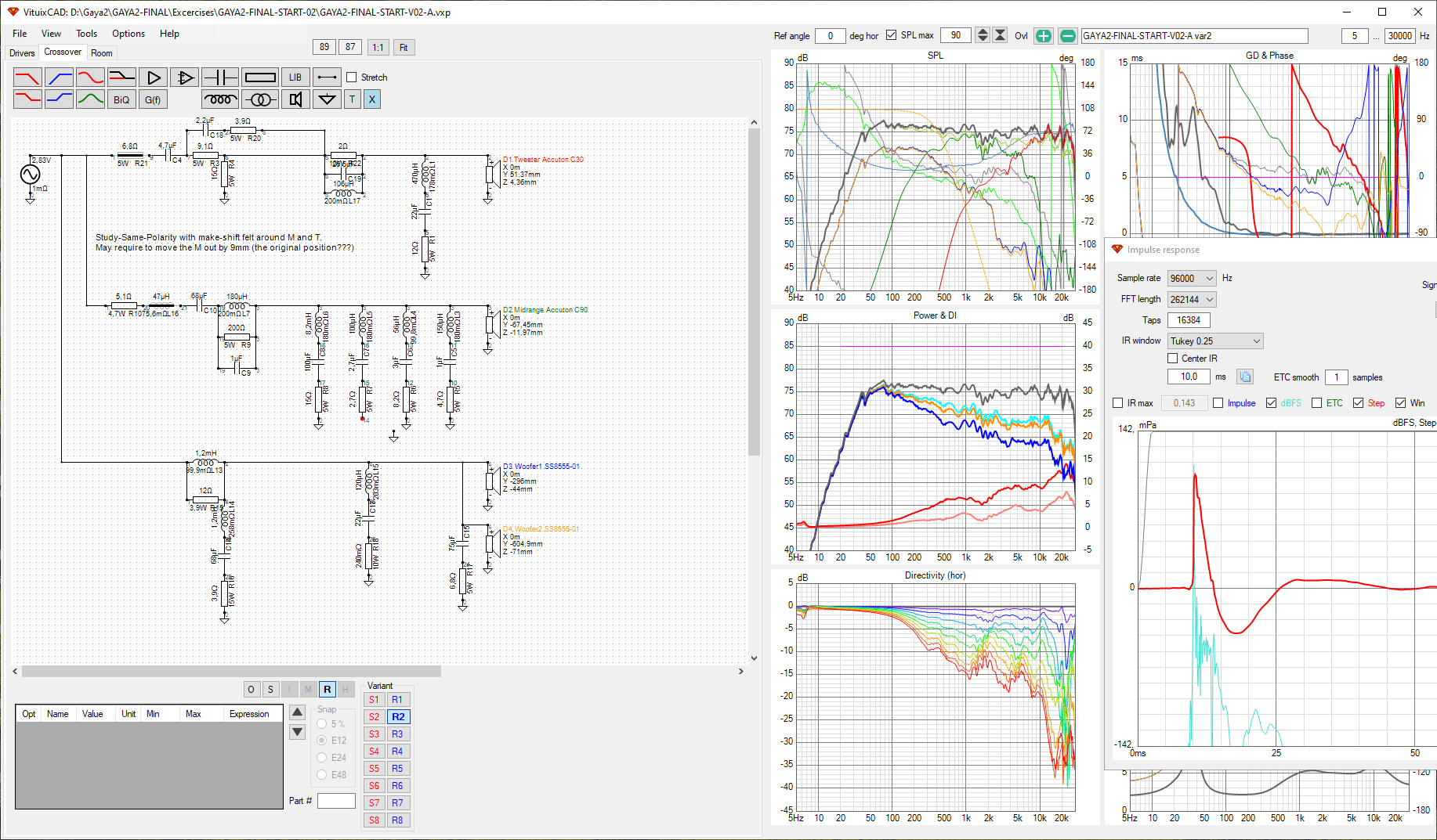

Can I ask about the 21W crossover slopes? Are the woofers rolled off at the same frequency? Did you have to notch out the breakup peaks?

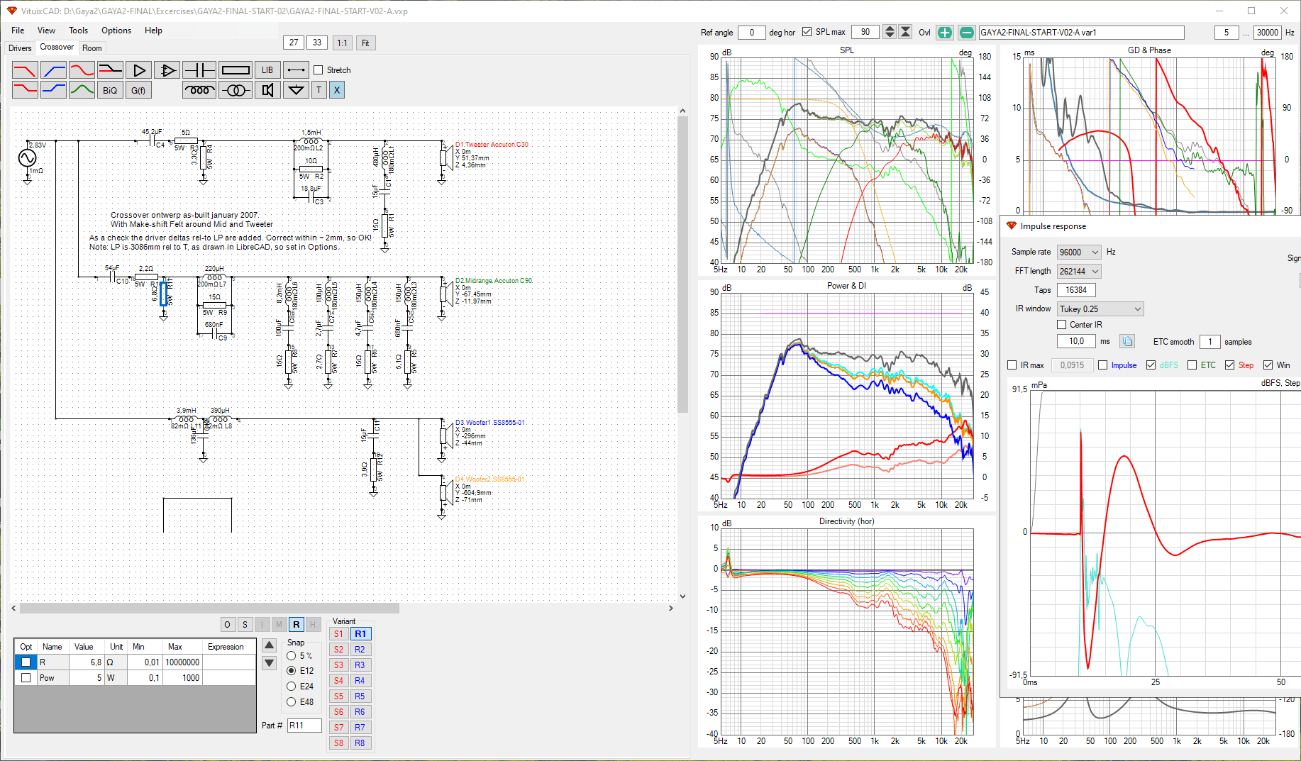

Below 2 VituixCAD essays, the first one uses the data of 15 years ago. But then i used XSIM, however VituixCAD gives a somewhat different result. XSIM is one axis only so multiple axis responses not shown in one view.
The second one is an essay to get aquainted with VituixCAD, and just some measurements some months ago, to see if i can get a filter where the woofers do not have to be in reverse polarity. It also shows the diffraction issue (big dip around 1700 Hz) with the midrange and the beaming diffferences between midrange and tweeter. Reason for me to focus on a waveguide for the tweeter and modification of baffle for the midrange to get a smoother response in the critical 700- 2500 Hz region.

Hi, I like your plan.
You got great drivers and build a fantastic looking cabinet.
Then you made the first grave mistake with the baffle. It is (you sure know today) just a recipe for disaster. The second, even bigger fault was to build the x-over you made, as it can not work with this baffle.

@ctrlx : It is shown in post 3. The measurements of xo with the dip was on this baffle with a 2cm thick absorbing material. At this moment making some changes to a new baffle prototype to see if the dip on-axis is minimised, and the off axis are well behaved. And on both sides of the tweeter a wedge of same material.
What i learned the past months that baffle diffraction effects increase with measuring distance, and from 1m onwards sort of stabilize. ( my yesteryear measurements were mostly on shorter distances, so useless today)
In essence i see the baffle as a type of waveguide, where you need to incorporate edge diffractions in the middle of the bandwidth and the enclosure shape 'behind' the baffle. The crossection of my enclosure is basically ellips shaped, with one end cut off for the baffle. The front baffle ia 26.2cm, and the max width of the enclosure is 32.8cm and in simulations it look like the 32.8cm width effects are also present. Helas it cannot be combined in one simulation. (I used Vituixcad, Tolvan Edge, Bagby Diffraction for the simulations, i only wish i can operate a more advanced sim tool )
Anyhow i will get to an acceptabele result, the only time hindrance is to get the living room all for myself with enough time to do measurements ;-)
Wrt to active vs passive, for now i go for passive, simply having enough component to build the xo. But i am also figuring out an acceptable configuration for active. In either case the basis still is good quality and repeatable measurements of individual drivers.
We can discuss how a baffle should look, but yours with the tweeter directly at the top edge and lot's of space left and right was quite unlucky. Then you startet to simulate the x-over, not with the actual frequncy response in 1m, but probably with one from the data sheet. So the whole thing was made to return a not really perfect result, to say it polite. Maybe skip the idea with all that felt stuff at the baffle. You can do without it.
