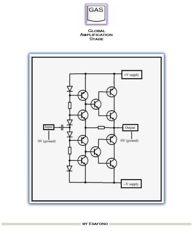

GAS - Global Amplification Stage
Hello!
this important schematic is a World Heritage
please add your modification :) :cool: ;)
Regards

thanks, Stee
nice schematic :cool:
what tests have you done:
- as buffer, Gv=1
- at Gv=10 (+20dB)
- with different loads
- with different input AC levels
- with different output AC levels
- with different Voltage Supply
what is the recommended nominal Power Supply to use?
2 x 20 VDC max ... or
what transistors you use - you recommend
NPN? PNP?
thanks ;) lineup is interested
Stee

Hi lineup
lineup said:
thanks, Stee
- as buffer, Gv=1
- at Gv=10 (+20dB)
NPN? PNP?
never tested, it's a fresh idea
think is better use power bipolar as 2SA5200 & C TOSHIBA
and his drive can be MJE340 & C
just to start at Gv=10 (+20dB) with dual 30V
do you have a simulator?
Regards

Are you trying to design something that looks good as a schematic (very symmetrical) or something that actually works? :D
Your cut and past from other people's schematic, without quoting the authors, won't make you a more experienced designer. Don't think I didn't recognize the cut and paste from Elliott, in the schematic from the other topic.
actually after i got time to look at i did find one such "fallacy" with the circuit. look at the center vertical string of diodes and transistors. there are 4 diode drops between each rail and the center point. so the center point wants to be at 2.8 volts from each rail. while this circuit might work with +/- 3V rails(and i say might, because i was just scanning it by eye first for obvious "oopses", and not yet looking at actual operational mechanisms), much higher than that will definitely let the magic blue smoke out of these components. operationally, it looks as if the middle section is a problem again here. there is no net change of conduction here between the rails and the center point, so the center point will tend to hover around zero. even if there were a change in conduction, you have the diode drops swamping what little net changes in conduction you do get. what should be a high impedance node (the VAS) is shunted by a very low impedance (the diode drops. the actual high impedance nodes in this middle stage are the collector connections, just like in the first stage, and being a second inversion (the first inversion takes place in the first stage) follows the input signal. well, that's what i can see taking a closer look at it, if somebody has modeled this, please pu your $0.02 in. if nobodey does, then i'll model it tomorrow and see what happens. as i suspected though, it is a lot like the "dual bridge" rectifier circuit with a high potential for pyrotechnics. the "dual bridge" is a classic. take 2 bridge rectifiers and put them in series (connect an ac pin of one to an ac pin of the other, then connect the remaining ac pins across a transformer secondary). then connect the middle (the two interconnected ac pins) to ground, creating an artificial ground. then connect the negatives together and the positives together for the rails. you now have a fire hazard. if you draw it out with diodes, you will see a very direct path (well, sort of, it actually zigzags through the bridges)through the diodes across the transformer secondary
