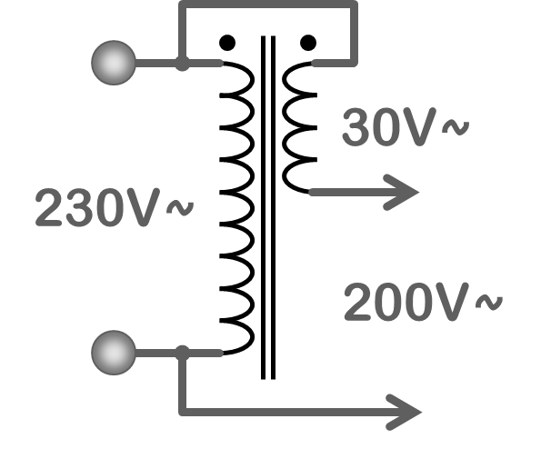

Cheap Garrard Power Supply
I have experienced that feeding my Garrard 401 with 200VAC lowers the noise from the motor without sacrificing any dynamics from the player. I include a circuit for optaining 200V from a 30V transformator by reducing the 230 voltage by 30V. Hope someone like this simple circuit. Only make shure that the 30V secondary voltage is reducing the 230V voltage and not increasing it. The same can be done using a 15V transformator with a 115V primary winding. The transformator has to be rated at 20VA or more.
