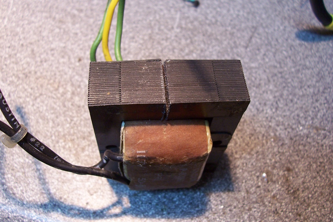

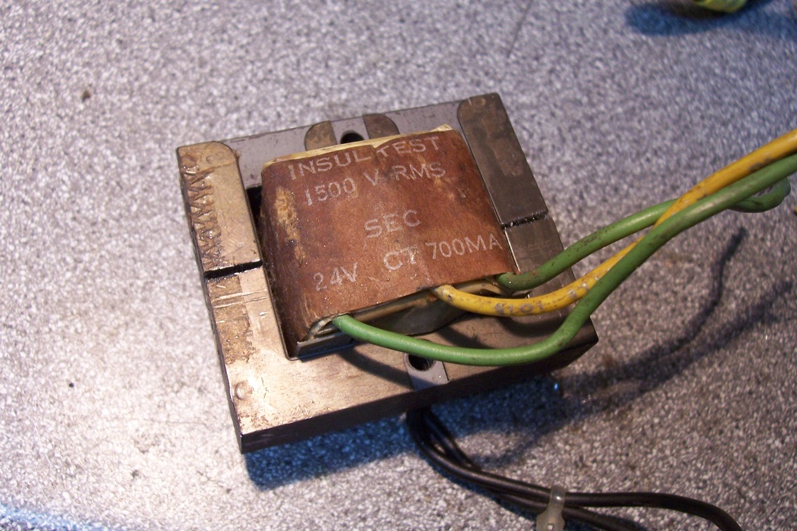

Here are the result of an experiment:
I have gapped the magnetic circuit of a power transformer by cutting two saw grooves in each outer leg.
This resulted in a gap of ~1.25mm average.
The transformer was a 117V to 24V CT, 16VA.

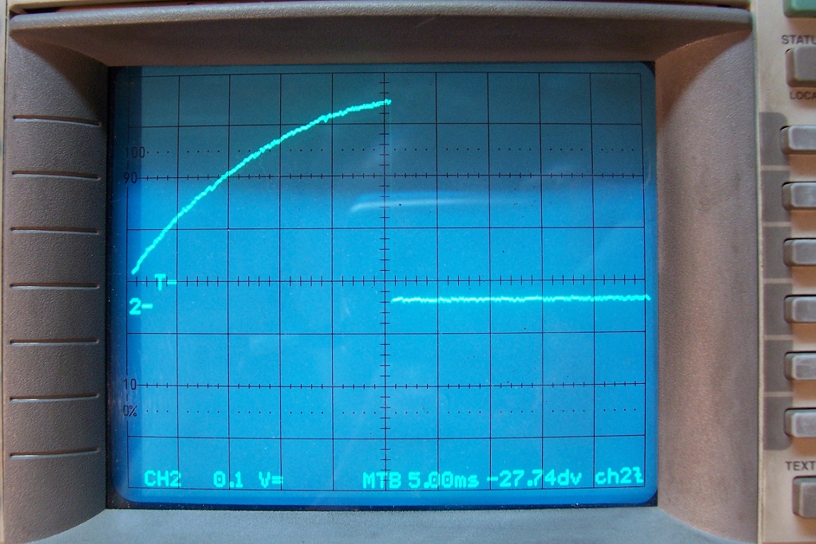

With the cuts, the primary inductance is 650mH, for 39Ω resistance, and the secondary 30.8mH for 3.2Ω.
The oscillogram shows the current vs. V*s behavior of the secondary under power conditions: vertical scale 1A/div, horizontal scale 50V.ms
Even at 3.5A, there is no sign of saturation. The exponential look of the waveform is caused by the 3.2Ω of copper.
Such an inductor could be used in relatively low voltage supplies, whereas the primary could be used in tube circuits
The inductor thus created is far from optimal, because only half of the copper is used, and we can deduce from the waveform that the groove is too wide to be optimal, but it is nevertheless an useful choke.
I have a number of 117V/60Hz transformers that I have no use for (I live in a 230V/50Hz area), and they could be recycled usefully in that way

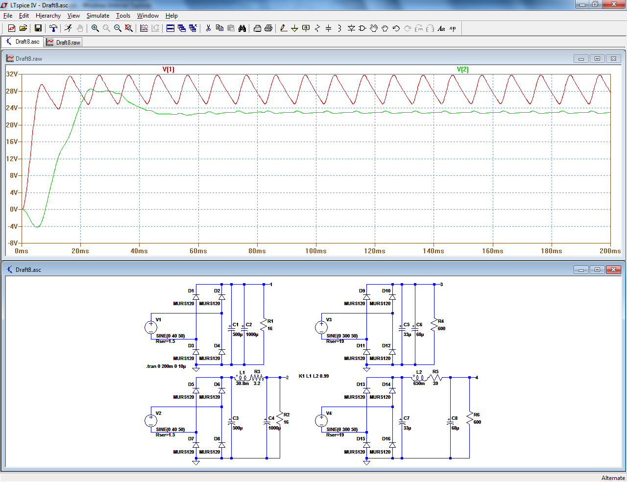

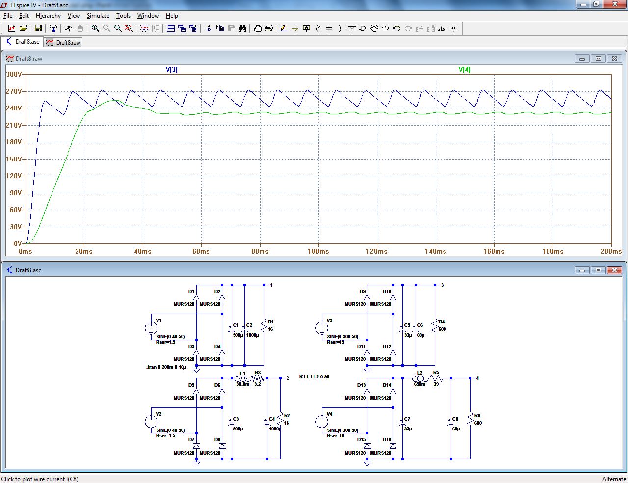

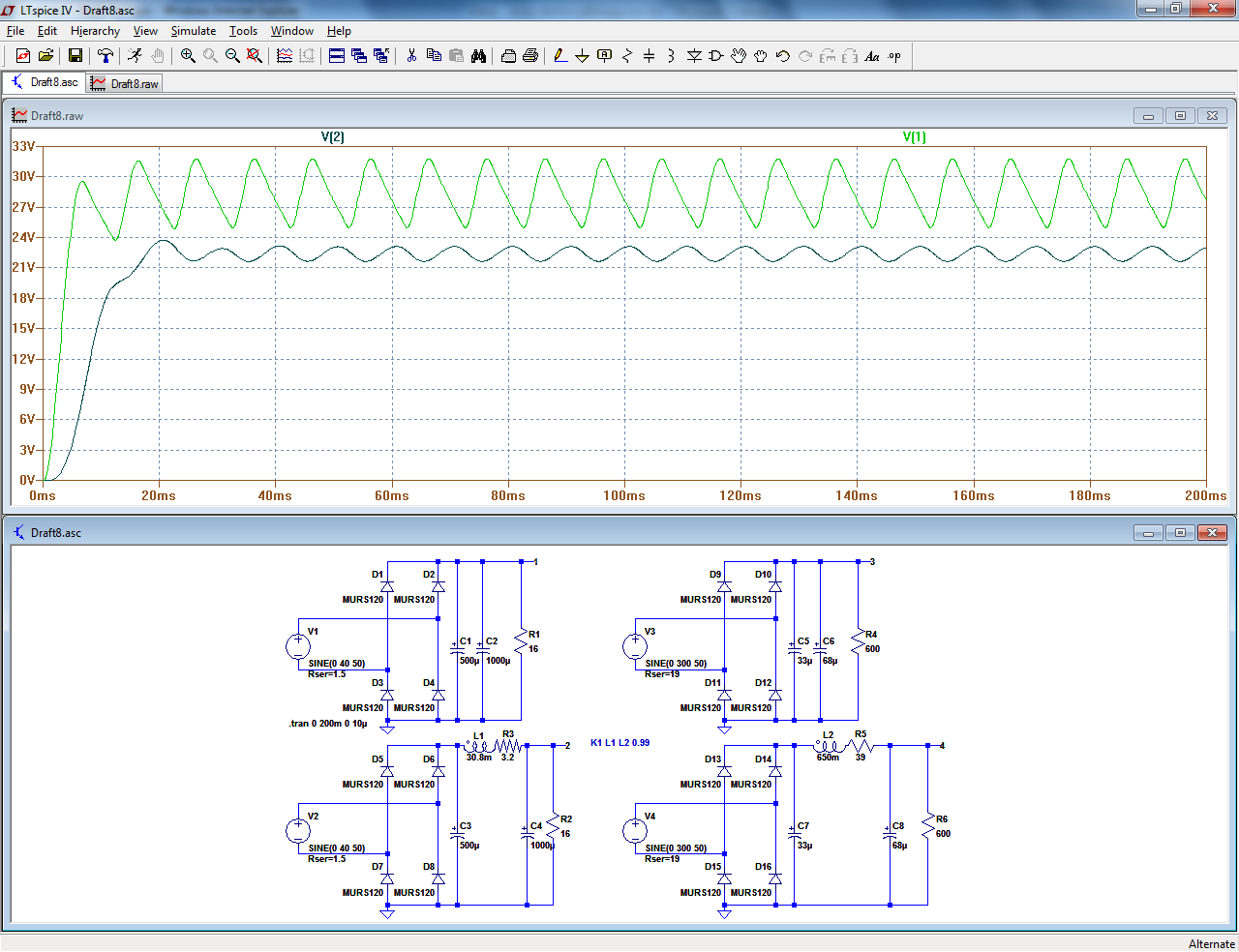

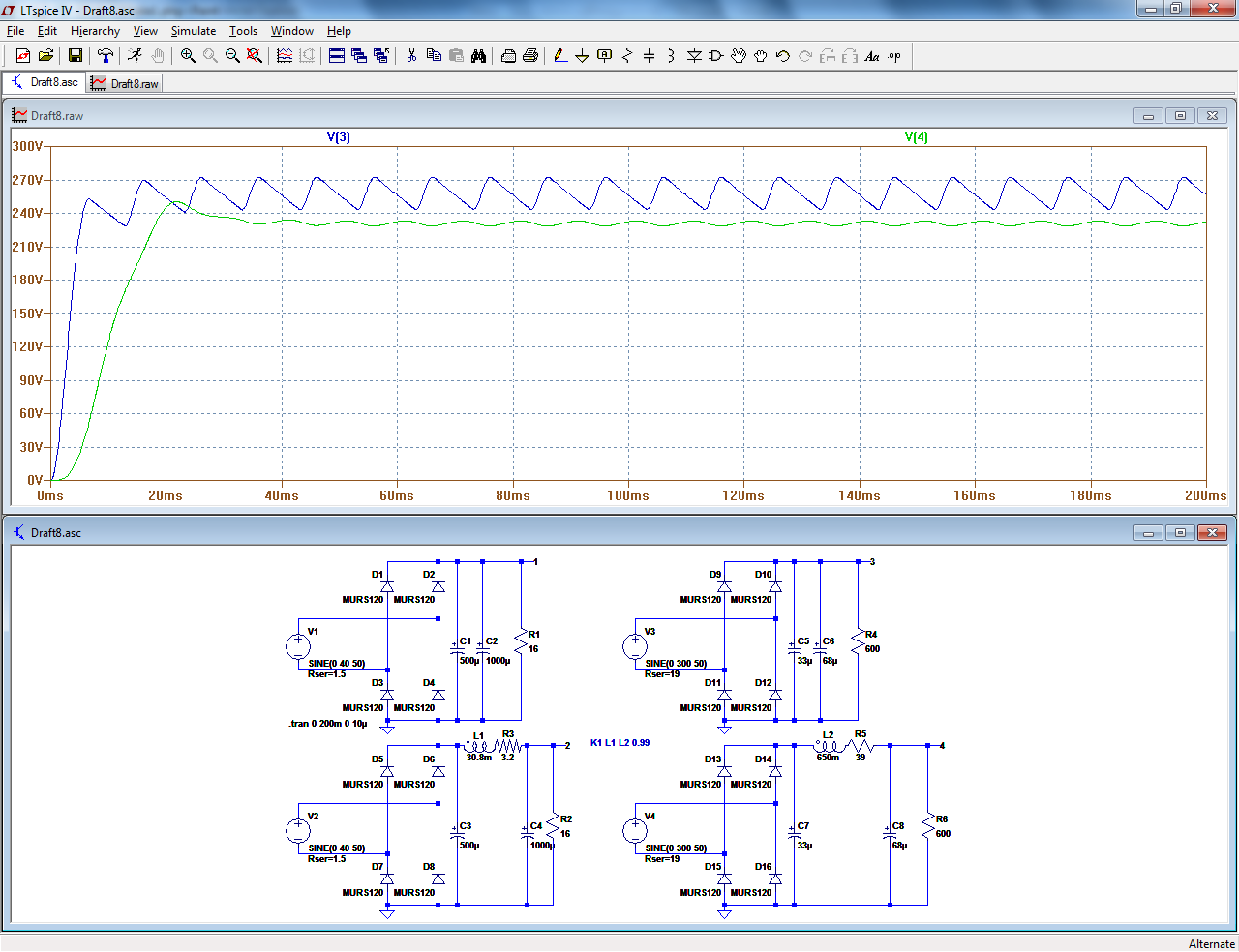

With a bit of cleverness, the problem of copper under-utilization can be fixed:
The two first pics show the low voltage and high voltage chokes, with the improvement they bring about compared with plain capacitance.
In both cases, the improvement is already substantial despite the modest values of the filter components.
But we can go further, and use them both at the same time by applying a "synchronous filtering" scheme: in the next two pics, the inductors are now coupled, as they are in reality.
Not only is the copper fully utilized now, but the filtering quality is improved for both outputs!
Of course, this demands a little bit of care, like matching the ratio and the capacitances, and it is only usable where the current draw on both outputs is stable or vary in the same way, but it could be usable in SE class A amp for example: the low voltage for DC heating, and the high voltage for the anode voltage

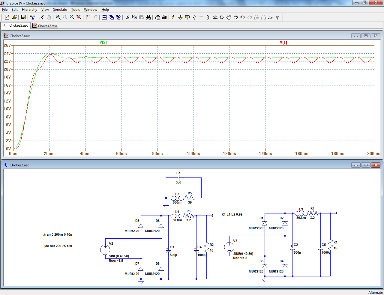

Another way of putting the free winding to good use is to tune it to the ripple frequency.
It would seem to be disadvantageous compared to the direct tuning of the active winding: the losses are doubled and the Q is therefore halved.
However, there are a number of benefits: the capacitor can be much smaller, meaning a stable, Hi-Q plastic type is usable, and the additional impedance introduced by the windings resistance and the leakage inductance avoid the direct coupling of HF crud to the output.
The improvement is nevertheless sizable:
Is it safe running it at 3.5A continuously as i noticed that your secondary is rated at 700mA. How does one determine a transformer's amp rating actually? Is it simply from the enameled wire diameter? I'm curious as i have a spare 1A transformer that i can experiment with. I need a choke for a class A idling at 3-4 A.
No it isn't, but the curve tracer operates at a very low duty cycle, this allows to investigate well beyond the "normal" current of a component.Is it safe running it at 3.5A continuously as i noticed that your secondary is rated at 700mA .
In this case, it shows that it remains perfectly linear, even under severe overload condition. This means that it would be suitable even for "noble" jobs, like in a crossover filter.
