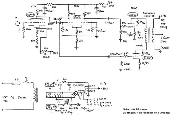

Yes Navin, a good approach. Good DIY tube amps with top iron don't sound tubey in my experience though. They just appear more harmonically complete. I do appreciate the difficulty and cost complexities of achieving such nontheless. That is why I have built Zens and GCs too. Driven by a transparent tube first gain stage can add benefits as you describe. Have done that always. Still I cant overlook the fact that a proper tube amp stands a sonic step higher in my humble experience. Many talks have been trying to explain why. I just remember Hiraga saying that an electron travels in empty space 7 times faster than in a solid. Maybe further analysis is not needed since we are talking distinct physics operating domains. Simplicity was a tube camp weapon too but even a Zen could not compete. So differences must lay in plain physics afterall.
