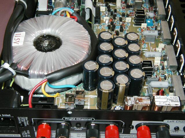

Another example
McCormack Audio Amp. The DNA in the product name is for distributed node amplifier and refers the putting the filter caps close to the output devices.
http://www.mccormackaudio.com/index1.html
From :
http://www.audaud.com/audaud/SEP01/EQUIP/equip2SEP01.html
"Knowing that McCormack is now a subsidiary of conrad-johnson, when the DNA-225 arrived, I was curious to see what the impact of the new ownership would be on the Steve McCormack designed components. After all, Steve had been making amps and preamps long before being acquired by c-j, and his designs have a signature-style power supply: The Distributed Node Amplifier supply. This supply is distinctive in that it does not use the large soup can type capacitors in the power supply, nor does it cluster the supply caps around the input transformer. What Steve has done, starting way back with his DNA-1 in the middle 1990's, is locate the supply caps (smaller ones) right next to the bipolar output devices. That way, when the output device needs extra energy it has a low resistance source right next to it."
From :

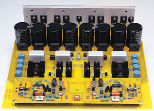

and yet another one
The DMA-150 High Resolution Amplifier from Spectral Audio
http://www.spectralaudio.com/dma-150.htm
I think someones knowledge about transformers extends to the subject of capacitors as well..........
Fred Dieckmann
Yes, inducters in parallel will behave as resistors in parallel but this is parasitic inductance which is part of the capacitor and its rule is not so simple particularly when the capacitors have different (non-linear) ouput curves. I say it might be worth a measure or two before making blanket statements but as I said earlier, the forum may choose the methodology that suits them. As for my knowledge of transformers, fortunately, it grows daily even without your contribution. Nice pictures.
