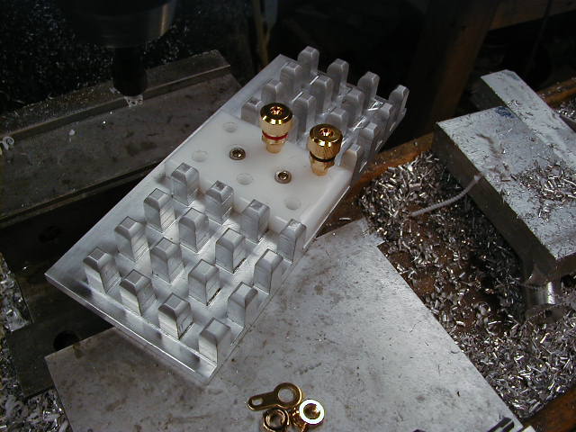

GC heatsink
Do anyone know of anywhere in the UK where I could obtain brass/bronze of a size (approx 5cm x 2cm x 15cm ) to make a heatsink for a GC, similar the one the illustrious PD uses in his latest submission to Brians GC gallery?
All of the places I have tried only do bar upto 7mm thick.
Peter

Apologies for my lack of clarity in the question. Trying to do things from memory and not checking ones facts can make you look an ***.
In comparing patek3.jpg and patek11.jpg in Brian's gallery, it looks as if in 11 the lefthand piece of zebrawood has piece of silver metal of triangular cross section running along it, with the holes for the caps in.
Perhaps I am mistaken and it is just a trick of the light.
Simon
Simon
I sprayed the insides with conductive paint. I left those triangular spots (painted) to make a contact with front and rear panels.
