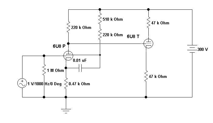

Another variation for your consideration - I've seen a 6BL8 (ECF80) triode/pentode used in a well regarded pre/line amp.
The pentode section was used as the cathode follower. g1 + g2 drive to the CF with the g2 drive via the triode section also wired as a cathode follower. g1 and g2 drive same phase with g2 drive AC voltage approx 30% of g1 drive. Now my first impression of that is that is a bit "weird" - would'nt that represent positive feedback to the screen?

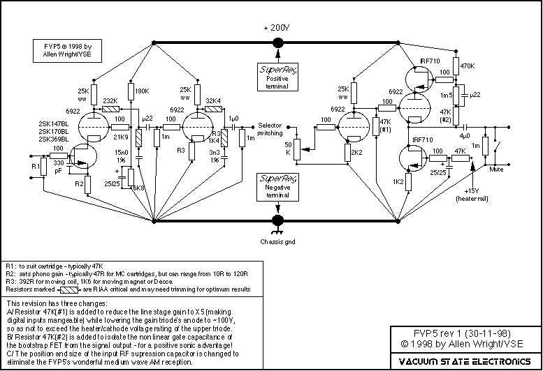

Sounds like a bootstrapped circuit which aims to reduce the input capacitance of the cathode follower by feeding the output signal back to the screen grid, so there is less (signal) voltage difference between G1 and G2. It sounds similar to the cascoded version popular with Allen Wright; http://www.vacuumstate.com/images_upload/gross/fvp5_rev_1_s.gif
see also "An AC cathode-follower circuit of very high input impedance", J.R.Macdonald, Review of Scientific Instruments, Feb 1954.

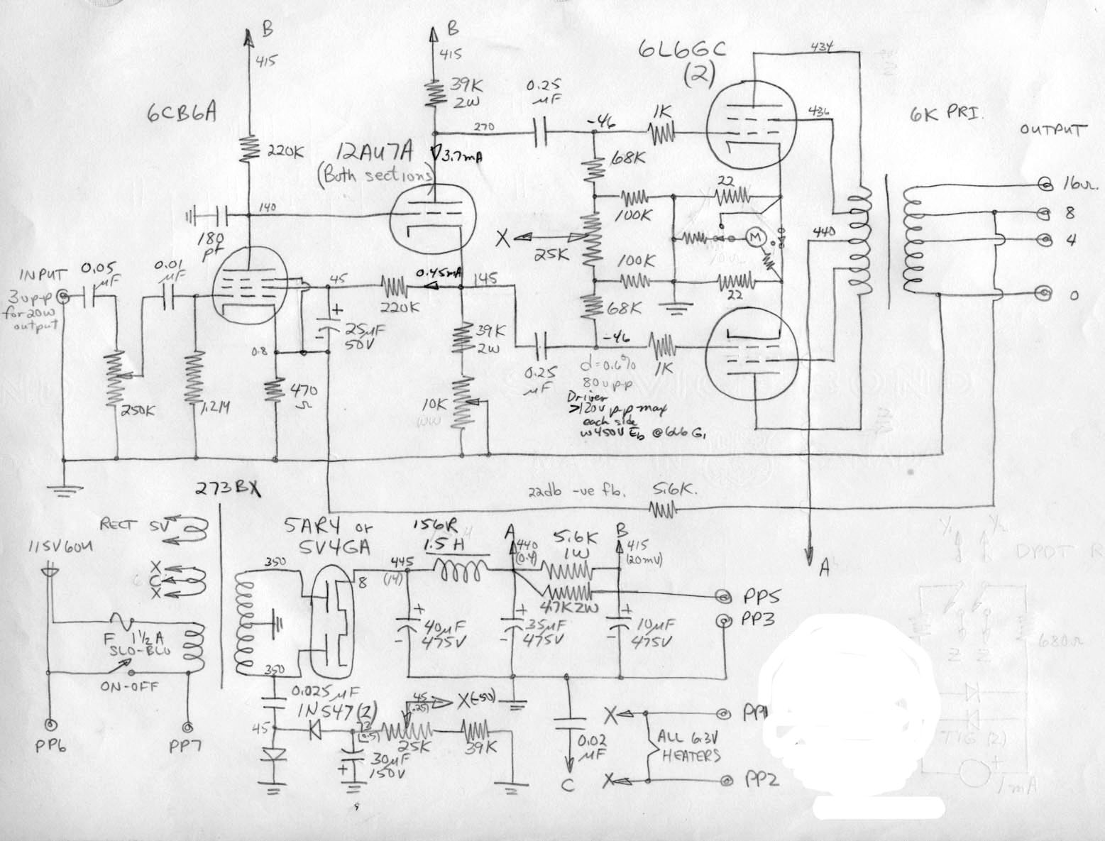

Ian, which circuit was that from? I've never actually seen the valve equipment schematics

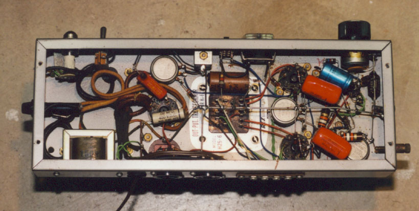

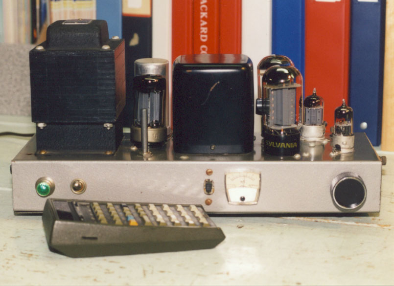

That is a new 'old' cct. When I still had hair I used it in two PPUL 6L6GCs circa 1960. Still have them here on the shelf, still working. Some caps had to be replaced over many years. The OPTs are noname from Japan but quality, they came with freq response traces on graph paper.
And also appears in the last RCA Receiving Tube Manual RC30, p695.
The cct is a form of DC NFB & helps stabilize the tube pair. But the cct it replaces is just as effective, the pentode G2 resistor provides a large DC NFB that stabilizes the OP same as the cathode resistor.

The only doc I have is a pdf I found on the net years ago. It has a rather scruffy schematic but it looks genuine.

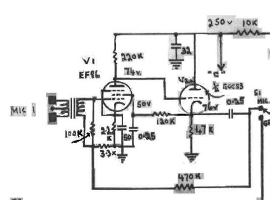

The 1st triode is an elevated CF driving the 2nd triode connected as a thinly disguised Baxandall tone cct.
The EF86 has DC feedback to the screen from the following CF.The only doc I have is a pdf I found on the net years ago. It has a rather scruffy schematic but it looks genuine.
