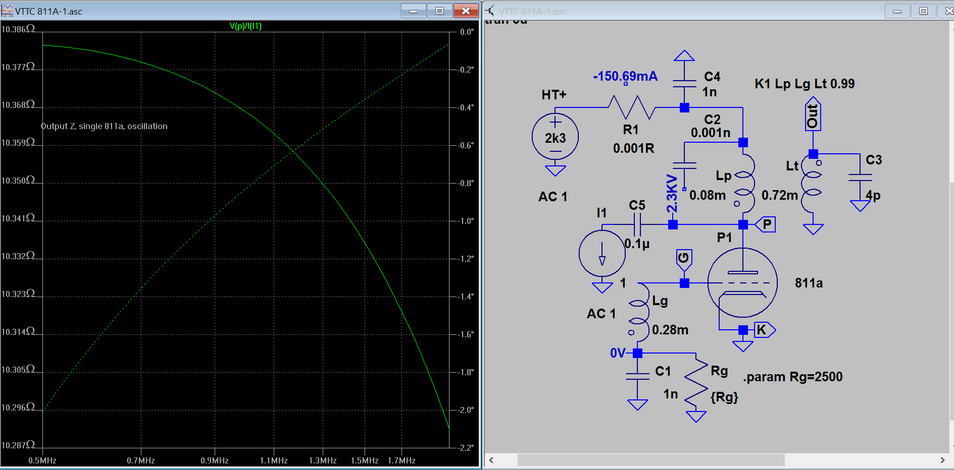

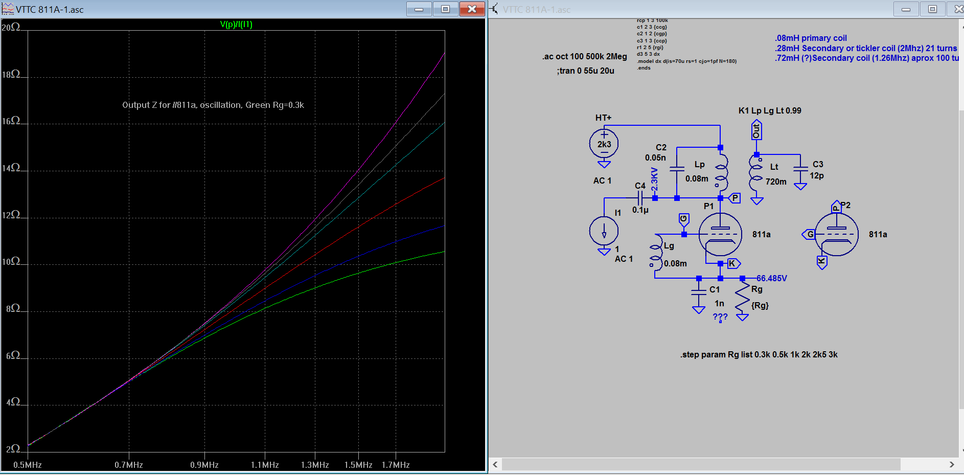

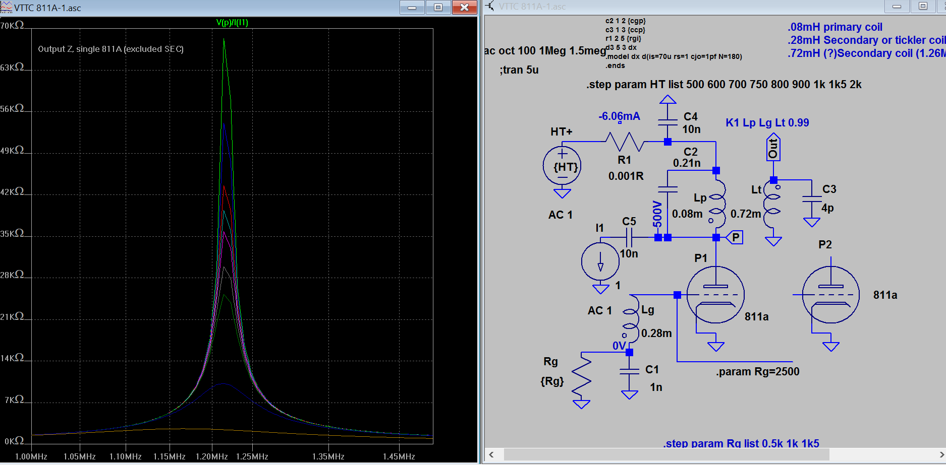

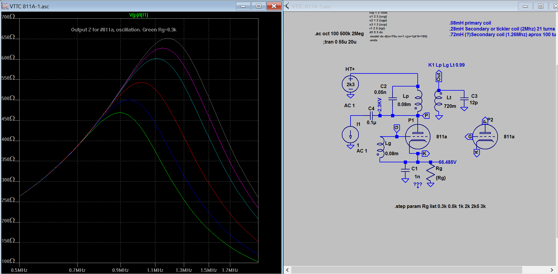

Here are of output impedance plots for //811a VTTC, the higher the current the low output Z.
Glad you like the Class C sim. Because the gain of 6c33c is only 3, is hard to get oscillation, maybe like you say have to use additional tube to boost the gain to 100-200v phase splitting, cap or transformer coupling is fine. I see if I can find suitable tubes, any suggestion?

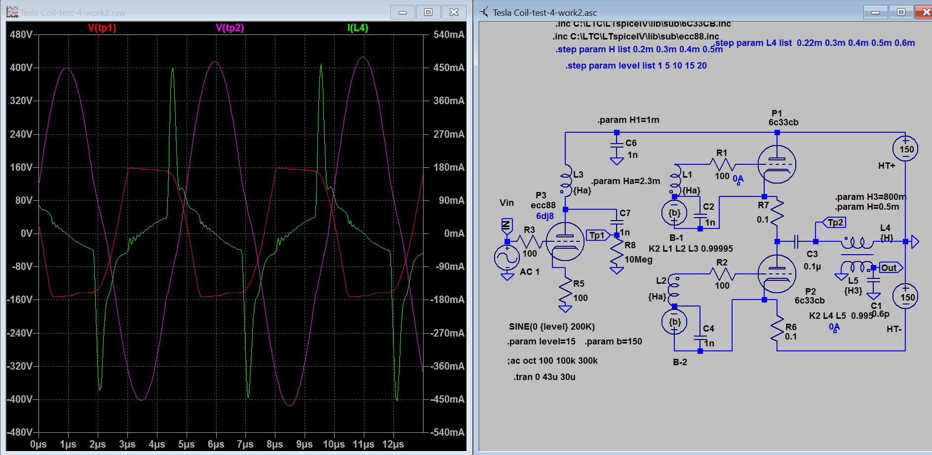

Here is the completed VTTC amp. ECC88/6DJ8 is a high freq tube, should be good as driver. The square off waveform helps to limit the current in amp, as well the max. output. Transformer is chosen so balance drive the totem pole is easier to achieve, the coupling between 3 coils can be very tight and seal if necessary.

Here are plots for corrected schematic.

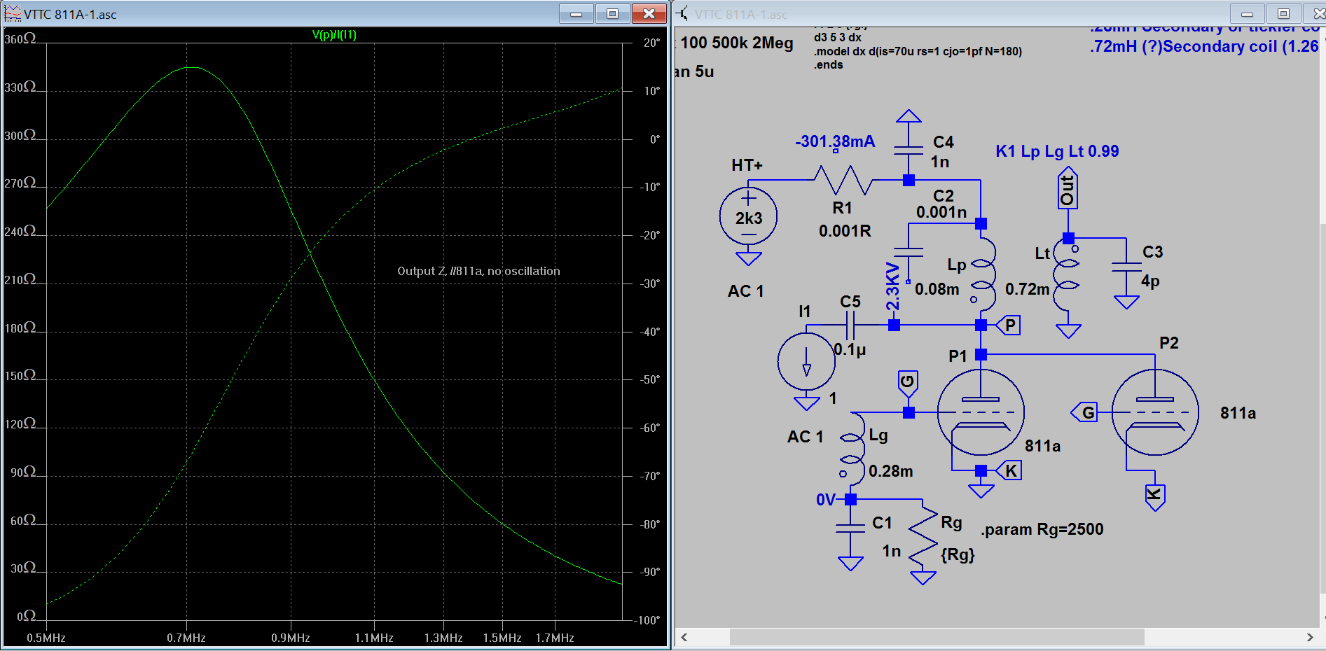

Im curious what your interpretations of your 811a simulations of it are
You mention in your graphs things like 'no oscilations' with phase angle etc. I was wondering if you could elaborate on these graphs a bit because I have had a problem where oscillations would eventually cut-out the more voltage I give it from the Variac. (resulting in drawing of too much current) I believe it happens around 200 or 300 volts at the plate. The variac feeds a microwave oven transformer that is voltage doubled. I have a current probe monitoring the current going into ground so I can see the wave form when it decides to collapse after a certain point when turning up the VAC.
Not quite sure if its an impedance missmatch phenomenon or a damaged something.

Also in your last simulation with the 6c33c, I had a couple questions
(1) what is the amount of grid bias you set here?
(2) you mention that the square wave from the first stage limits the current, is that because the ECC88 is clipping? Im cool with that style of current limiting, but what if I want to push the tubes harder (1amp example), does that mean the driver tube choice needs to be able produce more voltage swing?
Disabled Account
Joined 2013
"Also in your last simulation with the 6c33c, I had a couple questions
-150v each tube
(2) you mention that the square wave from the first stage limits the current, is that because the ECC88 is clipping? Im cool with that style of current limiting, but what if I want to push the tubes harder (1amp example), does that mean the driver tube choice needs to be able produce more voltage swing?"
Yes, yes.

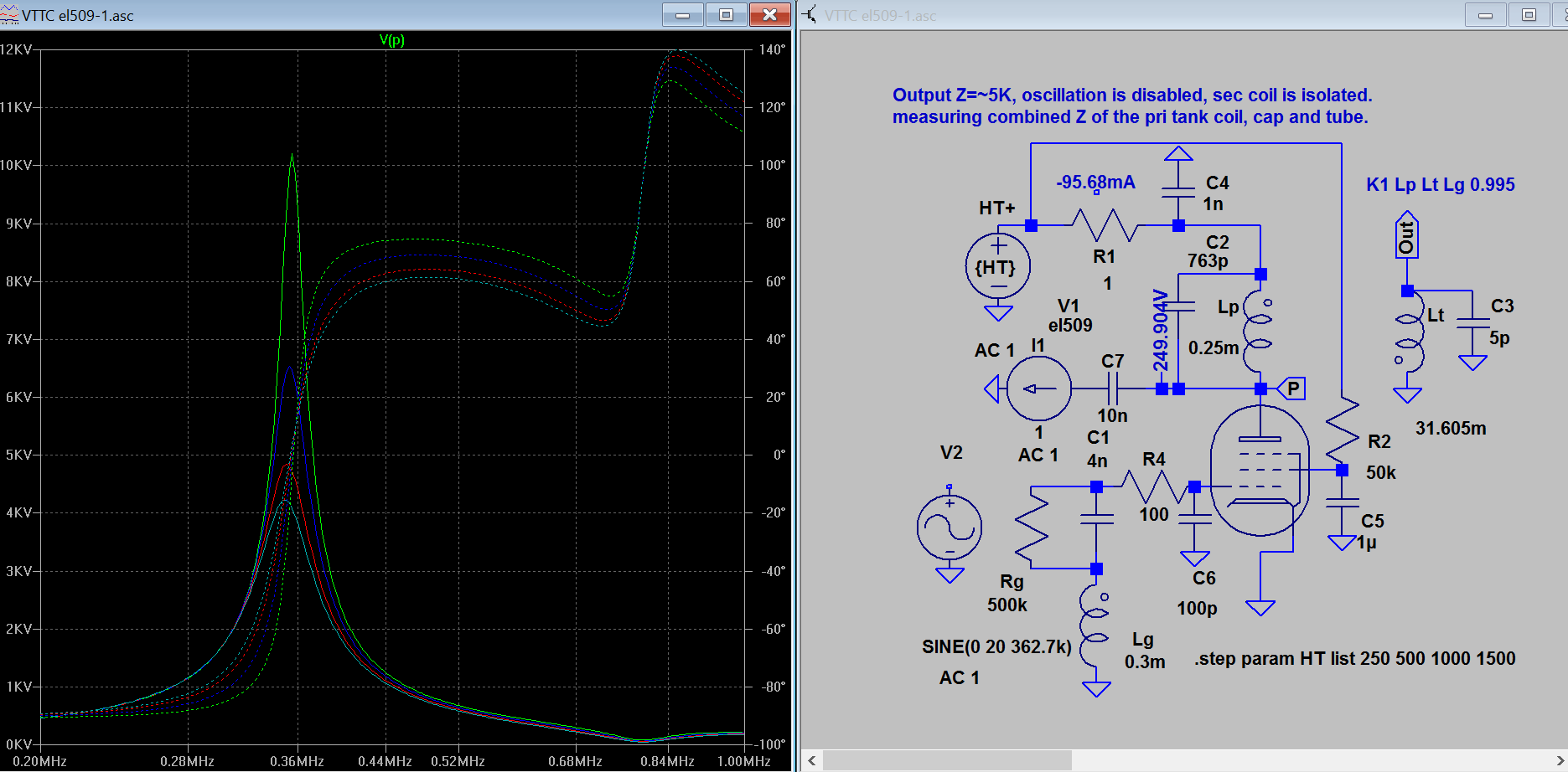

"Im curious what your interpretations of your 811a simulations of it are
But for the most part, I've been able to oscillate the coils reasonably when staying bellow that point on the variac."
811a is a triode, so I think the output Z is much less than that of the pentode, so the output Z looks reasonable. When it say "no oscillation" simply means the coupling in simulation is disable, sec coil is isolated, so measuring combined Z of the pri tank coil (exclude sec), cap and tube. The peak value of Z also is where the gain is high, I see that the peak for single tube is about 1MHz, but the peak Z for // is about 0.7Mhz, so I think there is a mismatch there. You should see that the peak is very near to freq you operating. Second, regard the relation of power supply voltage in relation to gain and output Z, the more current draws, the less is gain, so if you increase the voltage there is a point where the gain drops until oscillation stop. I attach a plot of el509 plot from 250 to 1.4kv. Can you also lebel on your schematic exactly the component value to see if I can plot again more accurately, and hopefully like you said it's mismatched.

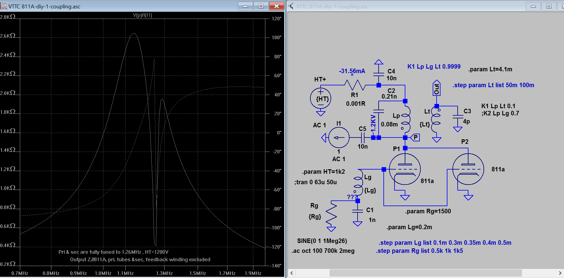

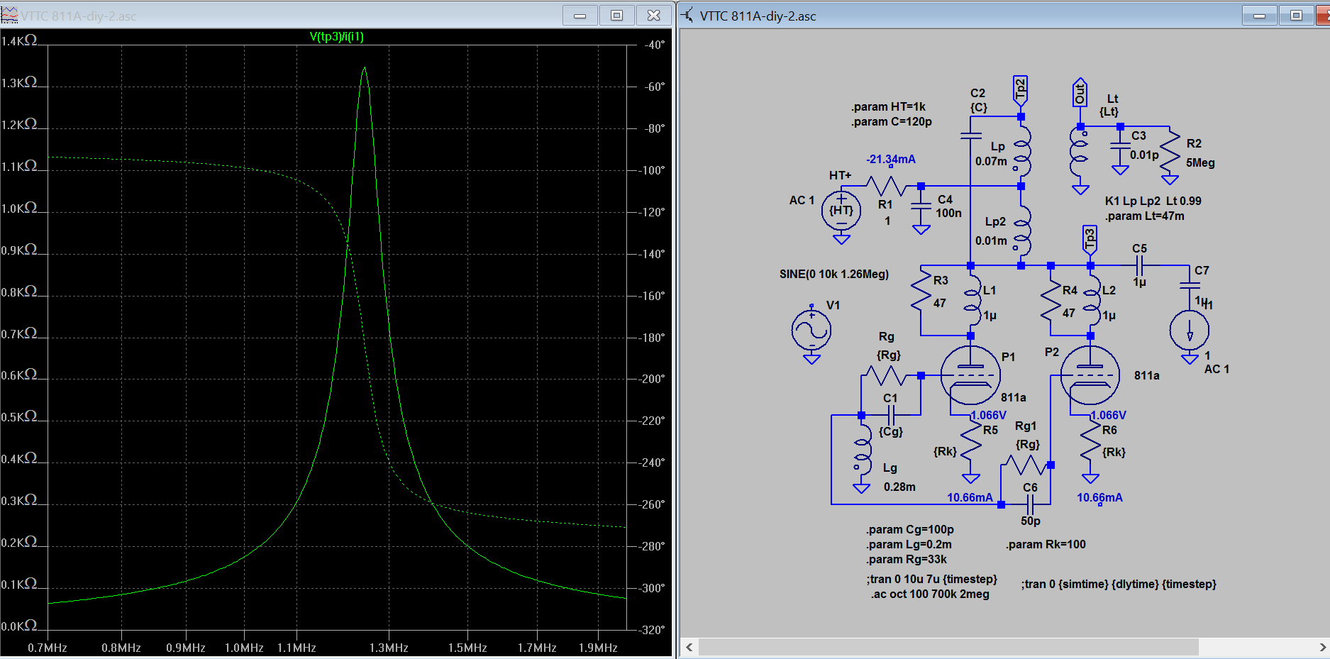

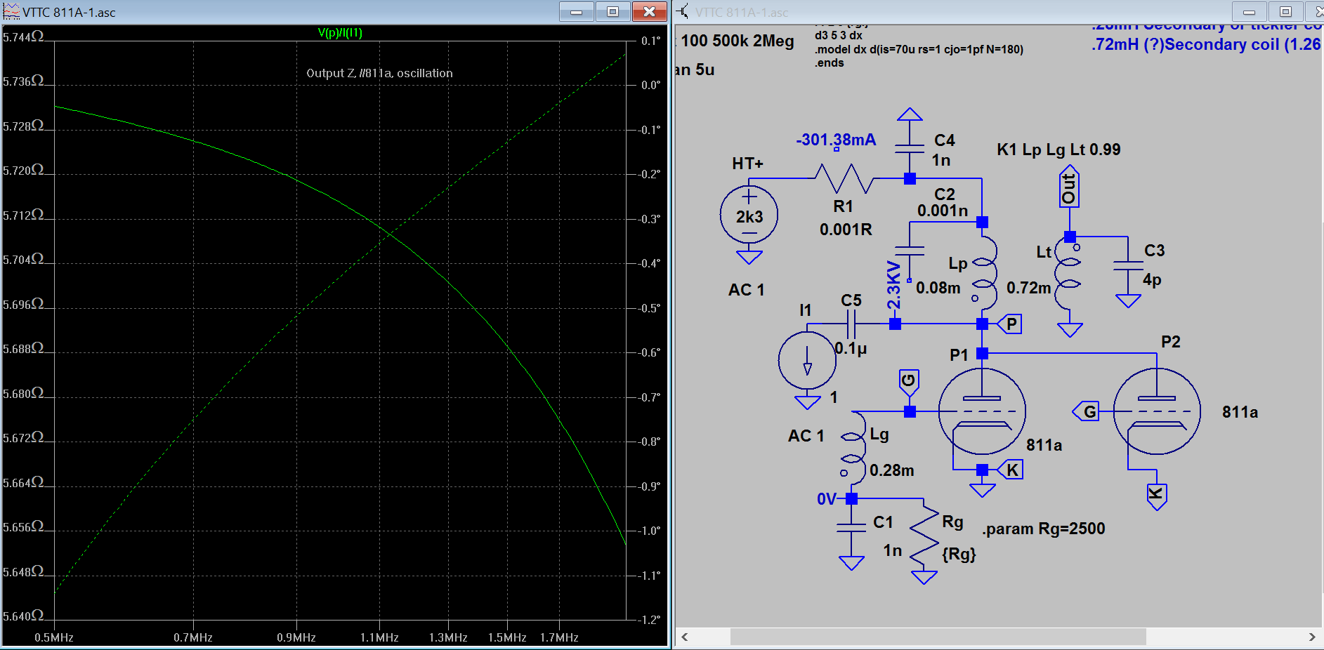

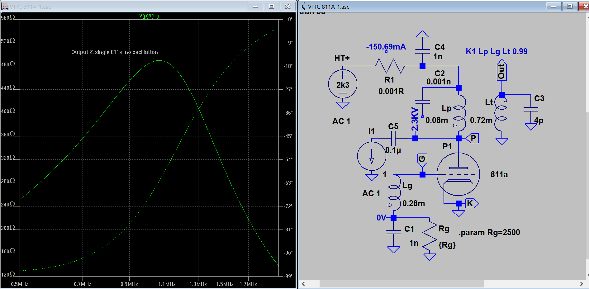

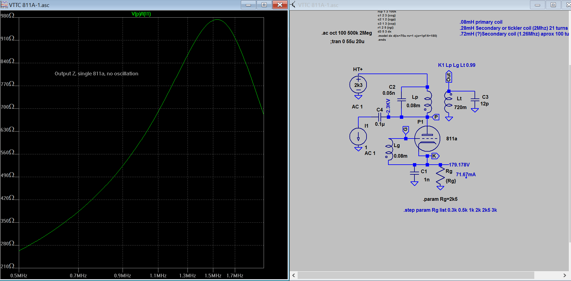

Here are the plot as I now tuned the primary using a single tube, then plot again with 2 tubes, by connecting C2=2.1n // with pri coil, the peak freq does not vary much except with HT is above 1kv but the response width is wider and Z (max peak gain drop form 96db to 82db=14db HT=500V) drops with 2 tubes. It appears to me Z=5k, HT=1kv is the lowest you can get, you can compare see how.
Disabled Account
Joined 2013

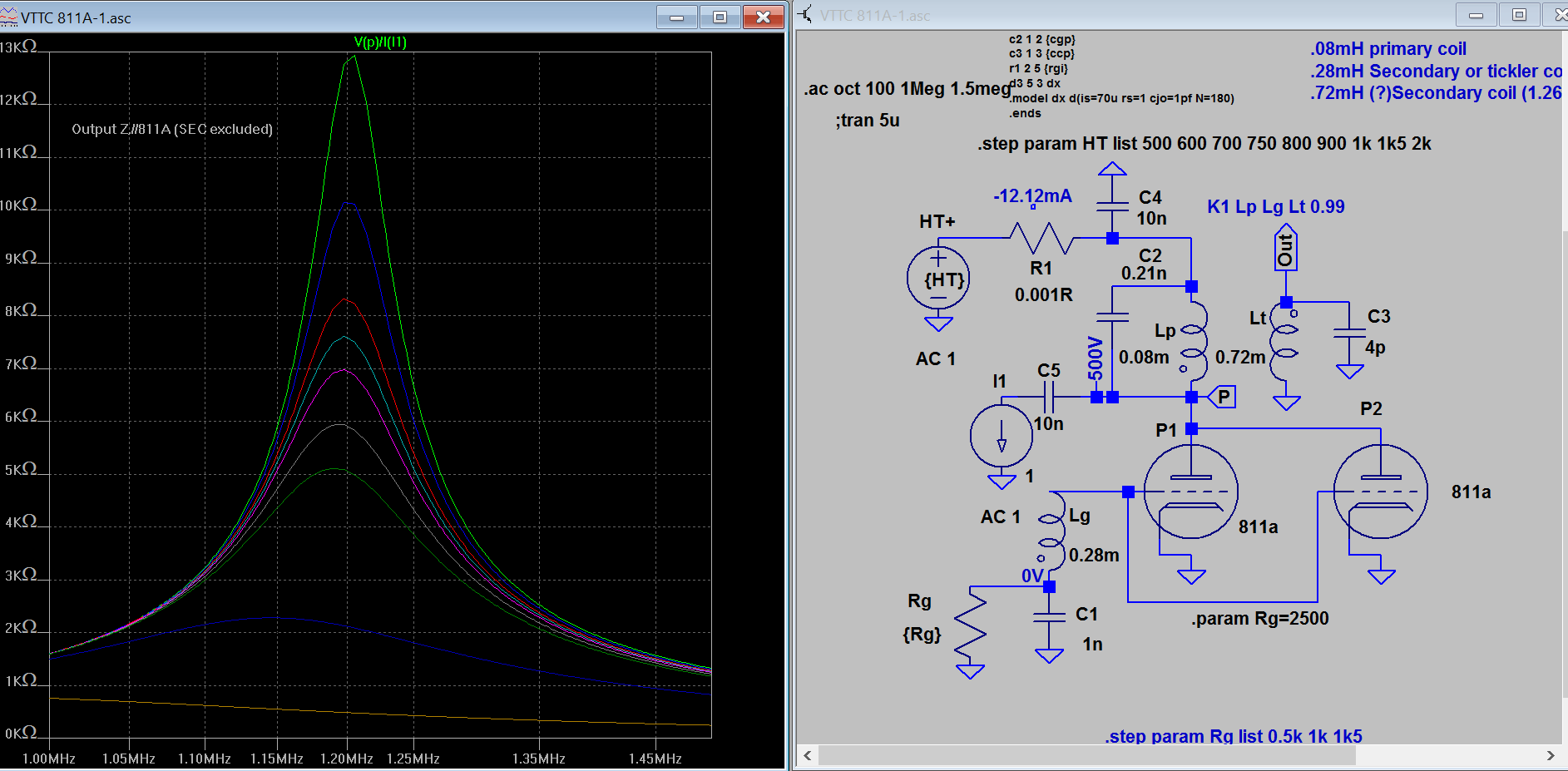

Here are plots of fully sim tuned plots. The pri and sec are fully tuned (to 1.26Mhz), then pri is coupled to grid winding, sec winding is excluded, found that the freq peak shifted to the left below 1Mhz. However when all winding are engaged, the freq peaks at correct freq. There are very sharp spike on left on impedance plot, they have to do with amount of couplings between the winding, too high coupling has a severe impact of output impedance, and has to try many value before optimal result is obtained.
Interesting to note that the peak Z value of the Pri Tank Circuit is greatly constrained by the Tube choice. This sounds like it leaves a narrow window of effective Frequencies I should design the coils to based on the tube of choice. I remember reading on Steve Ward's site of this concept on getting the sweet spot for reactive power in these designs.
The 6c33c designs you have been modeling, do you think that by having the low gain & low impedance properties, this design would perform better over a broader/more agnostic range of frequencies? (less prone to impedance sweet-spots for efficient usage?)
This sounds really important, but im not sure I have a full grasp around why more current produces less gain to the point of oscillation stop.

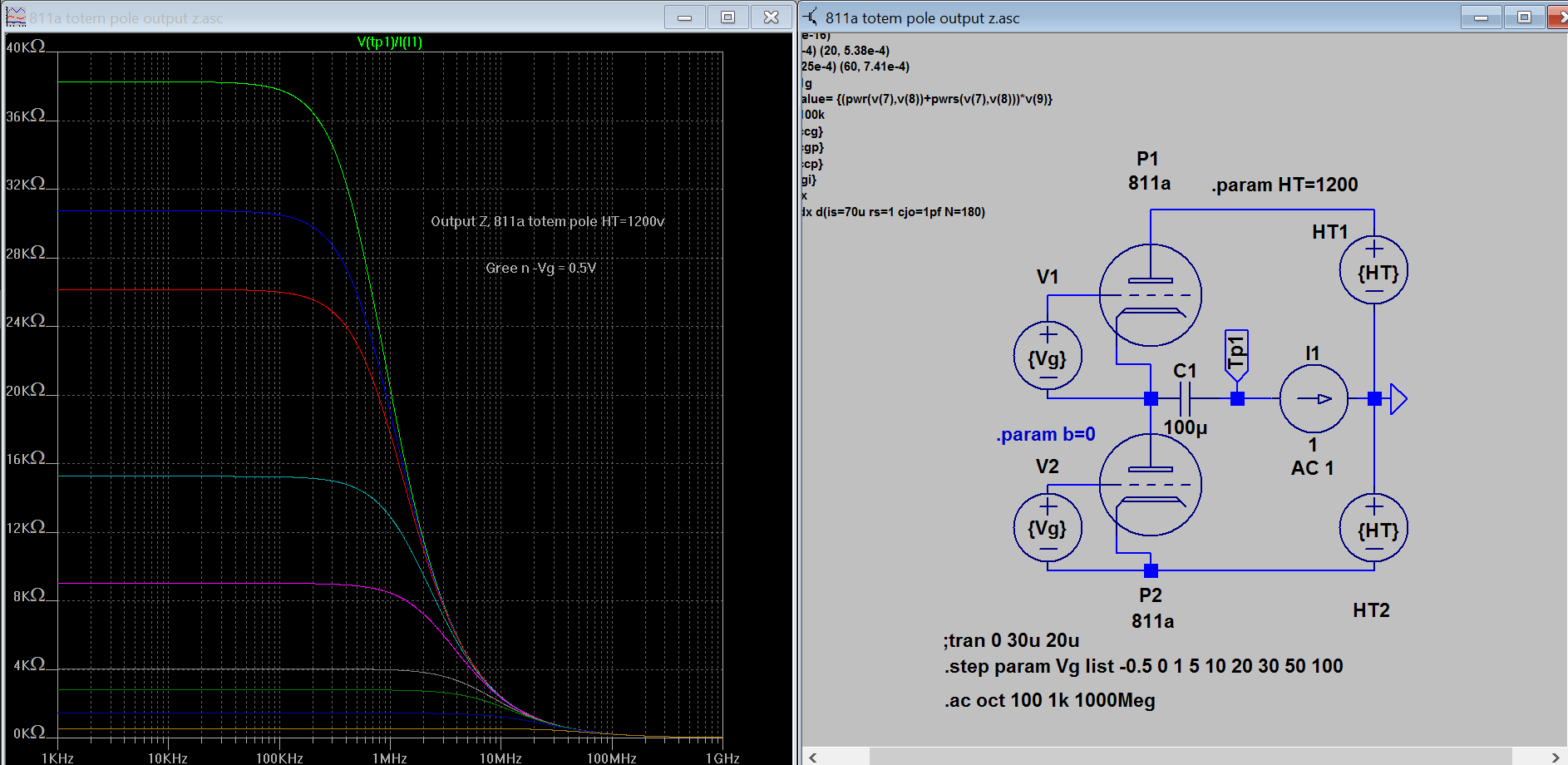

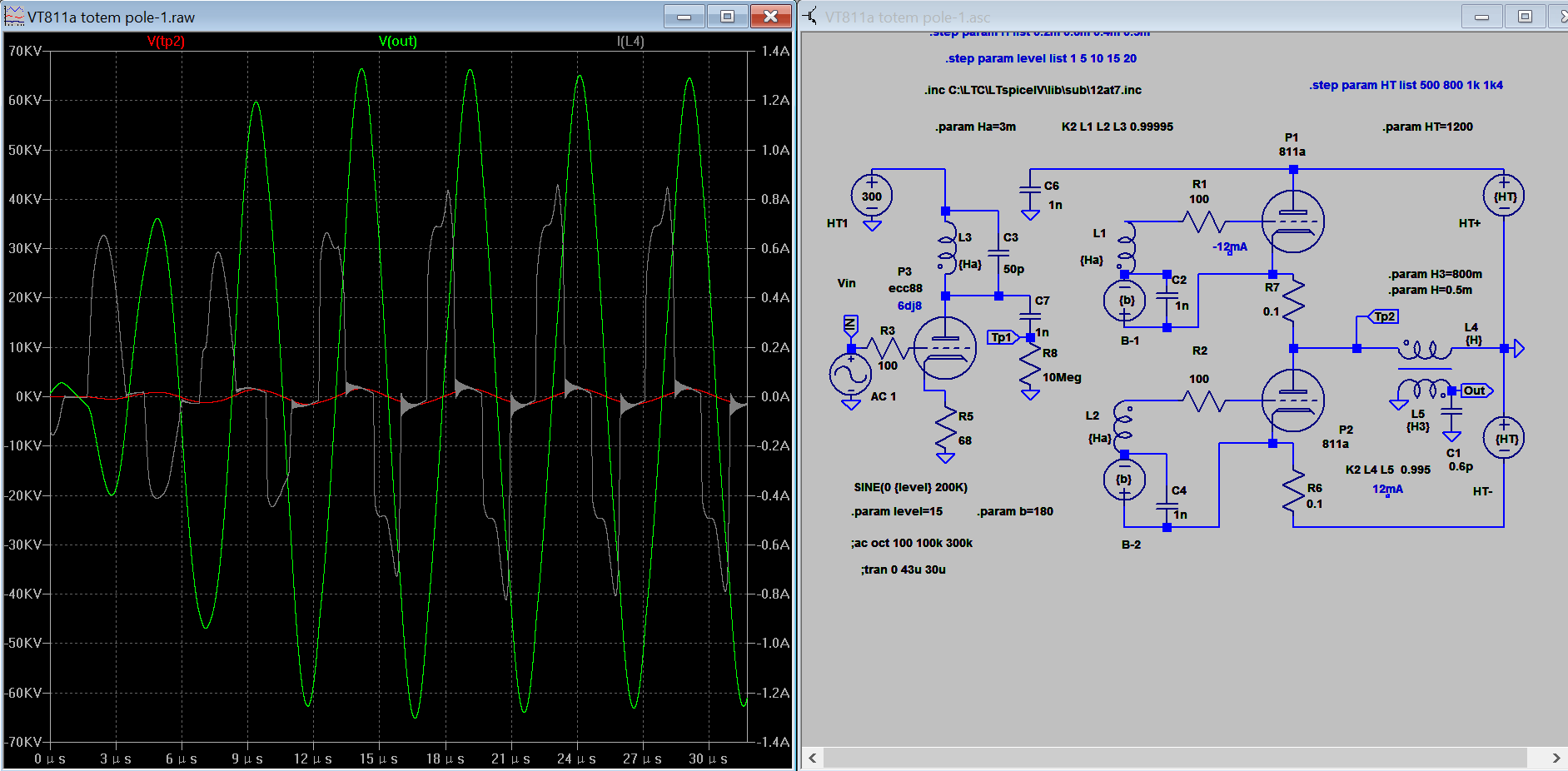

I'm now try to replace 6c33c with 811a, run HT 1kv or so. It works with bias at -180. With the same coil, the pri is more than 1.2kv and 70kv on sec, freq 200kc. I'm still working on it. Unlike 6c33c, 811a is normally bias at 0 to +100V, if bias at -180v, require at least 200V drive to make it conducts. I raise the HT supply for ecc88 so it can output 250V now.
Interesting, the totem pole with the 811a.
Pros:
can handle higher voltage swings inside the primary
No need for primary capacitor & tuning?
Similar wattage performance to 6c33c?
What are other advantages that this SSRP like arangement gives us
Any cons?
like the tube impedance frequency mentioned earlier?
Will that hamper the ability to parallel the 811a stages?
Pros:
Any cons?
I just realise the output is just driving a tuned circuit which is of very high impedance, and therefore the output is low. Should use a transformer of 600 ohms and 75ohms for 811a/6c33c, and because in class c and by adding a bank of tubes for more power, With //tubes, the current may not be even among the tubes and impedance drop too low if too many //tubes. I think both should use matching transformer rather than drive a tuned circuit directly. The impedance of the tuned sec of TC is more than 100M, and about 45k after step down which still very high load to drive. So I think better if you step down to 75 or 600 ohms or whatever impedance matching the output. But this load maybe very good for some tube topology such as //811a you get 170W?
A matching transformer at the output? Saturation? Core losses at higher frequencies?
Also, too high of an impedance to drive is not ideal for the totem pole design?
I always thought that there was a rule of thumb that driving a higher impedance load is always a better choice (perhaps in standard setups, not totem pole)

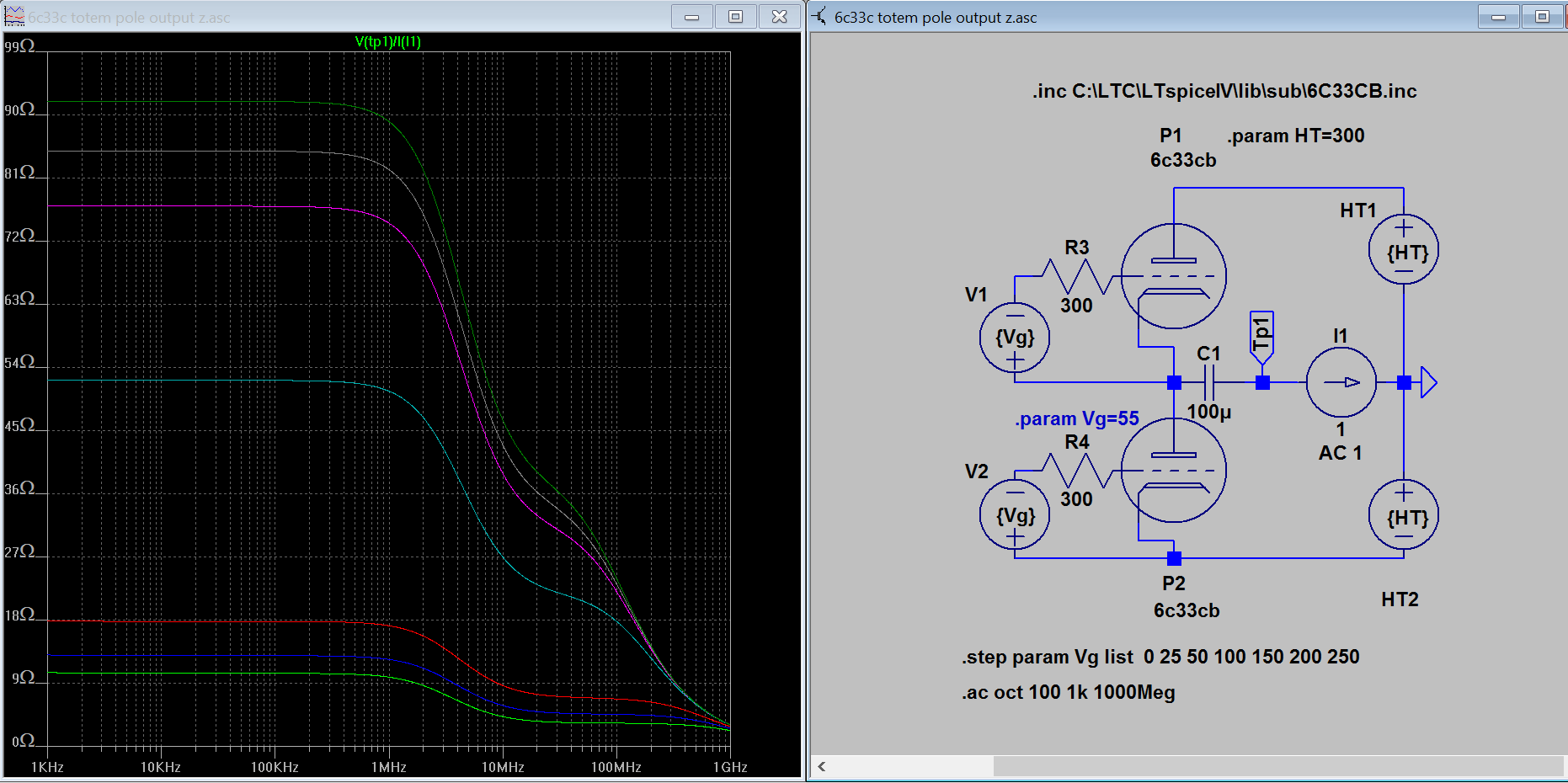

"A matching transformer at the output?"
I should rephased that as you need multiple tap on pri coil rather than just one, this makes thing so much easier, to check if particular tap happen to work better. From the plot you see why 100 ohms is a good load for 6c33c at 400V, rather 50k. The plots for 811a is much higher it's similar to a pentode.

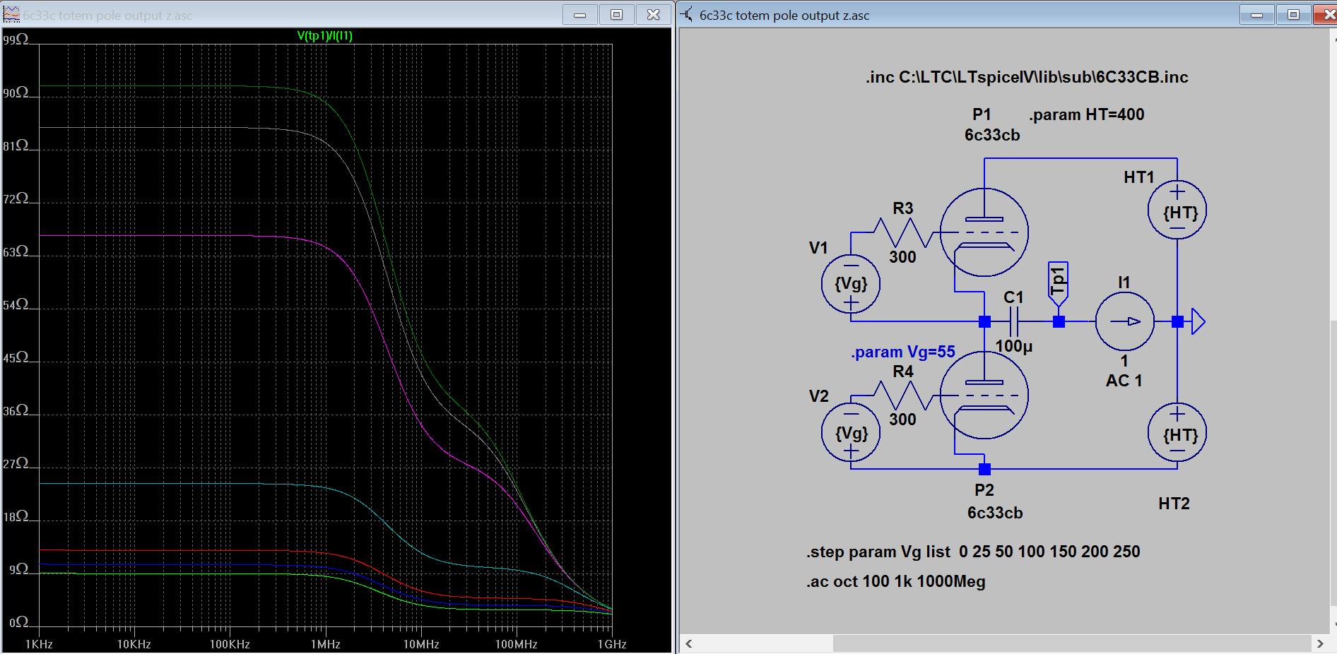

A 50k is better load for pentode or transmitting tube like 811, 813 etc, again multiple tap will help to select the best match.
I seen the video. How about you tap the pri coil by connecting the clip a couple of turn less, not full. It's also appear to me the coupling is too low such that the sec is not fully excited, try to experiment with distance of 2 coils after you change the pri tap.

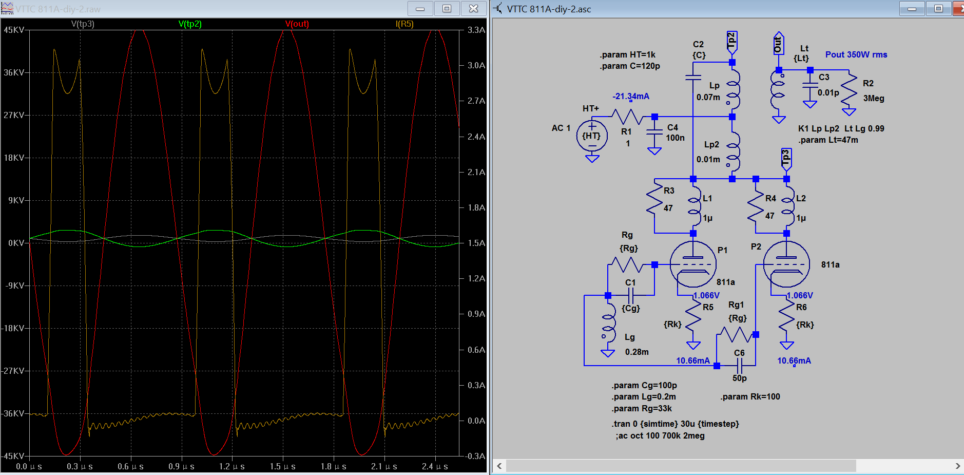

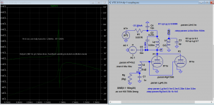

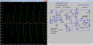

Using the values of components supplied, I put them in the original sch. Found the waveform is no where near sin wave, more like very distorted short impulse of very high voltage. Something wrong with the grid leak circuit. So I redesign almost completely, separate grid leak and cathode resistor which limit the max. current of each tube. Added the tap in primary coil by splitting into 2 coils. The plates now has load about 1.3k, depends on secondary load. The result looks good, the waveform look good. Let me know what you think.
Im curious to see this bad waveform you are seeing in your simulations… could this possibly be the area for my dilemma?
I also noticed that in your simulations that you put a smaller 50p bypass capacitor at the grid leak resistor as well. Do you think that the shared grids were causing asymmetric loading in your simulations?
In your post here, you show some different tapped turns in this impedance graph for the totem pole setup. Im having a bit of a hard time comprehending how the lower impedance tap will benefit the current draw… Maybe I’m conflating my short circuit like results (in my videos) with what I’m looking at here with the totem pole setup.
