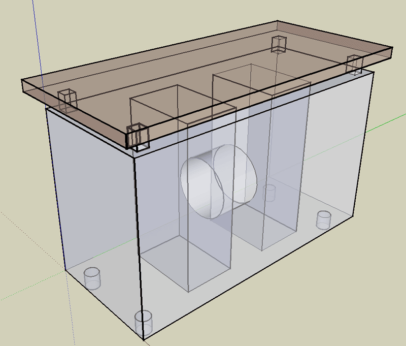

Here is a sketch i did of a dual-push-push (push-push to reduce box vibration) subwoofer/table.
All sorts of variations on this concept are possible... i probably would have built one but i couldn't figure out how to get cabling to it innocuously.

Just a concept at this point... I have contemplated extremis & SDX7, but if you wanted it to be a true subwoofer, you'd need to move up to a larger driver that goes lower and can move more air.
Access to the drivers and construcability is a problem that would have to be considered. In this respect even trickier are the ones that are push-pull-push-push isobarik. Probably have to treat the multitude of drivers as a removable plug-in unit.
If i build one it will probably look more like this... the floating table top would need to be removable for driver module assembly.
dave

I like the coffee table idea. How about a design where both active and passive are facing the bottom?
A coffee table of size approx 3ftx3ft can house 2 15" along the diagonal.
