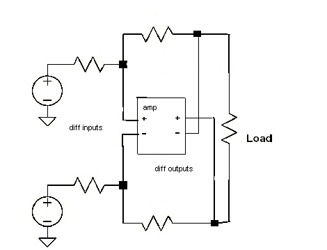

Dear Nelson, may I ask you
--does USPat 05376899 cover the amplifier with balanced inputs and balanced outputs, as shown?
--You wrote that it will cover two CFB amps connected as bridge http://www.diyaudio.com/forums/attachment.php?s=&postid=387359
But will your patent cover this circuit if R1=0 (no coupling resistor at all)?
Quote: “An amplifying circuit having identical inverted folded-cascode amplifier stages coupled together through a coupling resistor at the positive terminals of the respective stages”.

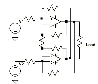

dimitri said:Sorry, and the last one. Will your patent cover two VFB amps connected as bridge?
Depends on what's in the chip, but probably no.
dimitri said:--does USPat 05376899 cover the amplifier with balanced inputs and balanced outputs, as shown?
dimitri said:
Probably. "0" is a valid resistor value, and as we know, there
is no such thing as true 0 in such a circuit anyway.
(As Mikek and Steve Eddy would be happy tp point out).
Also, I should point out that this might still represent a more
general case than can be successfully defended given the
amount of narrowness that the patent could be viewed as
having. The TI THS4131 is the closest match on record, due
to the use of folded cascoding, which is specifically described
under the claims and has no precedent. The 60's Hadley
amplifier shows elements of SuperSymmetry, although it does
not appear that Hadley recognized what he had, or he would
have said something about it. Nevertheless, it exists as at
least one example of general prior art.

How can I calculate the value of resistors ?Sorry, and the last one. Will your patent cover two VFB amps connected as bridge?
Attachment: npvfb.gif
This has been downloaded 26 time(s).
