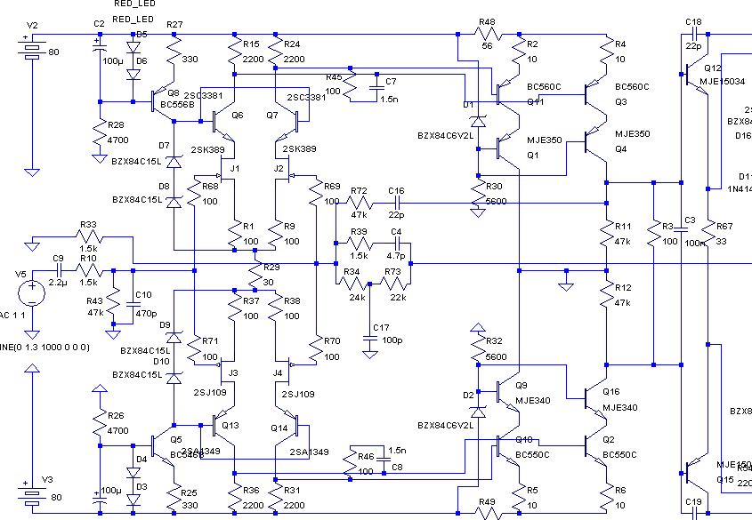

amplifierguru said:Hi Benson,
Your Q1,9,10,11 don't do anything. You don't need them.
R11,12 are best removed (anytime) as they just waste gain which could be used for NFB and increase modulation (distortion). They're a hangover from the TIM dreaming.
NFB from the output corrects the worst ERRORS in most amplifiers - the output stage ones. You don't wan't to be listening to these as Thanh says. And they're load dependent so variable.
Greg
Hi Guru,
I think this is the four'th time any one says these aren't necesary. Please take a good look at the shematic. Together with R48 and R49, they form a diff VAS.
See post#8
http://www.diyaudio.com/forums/showthread.php?postid=799378#post799378
In the attachment, you can see the latest version (NFB).
Greg
Benson has already answered.
But this misreading of schematic has to do with voltage supply being to the left.
And resistor feeding VAS in horisontal.
We are not used to this.
I answered this in post #7 and Benson in post #8.
Post #7 by lineup:
Looks like that, at first sight.
But if you look at power supply - to the left -
you see VAS is a differential stage.
With a common resistor from supply.

Thanh,
The worst distortion in an amp is comming from the output section, isn't it? You are taken NFB from the drivers, as I can understand out of your explanation?
The idea about the non-switching output stage looks very interesting, but I will not use this. I don't have enough experience to integrate this into my amp. Maybe in another project in the future?
Ben

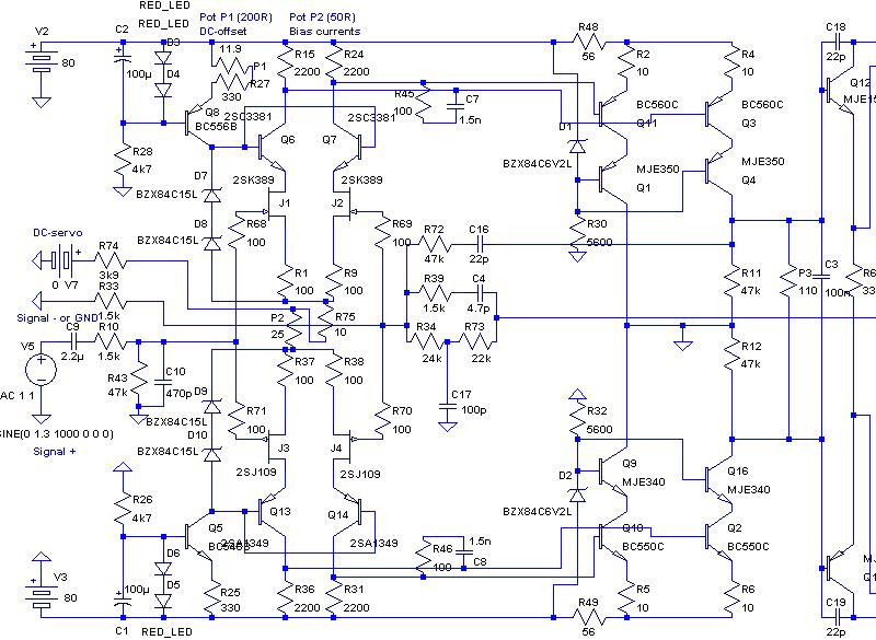

Hi all,
I implanted a pot (P1) in one of the current sources for the cascoding diodes of the diff pairs. With this I can trim the DC-offset to a minimum. Works great in sim.
For connecting the DC-servo, I would like to use the "midpoint" of both the diff pairs. In serie with a 3K9 resistor is the dc-servo connected.
The dc-servo circuit is here presented by "V7". If I set V7 at 13V --> the output offset is +-1.4Vdc. I think this is enough, not?? The opamp has to deliver then +-3.7mA.
What do think about this method? Please be critical.

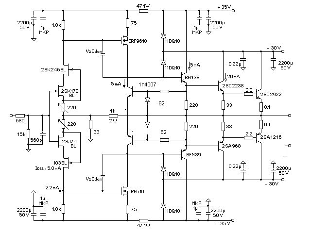

Upupa Epops said:And one important notice : rail voltage at VAS must " flow " on output's rail voltage, so all PSs must be connected at series...
Pavel,
Are you really sure that this is correct with my topology? When I hold the front stage (diff + VAS) at 82V, and lower the power supply voltage for the output FET's to 65V, THD stays +- the same in a simulation.
I would like to use a fixed voltage there, because my diff pairs aren't coupled with a CCS.

My mosfet amplifier with this topology have SNR ( ref to 1 V input ) more than 124 dB ( IHF - A ) and 120 dB ( linear ) - do you need more ? Distortion is around 0.001 %....
Only this topology give you perfect stability by clipping...but it is long talking....
