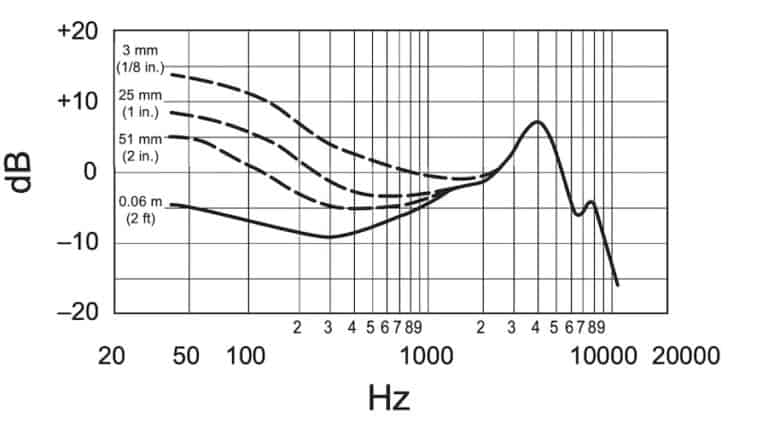

Have a look at this graph of a supercardioid mic with responses depending on distance:
You can equalize it, but only for a specific distance.

It doesn't need to be omni.
You don't understand the difference between a pressure mic and velocity microphone. Look it up for details.
A velocity microphone (everything but omni) changes it's frequency response when comming in the nearfield of a speaker. The closer, the more bass. And not a little - that's 20-30dB. Nearfield depends on the frequency - it's a mess all over.

And what happens with your measured THD when the mic has a 10dB boost? And don't reproduce >10kHz?
Using such a microphone and draw conclusions from the measurements ... is a mistake.
(until you have A LOT of knowledge about behaviour of microphones and that specific microphone. But then you would not use it first hand :cool: )
It should be ok as long as you just measure thd in percent and don't overload the mic.
Edit: @IamJF I stand corrected. See next post!
But the again I really don't know much about mics. Not as much as you probably know, that is.
The mic graph was really just an example for disrance-dependency - not recommended for measuring! :giggle:
You measure the THD components 10dB to high! With a boost at 3kHz you measure wrong H2 at 1,5kHz, wrong H3 at 1kHz, wrong H4 at ...
