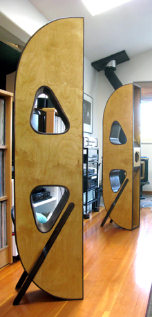

The pictures of Harvey’s in this thread are so beautiful. They certainly have a place in a great audio system with or without a subwoofer. I’m sure from bass to treble these sound great. Adding a subwoofer will improve the overall sound by adding more powerful, deeper bass. But if a sub is not an option, then these are an elegant way to enjoy music.
