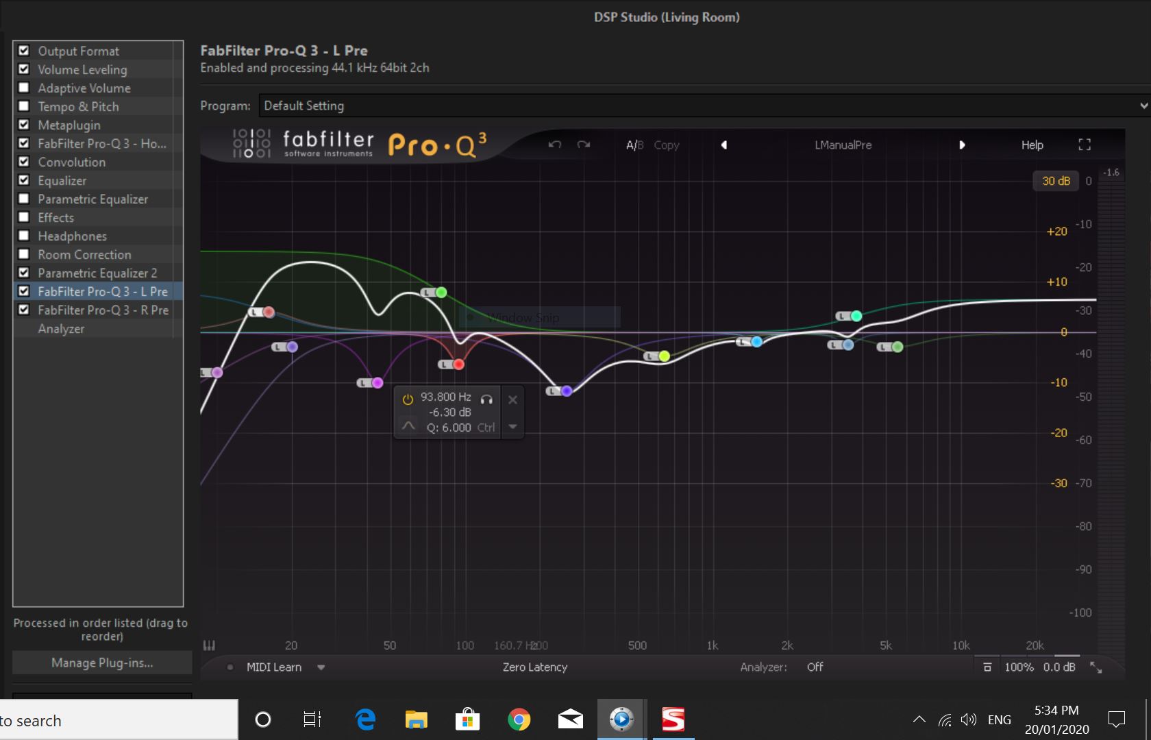

What I have done so far is:
* Measure L+R individually, to get them close to eachother.
* Measure L+R together, get them to sum better (this is where I am lacking a bit at the moment) Have looked to rePhase but not started actual work.
* Establish a flat response between 100hz - 5khz and applied that to miniDSP Output PEQ. Response is flattened by cutting the peaks.
* Then apply a couple of low shelf/high shelf filters on miniDSP Input PEQ to generate a desireable house curve, judged by ear.
This have provided a pretty decent base line

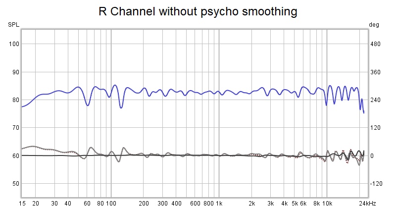

Only two pages ago I said I was going to leave things alone for a while, and the desire to tweak had been suppressed
This post is partly to outline something that others might find useful but also as a reminder to myself of what I did as it is quite complicated
Helping Halair make some FIR filters got me looking at REW and thinking....
I have been in two minds since trying greg's psycho filters out, in that there is something to like about them and be gained from them. Ultimately the old style longer windows won out and went back on general rotation.

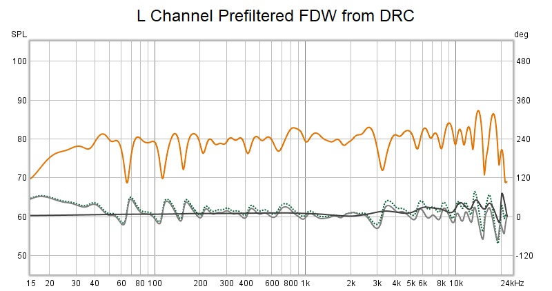

The longer window on the top end is used to help reconfigure the line from the arrival time differences of 25 drivers. Due to the impulse response inversion from DRC this is correcting for the combing pattern. That has bothered me and I know it is something that wesayso manually adjusts in his corrections. Replacing one comb with another doesn't make sense to me so I wanted to make a new filter where I didn't do that.

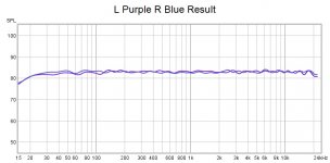

Prefiltered base measurement
Psycho smoothed prefiltered base measurement
I wanted to keep the excess phase correction but adjust the magnitude of the filter to the spectral envelope. I tried with rephase and an exported version of the excess phase but I soon realised I was in for a lot of work trying to manually set the filters to remove the excess phase.

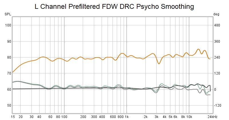

I remembered gmad's use of DRC to create an impulse version of a text file measurement. In short that uses a postfilter target which is the measured response you want and applies it to a Dirac pulse. That would allow me create an exact inverse filter for the excess phase. It was not quite as easy as it sounds as for some unknown reason DRC always outputs an odd rise to the high frequencies on a flat setting for me which translates into every filter it creates using this method too. My fix for that was to make a flat correction and create an inverse function in REW by using 1/A. Convolving that compensation with the generated filters gave me an exact copy of what I was aiming for Also DRC postfilter files can't have any text other than the measurement numbers, REW's comments and text must be removed. It seems to work better when there is a 0 line and a 22050 (half sample rate) line at the end. I just copied the values of the first and last measurement changing the frequency to 0 and 22050.

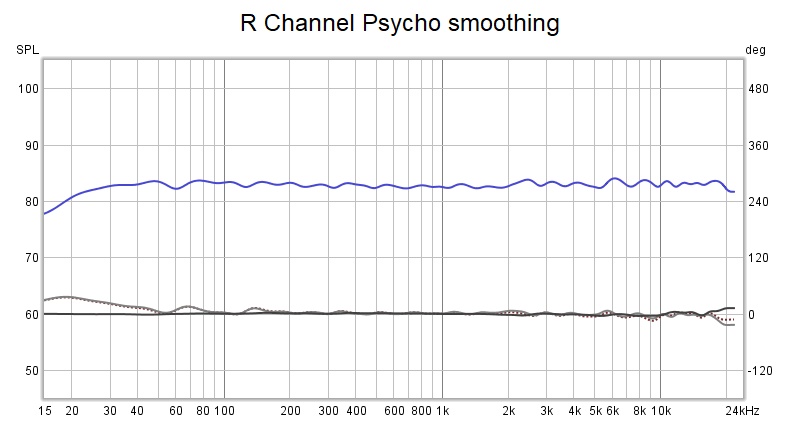

Armed with this trick I imported my DRC filter and applied psychoacoustic smoothing to it. That looked much less spiky. So I exported that as a measurement. Turned it into an impulse with DRC and compensated it back. I then convolved that with the original prefiltered version of the base measurement. That wasn't quite right so I used REW's auto EQ to bring it back to flatter overall. Add that EQ to the filter and your done. When viewed through psychoacoustic smoothing there is almost no excess phase as DRC did a pretty good job the first time.
This is the right channel filter convolved with the pre-filtered measurement and psycho smoothing applied.
This is the same with the psycho smoothing turned off. This gave me what I was aiming for which is a fairly flat spectral envelope without filling in all the dips.

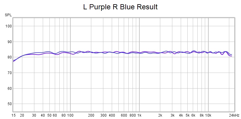

L R channel balance
I have tried it and it sounds different. There is more apparent clarity and resolution but tonal balance has shifted, so as usual when changing the goalposts it might take a while to find out if different is better. If I can keep the good and re-balance it might be

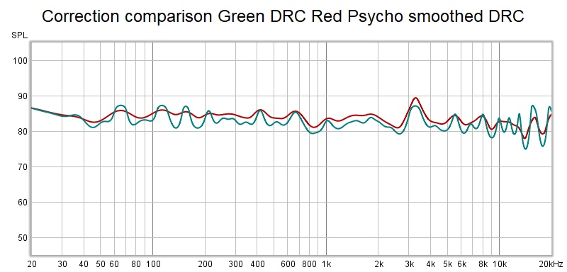

I'll try again I wanted to reduce the strength of the correction particularly in the high frequencies. Applying pyscho smoothing to the correction seemed to do the trick. I created that as a filter by exporting it to text including the smoothing and getting DRC to turn it into an impulse. As a check I convolved the new filter with a psycho smoothed version of the Output from the windowing DRC performs (PCOutFile) and applying some post EQ to make it flatter as seen in the previous graphs.Can't say these instructions were perfectly clear to me but I guess I see what you're doing.
This is the difference in the filters
The tonal balance has been set by ear in recent times and I haven't measured to see what the overall effect is.Did you try looking at a ~20 cycle FDW for setting the tonal balance? I found that to better represent the tonal balance I hear.
I will measure the in room difference between them and look at that through a 20 cycle FDW when I get a chance.
