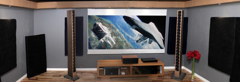

Pleasing the other half isn't really my issue, I don't want to waste time and effort to build something that won't fit well in the room these are likely to end up in long term. I also don't need to use any new materials as I will have to have them moved across the country when we move which is not going to be that far away in time (not in distance). I do have some spare fibreglass, felt, acrylic material and wood so I may use that in some fashion to make a poster panel

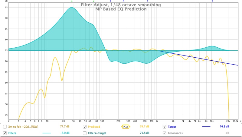

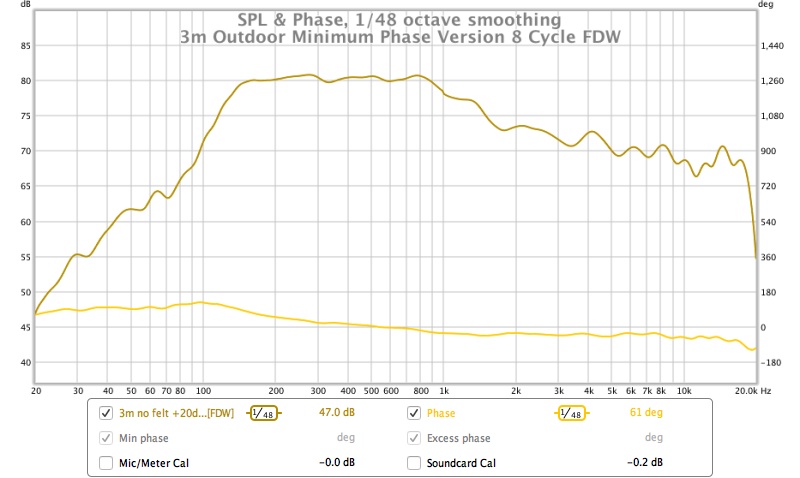

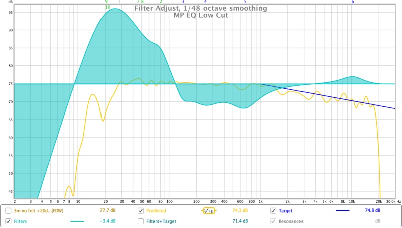

I was reading through the convolution thread today where gmad was talking about using a minimum phase version of a measurement with a 4 to 8 cycle FDW to base a speaker correction on.
I decided to test it out virtually in REW with an outdoor measurement without EQ to see what I would get.
A bit of gentle EQ (apart from the bass boost) and the result looks pretty good for only 6 PEQ's. I should probably add in some cut below 20Hz as the Q of the bass boost was broad. I think I will give this a listen when I get back and it might make a reasonable pre EQ as a base for DRC to clean it up a bit more. Still has that line array EQ look to it
I'd advise to bring the average EQ target down a bit (about 5 dB) to reduce the amount of boost needed. Basically get the EQ target more in the middle, more cut at 200-800 Hz, less boost at 30 Hz needed that way.

Just a comment on 26 dB boost at 20Hz vs 250 Hz:
Say 9volts at each driver at 30 Hz.
Then the poweramp needs 5x9V = 45V at 30Hz. About what a 400W amp can do.
So how much is delivered at for each driver at 250 Hz?
26 db is 20 times amplified. So 9 volts at 30Hz and 9V/20 = 0.5V at 250Hz
Total 2.5 Volts. So 1 watt. One driver needs about 0.05Watts at 250Hz.
So with 26dB gain, 9 volts at 30Hz is not unrealistic?

The above EQ example is based on a free standing outside measurement. In a room we would need (slightly) less boost at low frequencies.
To stay within x-max of the TC9 a theoretical (simmed) maximum of about 240 watt is needed at 30 Hz. Real world level would depend on placement within the room.
Agreed, my method for that is to apply -5dB attenuation (or whatever amount is desired) at the input Either way gets you to the same point.
I picked that target level because it made the EQ simpler.
If I use the Najda I need to run practical tests to check for headroom and adjust accordingly. With the rough EQ I had 24dB of boost in the filters but -12 dB input attenuation to avoid clipping
Jriver might be different as I think it has more digital headroom.

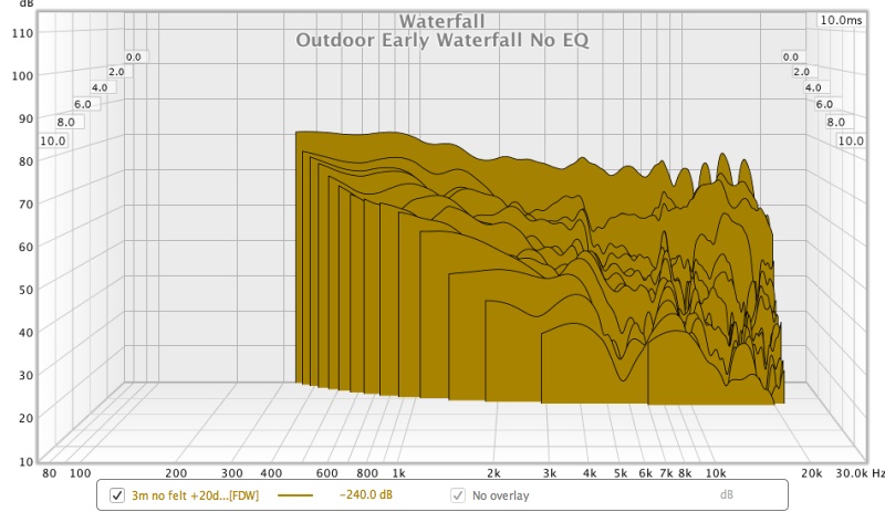

Hi fluid as far as i know waterfall plot don't care and react to setting any FDW so must be based on raw IR but it has its own presenting possibility in setting smoothing numbers within 1/3-1/48. Think some of wesayso's points is its easy to EQ first ridge smooth and flat to whatever target one prefer, problem is next ridges will start show resonances that get much worse than before EQ correction if EQ is based on any interference/reflections. When EQ is based on windowed measurements and those windows settings are optimized for actual in situation not only into windowed curves things start look good but also raw windows start to look good including waterfall.
