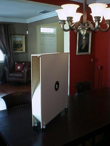

Why are u only lookig at 3-5" drivers? my reason is a limited box volume which is 12 liters (that I might have to strech to 14).
why 4"
thanks. in answer to your question(s) the reason i want a smaller driver is, in my experience the larger the driver in a full range system, the more the "beaming" effect in the high frequencies. phase plugs and whizzers only marginally seem to help. I find that hard on the ears and unpleasant. the effect seems to be lessened with the smaller drivers such that i have found the 3" tangband i previously mentioned to have the best overall sound w/o excessive full range "shout". but i have not tried very many of the available drivers, instead trying to focus on finding the most sensitive full range driver i can. i might try a pair of the moth cicada, which i believe is more efficient than the fostex/tangband/audax full range?
as far as why, i want a horn loaded full range with high efficiency for my nOrh se9 single ended amp that cranks 9 wpc.
BUT my wife will butcher me and feed me in small pieces to our cat if i were to construct the usual massive horn loaded cabinet.:smash:
so i have constructed a flat horn based on similar designs i've seen on the web.... was very difficult for me to construct but it is compact.. can hang on the wall. And as previously noted the 3"tangbands sound the best so far (with sub). The horns really work as hoped and the sound is very full and "horny" with the tube amp yet smooth and very detailed w/o muddiness. i prefer it to the sound of my reference B&W dm110. BUT for higher volume levels i really need a more sensitive small full range driver.
hope that explains things a little better... see pic of almost finished speaker

hi joe
joe thanks for your comments. I have been conceptualizing how to incorporate a horn without displacing any living space; the ever important WAF to be considered. I have drawn up some plans for placement of horns inside the walls and may well do that. I also drew up some plans for a "flat"speaker, but with the speaker on the edge rather than the middle. When i saw the cornu horn i thought i could do something like that.
the cornu horn is larger and also has 4 horns. mine is only 24" square 4" deep and only has one horn. the other difference from the cornu horn is that in my case the speaker sits in a damped chamber that is attached to the horn. the german fellow's speaker feeds directly into the 4 horns which i think must limit the bass output.
but what do i know? I am very happy with the sound i am getting, NOW I UNDERSTAND this whole low power/horn speaker thing. It is a whole different ball game!
i also like the reaction i am getting when people see the diminutive 3" speaker and then hear the BIG horn sound. to most people used to big woofers and big boxes it does not seem possible.

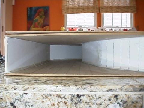

audiotang-
Do you mind explaining some of how you built the horn. How did you bend the wood and then attatch it to the front and back? I can understand bending the wood, but I don't know how you would bend the wood and get it to hold the exact curve you want while attatching the front and back, being unable to see/adjust the wood adding the second side.
just curious
Joe

joseph: i am not adept at woodworking and don't have the tools. the cornu spiral is simply too complex and i wanted a simpler approach. So after drawing out the single spiral i used museum board for the channels. I cut large strips 4" wide. In order to make it curve i cut vertical slits 1" apart and the board then bent to the shape i wanted. i affixed the shaped museum board to one panel with the strongest adhesive caulking i could find and let it set. I then slathered a generous amount of the adhesive onto the top of the exposed horn wall, placed the other panel on it under weight and let it set. It is light and rigid and can easily hang on the wall. i cut a large enough hole to accomodate a 5.25" speaker and I simply clip on another panel with a different speaker to try out and by this method determined that i liked the tangbands the best.
of course museum matt board is just foam with cardboard on both sides and i realize it is not the ideal substance but i was able to seal it completely tight. And I padded one side of the spiral with insulation. it is well damped.
i'll attach a pic looking down the mouth of the horn during construction and you should be able to see how the curve was formed.

Thanks for the construction info
Joe
