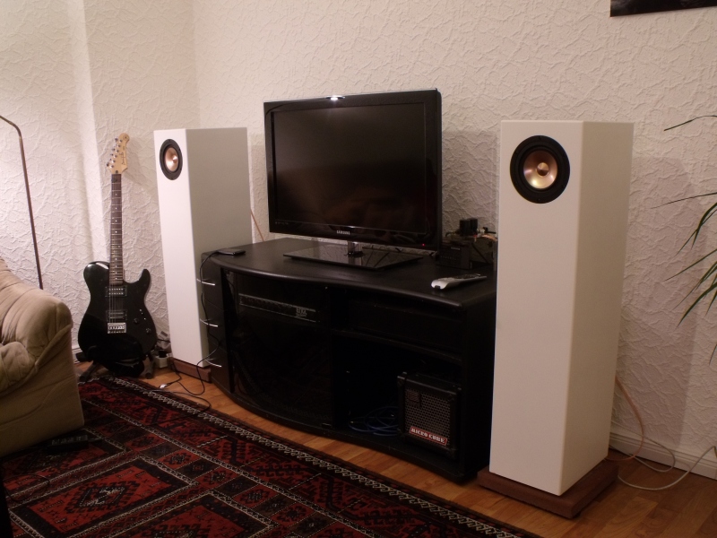

Hi all
Made my first incursion into FR world with a pair of pensil p70's.
I've been so engrossed with the listening that I've had little time to post the results. They are absolutely amazing!
I used solid Sucupira wood, cut up into 5cm strips and glued together in reverse order to avoid warping, something like the 'butcher block' concept, except done from scratch. I guess it's like buying fillet and asking the butcher to mince it, but I wanted great quality, and don't regret the cost one bit.
Anyway, enough chatter. Here are the pictures.
rather easier to draw than to fabricate - the rabbeting is particularly fiddly
what the photos don't show and what took rather a bit of bother is the perimeter wrap grain matching
This hobby has taught me a few things, such as; cutting wood straight and getting it all to line up is a lot easier said than done, good wood is expensive and it's definitely given me a whole new appreciation for when it's done right. :)
Very nice work.

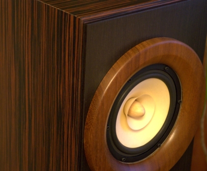

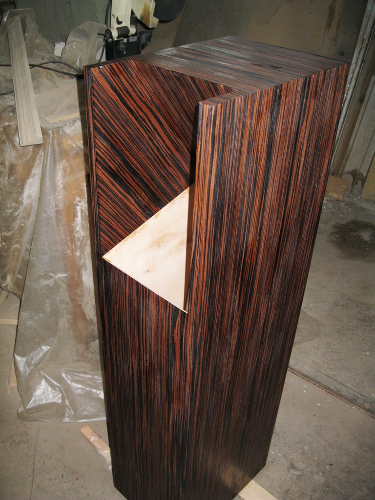

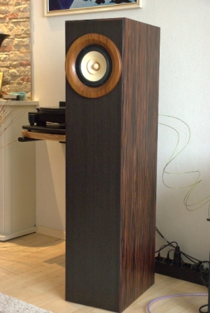

BLH on Sonodo SFR175-8
My new BLH on Sonido FR-driver SFR175-8.
50 Hz -2dB
Dimensions: 1250x280x400 mm
Material: birch plywood with eben macasar veneer.
Weight: 32 kg

That looks excellent. I must ask, is that veneer the natural colour of the wood or did you stain/dye it to get that beautiful colour?
It is the veneer called "fine line" from China (like most things in the world:)). It is natural wood not vinyl but not from the natural eben macasar only imitation from chip wood. The surface is lacquered with 2-componets transparent varnish.
The front panel ist also eben macasar but black. The wooden surround is from mahogany
Looks very similar to material marketed in North America by Brookside Veneers. (Quartered Macassar Ebony in this case) Brookside Veneers Exotic Veneers Wood Veneer Wood Veneers They distribute a wide range of exotic and FSC certified natural veneers, as well as composites from plantation grown species (Aspen, I think), and through considerable manipulation and dyeing, made to emulate a wide range of exotic species. Not inexpensive
