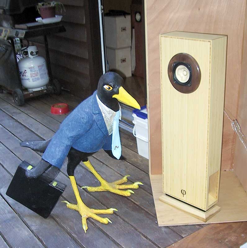

For those thing, "What are the H they talkin' about?"
Meet the lawyer.

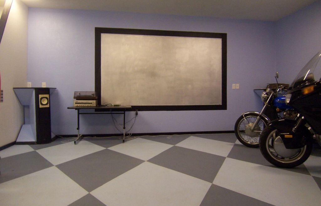

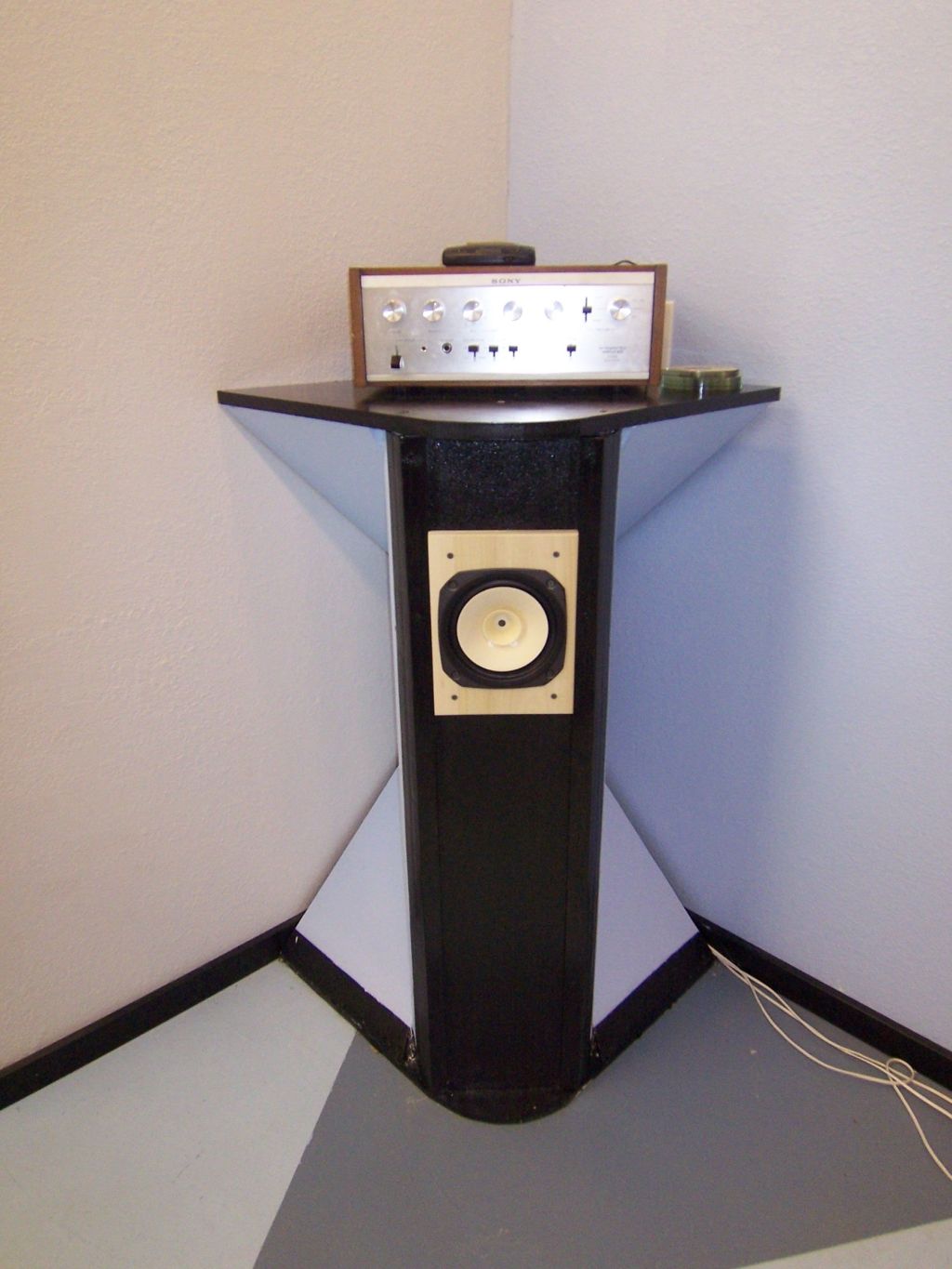

Dec Ware Corner Horns
I recently completed a remodel of my motorcycle garage and finally had two empty corners in which to place corner horn speakers. So, I built a set of Dec Ware Corner Horns.
I do not believe that many of these have been built and there is little information on the Internet concerning their performance, so I thought that I should contribute a bit.
Fostex FE 166EN drivers were used. The cabinets are made from 3/4 inch MDF and since they are in a garage, they were painted to match the walls and trim.
I will provide a performance review and construction comments in the Full Range forum.
Dennis

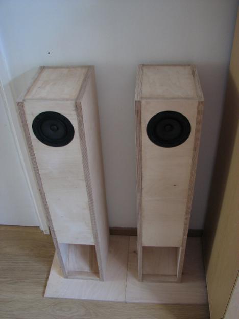

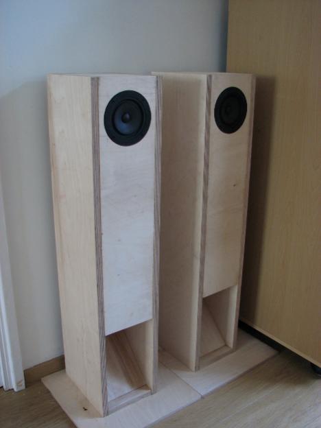

I'm new here, so I thought I say introduce myself by showing my first, really humble project - a pair of pc speakers with frs8 based on this design (text is in german but plans are pretty self-explanatory) but tuned a little higher:
PC Lautsprecher Projekt - Visaton Diskussionsforum
I built these to find out if I'm able to build enclosures. Since I didn't want to spend too much money built these from scraps of birch ply I got at a local home improvement store - one is mostly 15mm and the other one mostly 18mm - so they are far from perfect but I learned a lot, for example to avoid different thickness material in one box.(of cause I kept the internal dimensions)
They are build using hand tools only, was fun, but I'm not sure if I'll do it without a circular saw again.
But I'm really amazed how they sound, I would have never thought a pair of speakers for 35 Euros could be soo nice.
Now I'm pretty hooked on the idea of building a pair of bigger full range speakers and some frs8 speakers to give to a friend (maybe I should better start a thread on this plan).

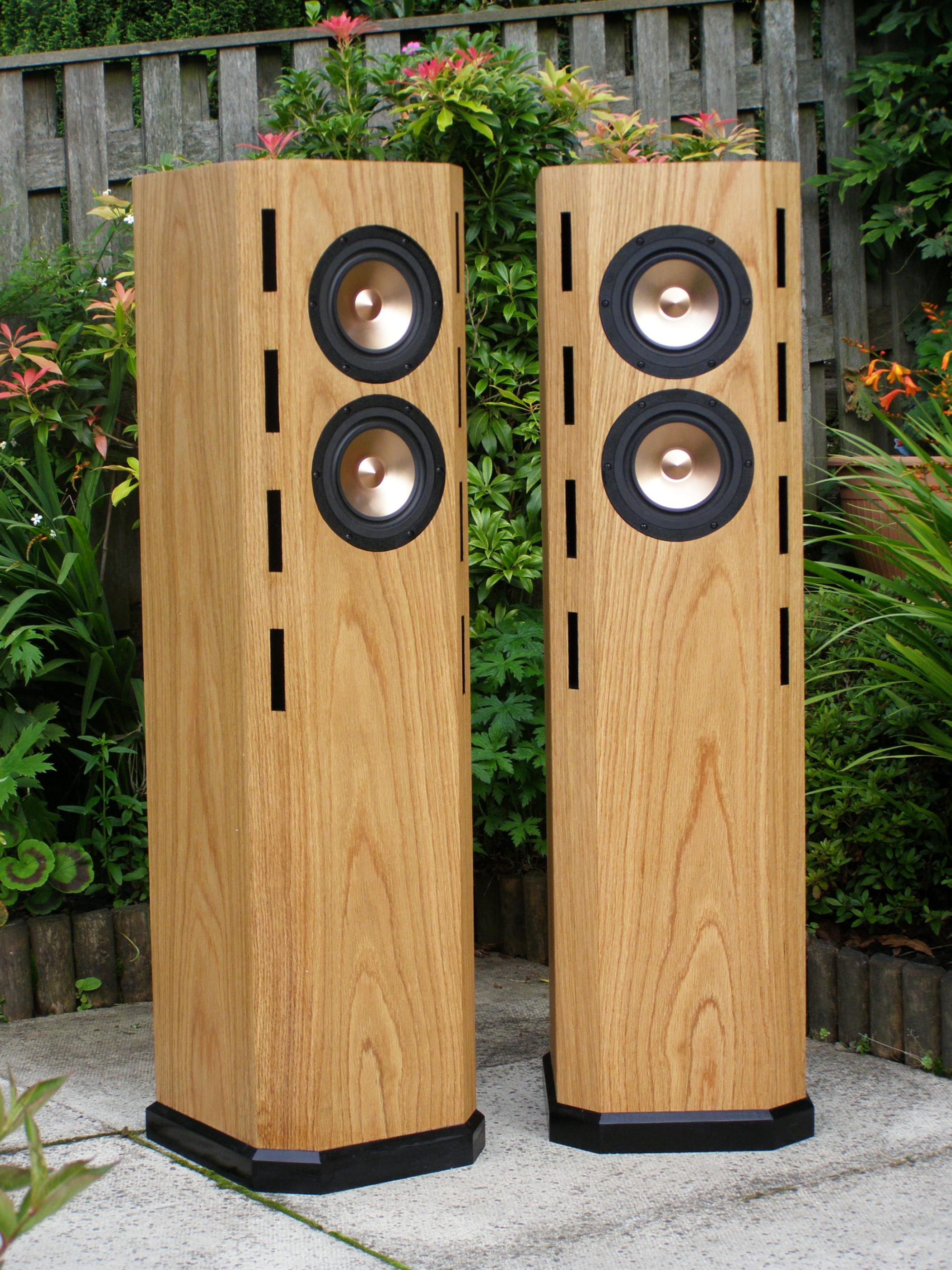

Thought I'd share my latest build.
My Son and his grilfriend have just moved into a apartment and set up house together so he needed a new pair of speakers. As he has most (if not all) his music stored on his Mac I needed a speaker more suited to SS amplification and decided as I had 2-pr the MA A10 driver going spare a nice Fonken-Style floorstander type cabinet would be ideal. This driver suits better the type of music my Son listens to over the Fostex FE167eN that was my second choice driver.
So after talking with DaveD (Planet10) they are based on 2 Mar-Kel10, stacked and merged into a single volume. Adjusted the spacing of the slots, and merged some together (merging the 6 slots/side into 4 slots). Stuck onto a false base. They are skinned in Oak veneer.
I must say they sound really good indeed with powerful solid bass and good transiant attack. Not sure if DaveD will be featuring this design as part of his Plans offerings. We'll have to wait and see but they are that good I'm loathe to part with them this coming weekend.
