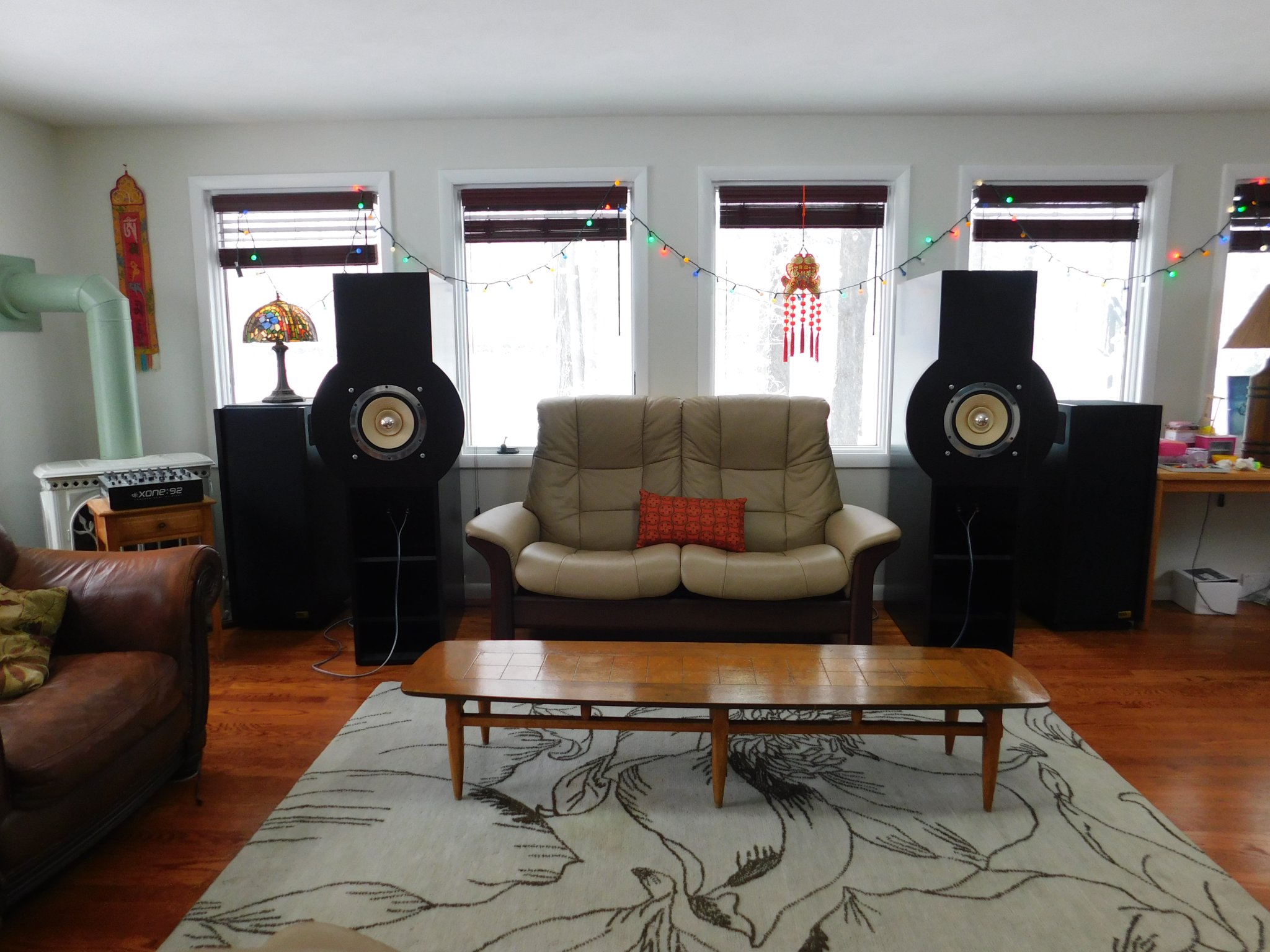

Yes my F120A in dave's Fonkensteen, unspeakably elegant bass, really I have no words to describe the tone, maybe effervescent/esprit/journeying. In comparison my TLonkens are extremely compact, deeper and more powerful.As a generalization a slot vent will trade initial rool-off and ultimte depth for a bit more elegant bass and less going in and out of tune with the dynamic changes in T?S parameters.
We used it on our big MTMs using Scott’s A12pw ML-TL and the ML-TL for the W14 in Tysen V2.

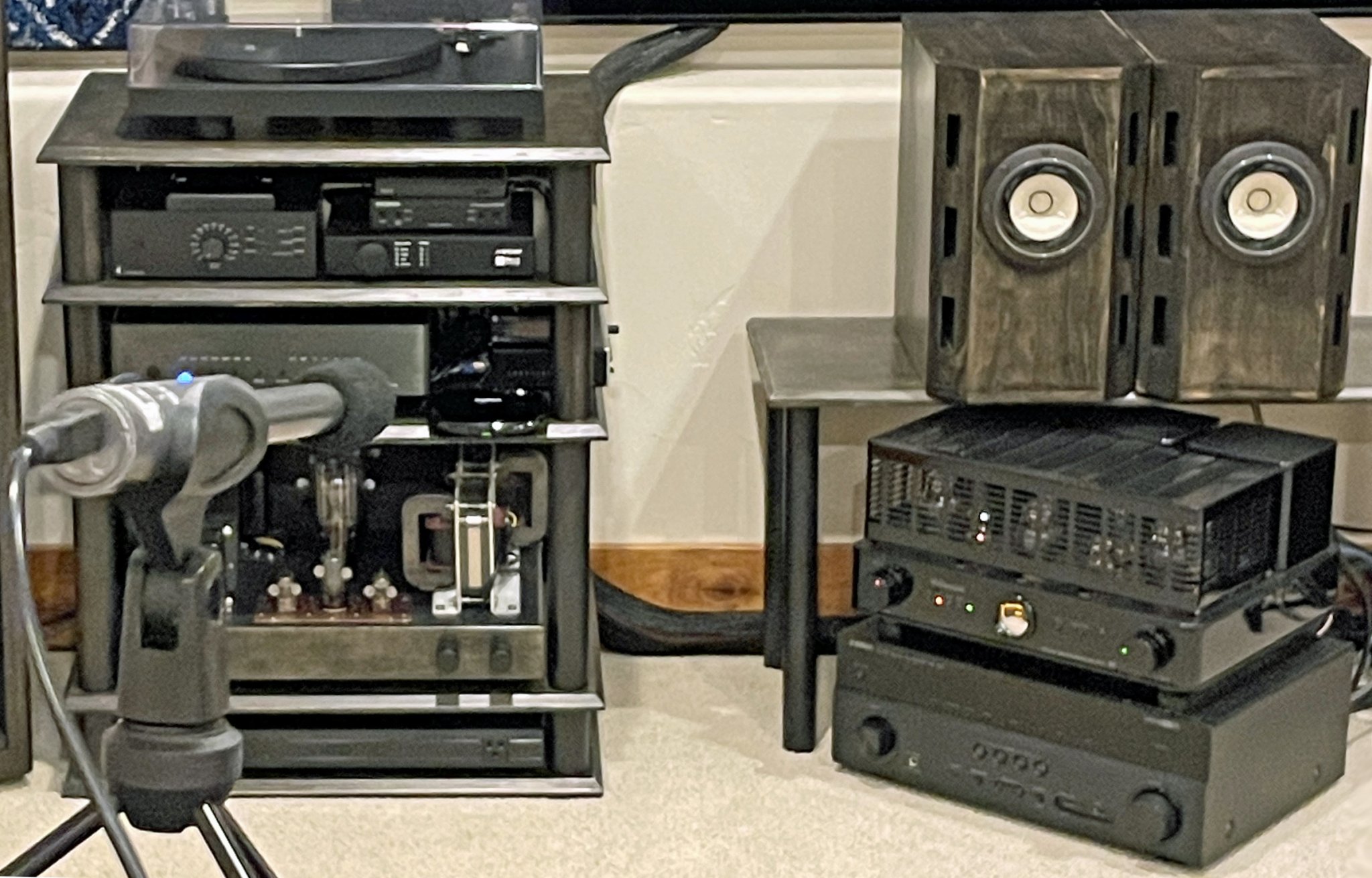

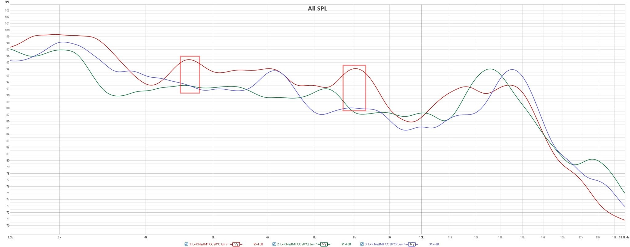

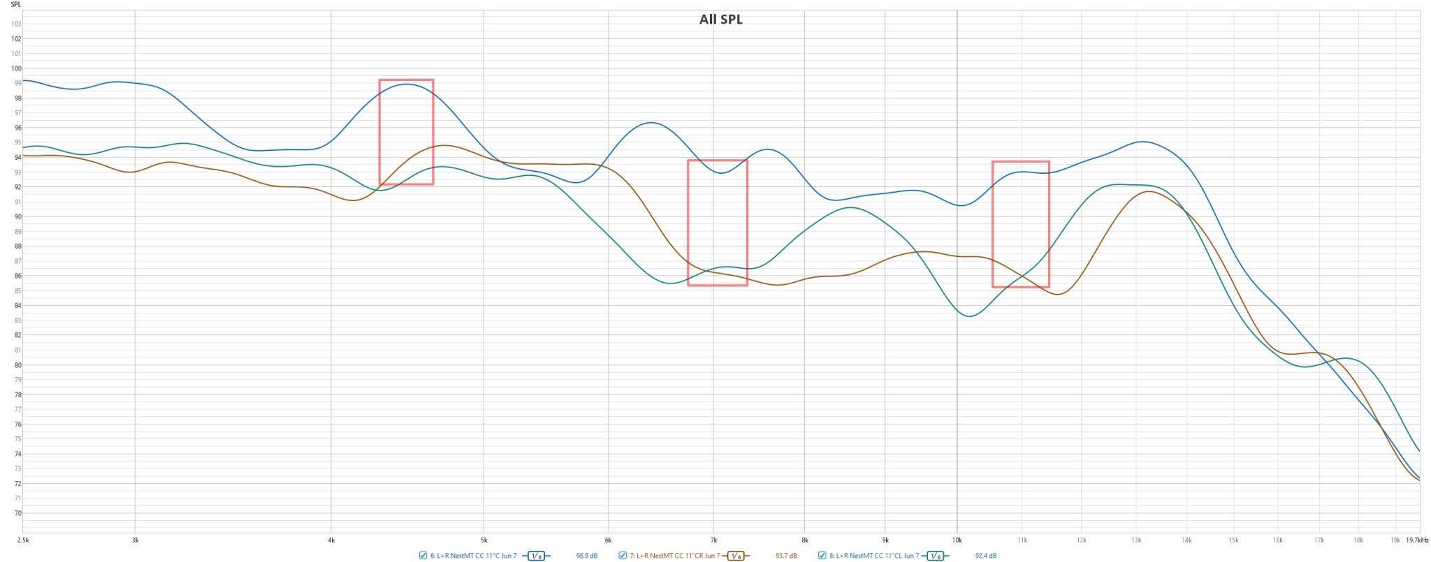

I looked more carefully at lobing interference from the dual Onken (Fostex FE108EΣ) center channel in the NestMT. Lobing interference "always" happens in home audio but how significant is it? Driving two full range or mid-high drivers, separated at all, with the same signal will cause destructive lobing, and so will reflections from walls, etc.. The NestMT has 3 primary seats L, C, R at about 8' from the CC, and I measured and listened in all three, as well as other locations, with different distances between the dual Onken drivers of 20", 11" and 9". There's plenty more background and detail in my blog HERE but basically I found 3-6 dB of destructive lobing at ~4.5Hz and ~8KHz... to me it is barely audible, especially when driving all 9 full range drivers in the music theater. The top sweep in each graph is "on-axis" (always excellent) and the lower two are left & right seats by ~4ft abreast.
dave: Stand up, sit down. Move side to side, forward & backward will not likely be an issue until you get close.Does anyone know from listening tests what influence of lobing has in practice?

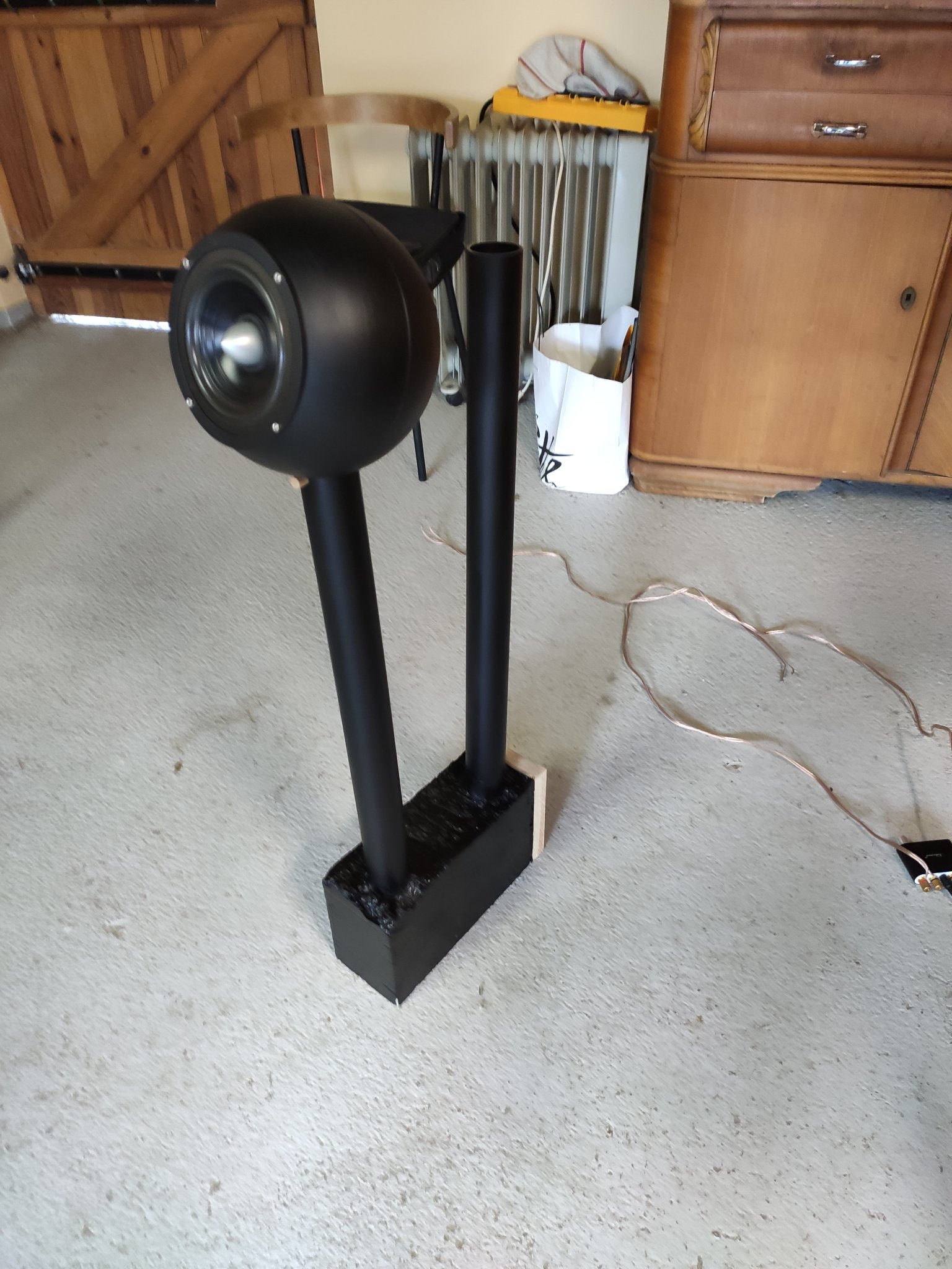

I've had a chance to mess around with them, I thought that they were over stuffed, so I took all the stuffing out, but it was boxy, so I put a little back in now the bass drivers have had a chance to loosen up, I think they could do with a little more stuffing.
Using a graphic equaliser, I found a bit of a hump around the crossover point, so I tried a larger value inductor (now I'm glad that I didn't permanently mount the original chokes) and not only has it cured the hump, but they sound far more musical. I'm really happy with them, they sound very transparent and natural, and they really do sonically disappear, even without any steps taken to deal with the edge diffraction.
