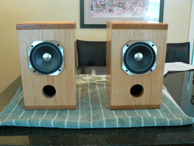

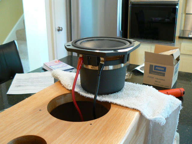

My Fostex F120A Project
Finally finished my Fostex F120A project, Now they just need to break in. So far they sound promising. They are made with 1" thick solid hickory. They have 3 coats of Tung oil and 10 coats of rub-on-polly. I am using a diffuser behind the speaker to deflect waves hitting the back of the cone. They are power hungry as heck right now. Fortunately I have the power right now but I built them for use with SET amps. I am hoping after they break in they will get more sensitive.

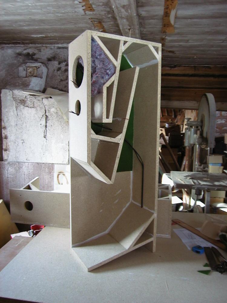

Hello. My biggest build so far. I got a lovely pair of Coral Flat 8 II and thought a construction called AoE Horns in a Swedish HiFi magazin promising. It was constructed around McFarlow 8" and a tweater both nowaday obsolete. Calculations gave smaller changes. I first tryed with only Corals but didn´t like the upper end and very hard sweet spots. A Sonab tweater and 3´rd degree cut at 8000 (just for try something). The result was awesome. They are now my reference in other builds around BL horns. They should have a better filter because there is a lack in center image around the cut but my mind is still focused on newer projects. Another area of improvement is building with 24 mm ply instead of my 19 mm board since small resonans problems exist.
Kind regards
To hot for starting. Couldn´t wait for better material and to stubborn to learn of mistakes. Yes your right that 19 mm ply is sufficient but then probably with stabilisation ribs somewere in mouth. I think a large horn are very sensitive for standing waves across the side panels in that area. When feeling with the hand you notice serious vibrations even on hard board like ply. Harder material is in my schoolbook with higher freqvency but lower amplitude. You know what you have but not what you get. Am i right? Perhapes the mouth isn´t as sensitive for colorization as earlier parts in the horn though.
