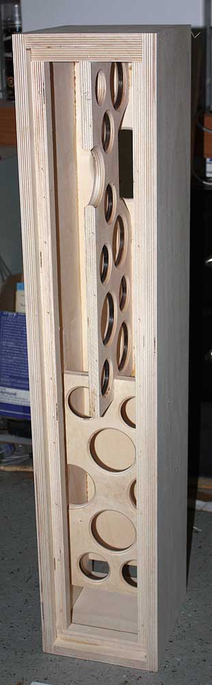

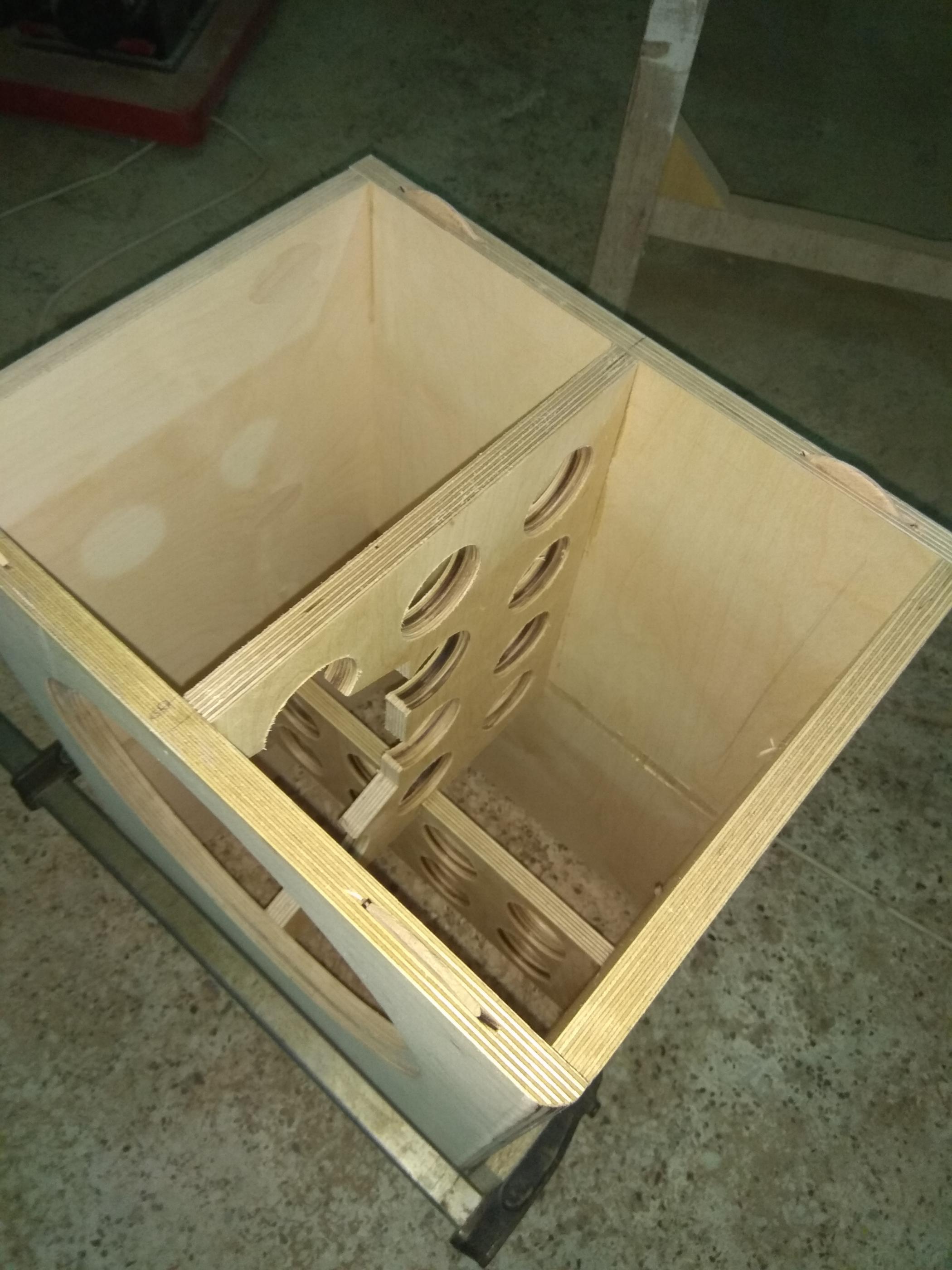

Typically, pushing the potential panel resonances up in freuency (with braces) where they are much harder to excite is a good thing. But it can go wrong, and i have seen many boxes not optimally braced… in particular you often see this guideline broken:
The aspect ratio of the subpanels defined by the brace should be higher than the aspect ratio of the panel being subdivided — and the ratios should be different (ie off centre brace).

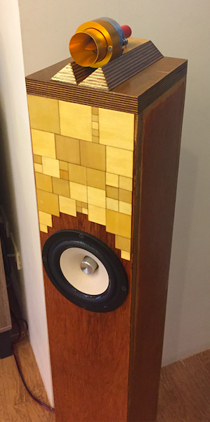

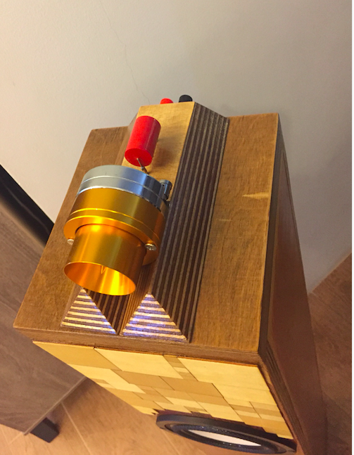

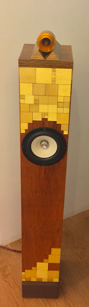

Just finished up my first pair of DIY speakers. After lots of searching I decided on Dayton RS100 4 ohm drivers mounted in Cyburg Needle (folded Voigt pipe) type cabinets. Instead of using MDF i went with BB/BB Baltic Birch plywood for strength, durability, and i wanted to attempt applying a decent looking finish to it without having to veneer the cabinet.
Very nice work Andrew. Please post pics of the measurements.
...since the communists banned denatured alcohol in California... like they already did with Naptha, Mineral Spirits, MEK, Benzine, and pretty much every other solvent except Acetone...
I'm pretty sure you can still get denatured alcohol, mineral spirits and naptha. I currently have these on hand but it's been a while since I bought any, so who knows...
Nice job on your project! :up:

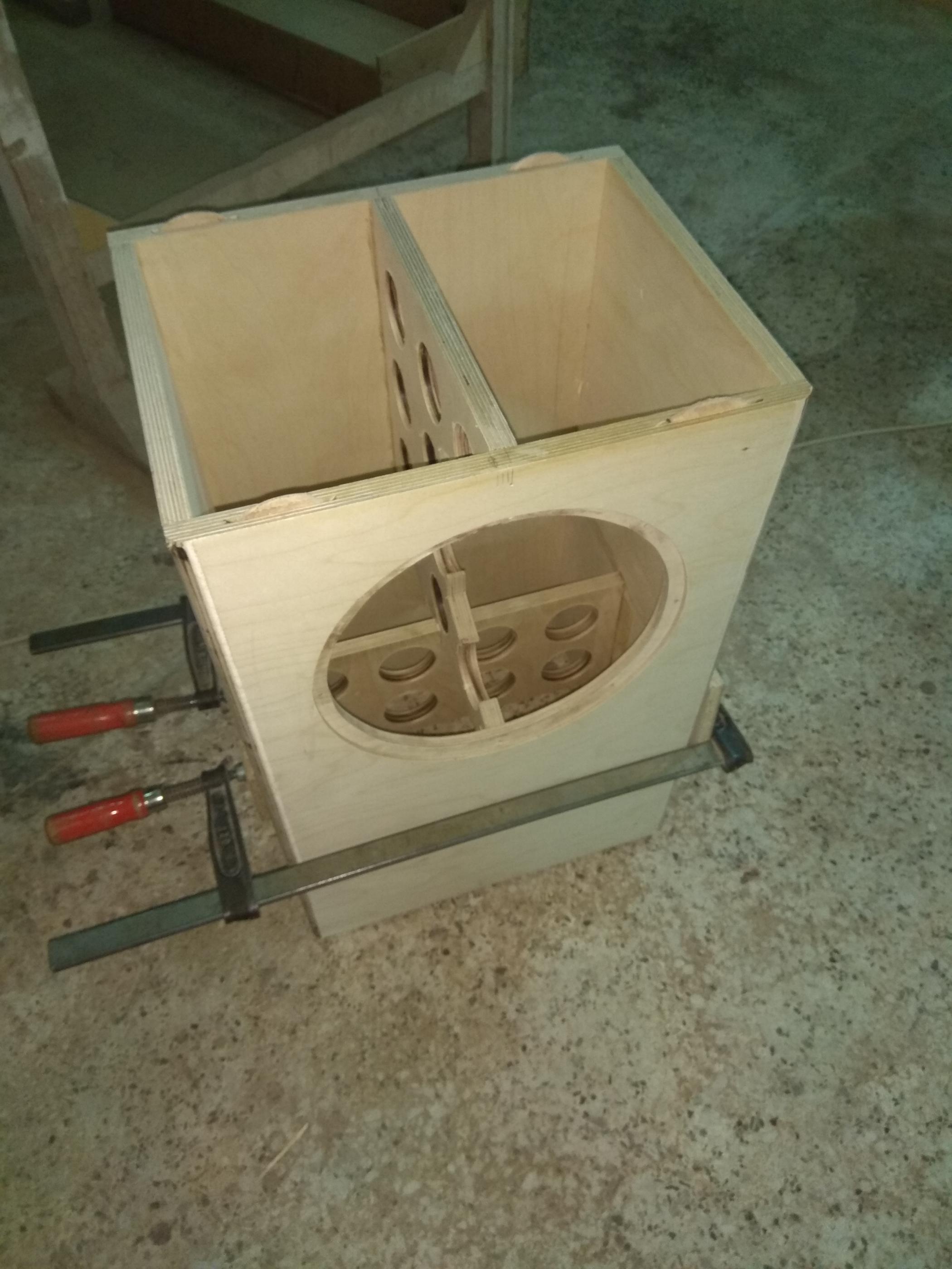

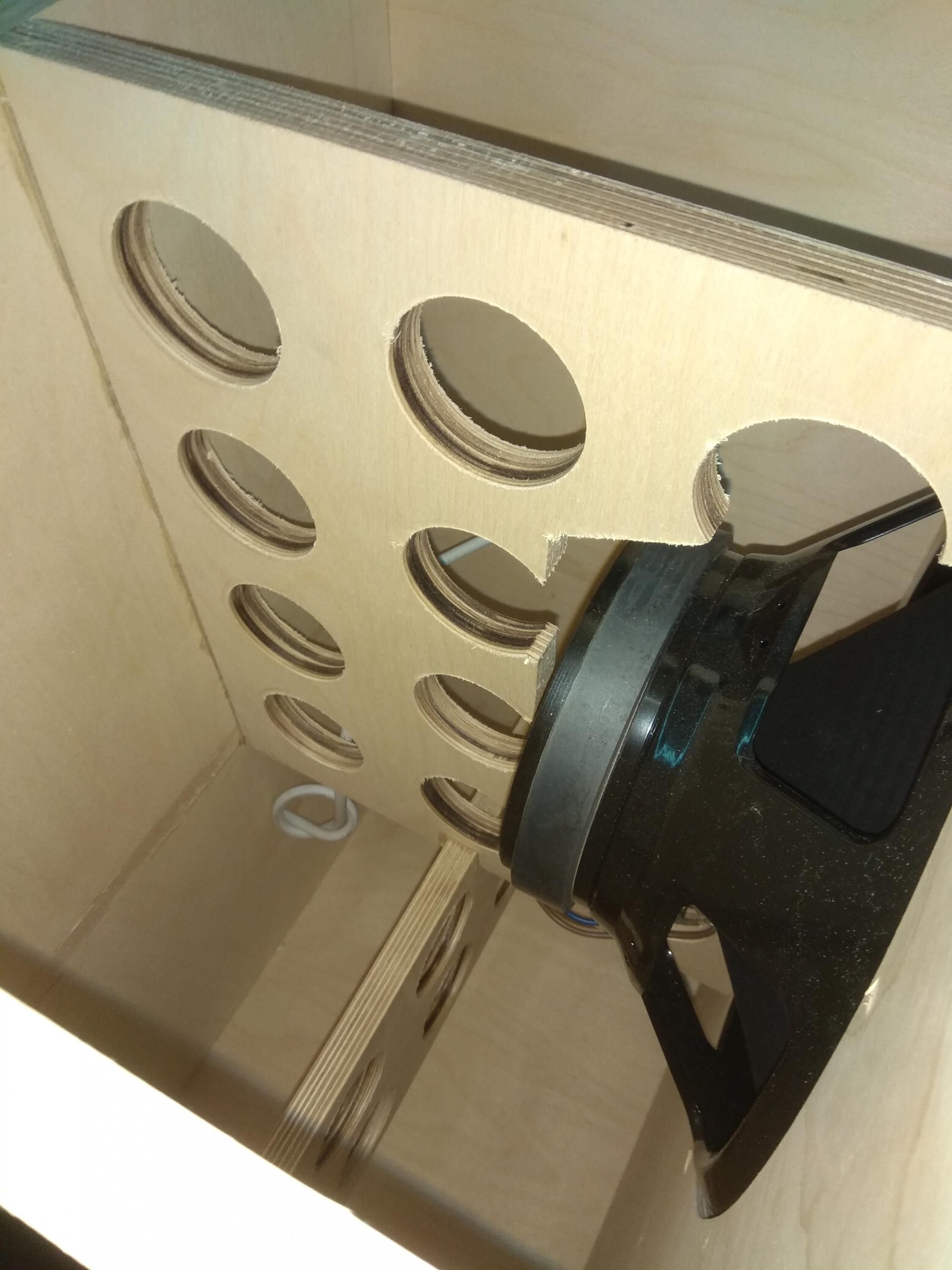

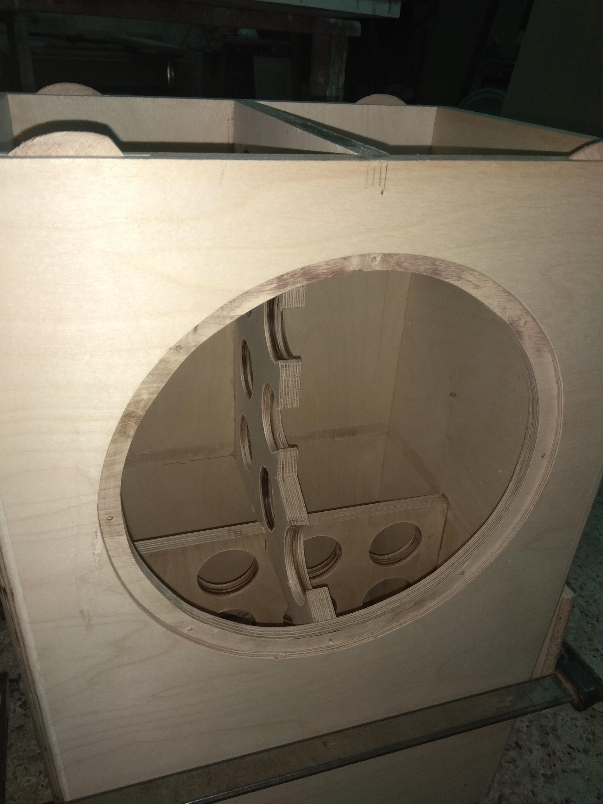

Dimensions are.
66×39.5×30.5cm Bracing place is at 28cm from the bottom.
12 holes each 60mm.
All materials are 18mm Plywood.
frugal-phile™
Joined 2001
The brace should run vertically (in the 60cm dimension) so as to have subpanels with higher aspect ratio than the original). I usually make the brace so that it braces the speaker driver agent the back (&top & bottom) of the cabinet.
You might also consider some side-to-side braces. Ideally a brace every 100-150 cm, but usually not practical.
As long as % holes is holey it matters little how you do that.
dave

Now with a different Bracing arraignment.
According to dave photo.:)
